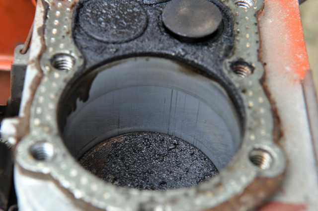

Nothing appears to be broken but there is certainly some buildup.
It looks slightly oily, but that is to be expected since it has been inhaling oil recently. It does not appear to have been inhaling much oil, just a whiff of it. That amount of carbon is quite minor - on the low side for such an old engine. The piston crown seems in good condition. The next potential problem to check is the piston rings, but they seldom fail suddenly. I suggest you rotate the engine so the piston is at the bottom of the stroke, and look at the cylinder bore. It can be in excellent shape if the rings are just worn out, but will probably show signs of scoring if the rings are broken. We need to find out as much as we can before considering taking the piston out to look at the rings, because that is a bit harder.

No signs of markings inside the bore, the markes you can see in the photo are oil streaks.
There are two ways we can go now: just assume the rings are shot, and take out the piston; or put the cylinder head back on temporarily and test the ring leakage. You don't need to put the air cowl back on, we won't be starting the engine.
The test consists of pulling the starter cord and memorising what it felt like, then squirting some engine oil in through the spark plug hole, putting the spark plug back in, and pulling the starter cord again. If it suddenly has a lot more compression after you squirt in the oil, it was leaking air past the rings when you did it without the oil. If it leaks, the oil will find its way into the sump before long, so you can repeat the with-and-without oil tests as often as you want. Don't put a huge amount of oil in, or you'll simply fill the combustion chamber with oil, which raises the compression ratio and makes it feel as if it was leaking when you didn't put in the oil.
Because your symptoms are a bit odd, I recommend putting the head back on and doing the oil test. It can ruin your day if you take the piston out and discover the rings are better than new.

Ok test completed, and the results are as you explained, it suddenly has a lot more compression after I put in the oil.
That is a relief: it means there is definitely leakage past the rings, and the piston has to come out - no risk of unnecessary dismantling. That requires removing the engine from the mower. The most difficult part of that is freeing the drive shaft, by sliding the clutch along the shaft toward the chain-case on the left side of the mower. The right (engine) side of the clutch is usually held by a captive clamping bolt, which just needs to be loosened, and can't be removed anyway because it's captive. The retention of the left (chain-case) side of the clutch is obvious and less tricky, though at this moment I don't recall what kind of screw/bolt it is. You'll need to disconnect the speed control cable at the engine end. The engine is held down by four bolts, which are easily visible.
