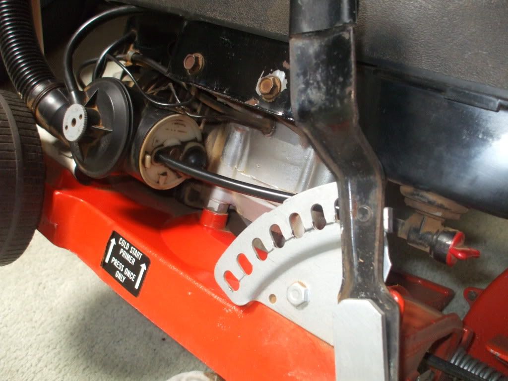

My lack of tech experience means I am back again. This time I have uploaded a photo which I didn't realise earlier that I could do.
As hopefully you can see I only have one brass rod tipped wire - the only other wire has the eyelet connection that bolts to the engine casing. Also I can't see any holes under the filter hose. Could you give me more exact location.
Turning to hoses - you can see that currently the hose from what I take to be the decompressor is connected to the carby diaphram cover. I'm pretty sure I haven't mixed up the hoses so could I ask you to let me know if that is correct.
I have marked with black tape the vacuum tube hose that emerges from the cowling. You can also see the broken white plastic pipe in the carby body. I don't think it is possible to attach anything so I am wondering if it is possible to drill out the buried bit and fit a replacement.
tilta cut 80
Hi young, I also have a Series 80 engined Victa T-A-Cut, so I have had a look, and here is where it appears everything goes.
(1) the tubing from the fuel tank goes to the carby diaphragm cover.
(2) the tubing with the black tape (from the de-compressor) goes to where the white broken piece is. (you could drill it out carefully and find a small piece of hard tubing to fit)
(3) the wire with the eyelet fitted goes under the first cowl attachment bolt (near where the fuel tank lead is in your pic)
(4) the black wire with the brass rod on the tip, geos into the left hand side (yes there is a hole) of the rubber grommet above the air-cleaner snorkel hose. wink
Hoping this helps, best of luck with it,

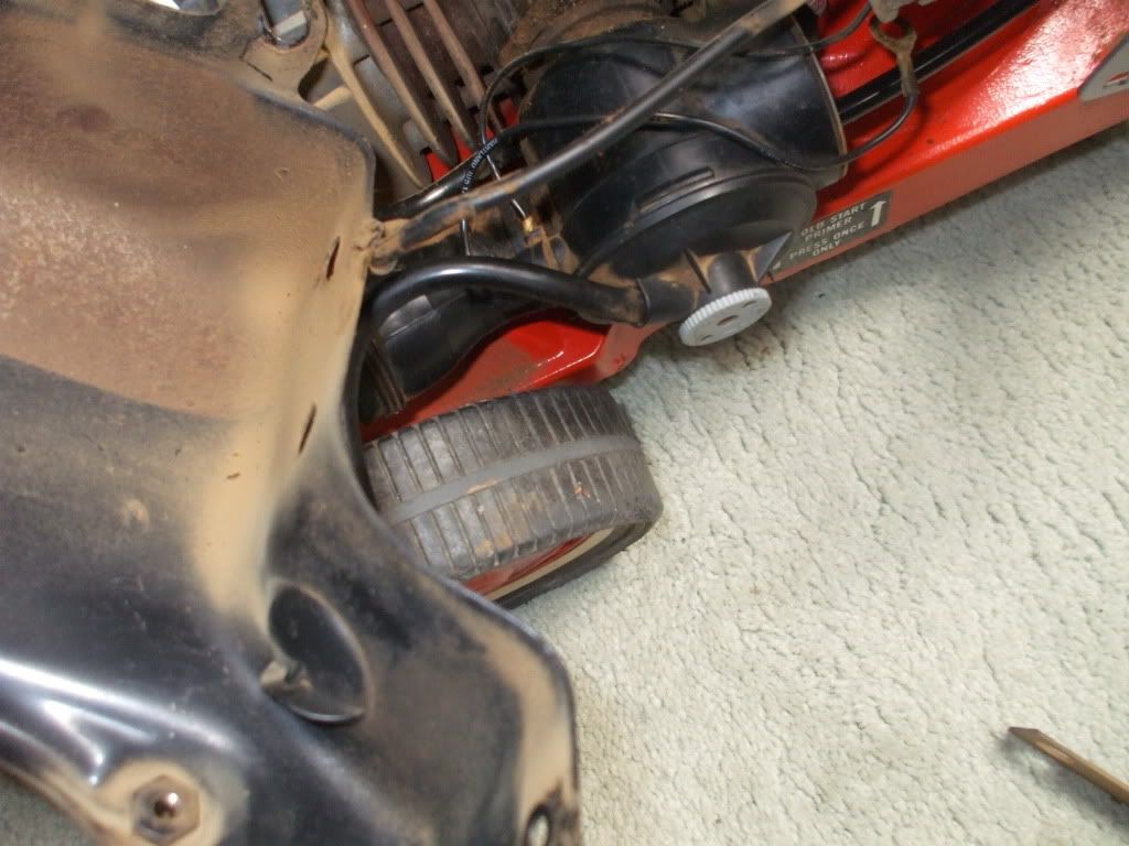

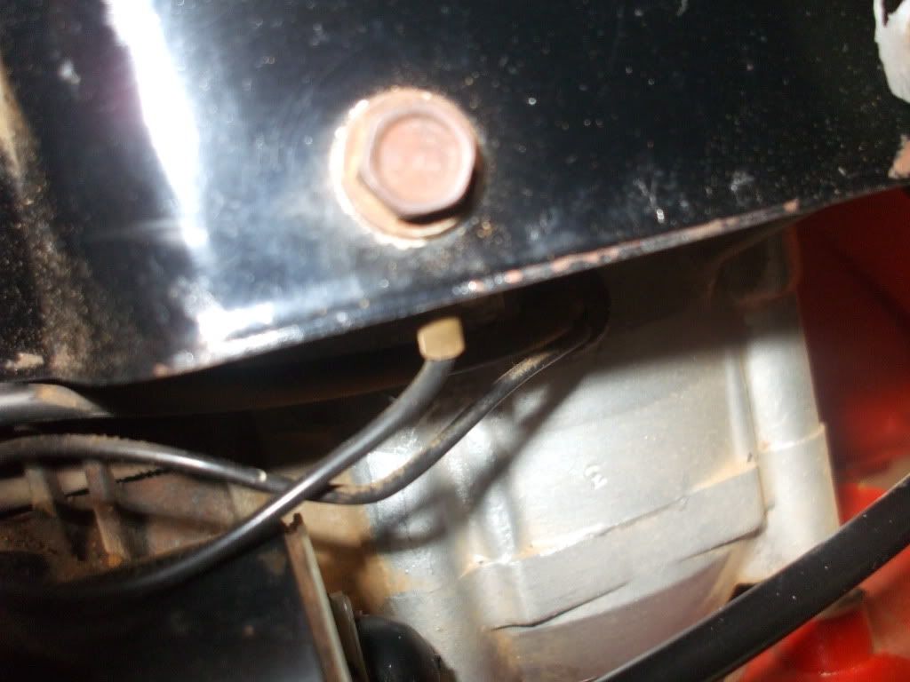

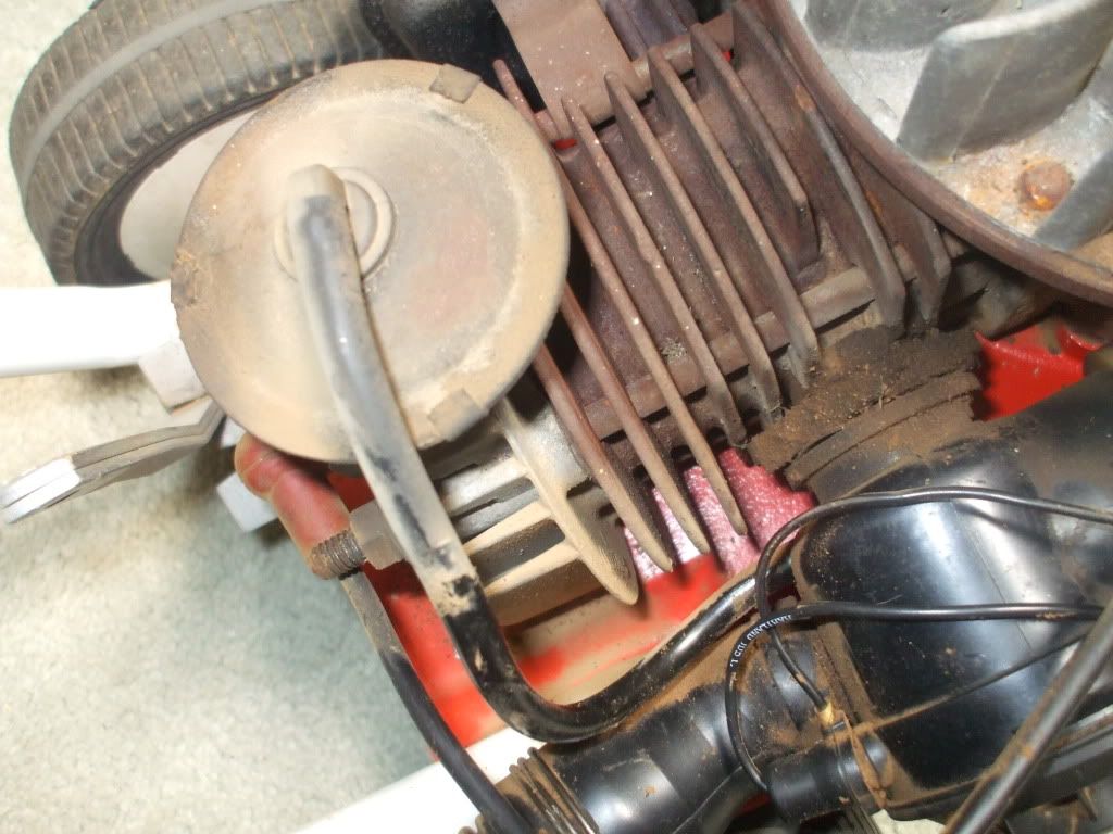

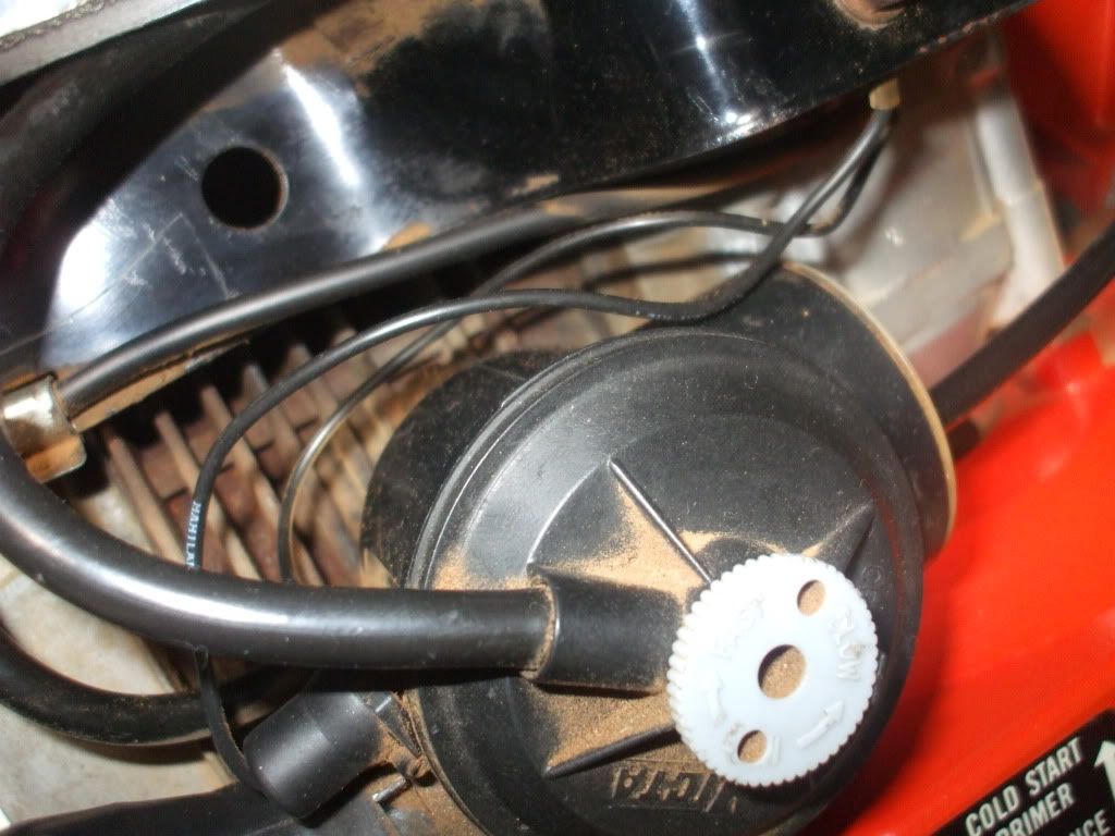

Hi Young, here are some pics of my TAC 80 so you can see, hopefully, where everything goes:
[Linked Image from i266.photobucket.com] Fuel Line to front of carby.
[Linked Image from i266.photobucket.com] Decompressor to rear carby body where you had the white broken bit.
[Linked Image from i266.photobucket.com] From under the engine cowling to side of carby.
[Linked Image from i266.photobucket.com]Eyelet to under first cowling bolt.
I have decided to remove my cowling and take these pics so you can see exactly where they go, so there is no confusion.
[Linked Image from i266.photobucket.com] Decompressor to where your broken tubing was.
[Linked Image from i266.photobucket.com] Vacuum tube from its attachment on cowling to side of carby
I hope these pics are of help. wink
Joined: Feb 2010
Posts: 33
Darryl,
What can I say - thank you so much for all your trouble and time. Absolutely clear now that my machine was set up incorrectly. I have swapped over the two offending tubes to match yours and Tilta fired first pull.
