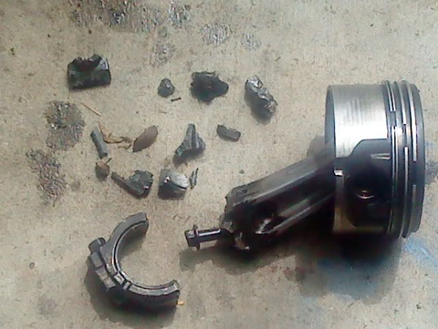

I owe a lot to the old Self Propelled 5hp Rover mower that I started my business with. She was a faithfull old gal right up until the end. I just didn't expect the end to be so dramatic! I was mowing away at one of my large commercial jobs and almost finished after a bloody long day, when POOF! She just ups and shats herself, lost all compression and sat there looking all depressed. So I finished the job with the old 5hp MTD wardog I picked up from a road-side dump and got working again, and wonder what the hell I'm going to do with the rover. So over the weekend I drag the old girl up the garage to give her a good seeing too and low and behold... it wasn't the bloody rings causing the lack of compression! ![[Linked Image from i1239.photobucket.com]](http://i1239.photobucket.com/albums/ff502/DirtyBertys/Picture012.jpg) The piston and rings looked great.... ![[Linked Image from i1239.photobucket.com]](http://i1239.photobucket.com/albums/ff502/DirtyBertys/Picture011.jpg) But the bloody con-rod didn't!!

Dirty Berty, That usually happens when the oil is let get low. Anyway I would be checking the crankshaft because the conrod could have locked up and left some alloy on it. If not just buy a new conrod and get the old girl running again.
Dirty Berty, That usually happens when the oil is let get low. Anyway I would be checking the crankshaft because the conrod could have locked up and left some alloy on it. If not just buy a new conrod and get the old girl running again.  This post is the whole reason as to why I started coming to this forum, anywhere else would say "its stuffed buy a new one" but the attitude like this when I joined up kept me here

Cheers for the offer and advice fellas. Unfortunately I think there's more bits and pieces sitting in the crate I cracked the block over than went back in. To be honest I don't know if it could be ressurected with all the little shagged out cogs and bits I think I saw glooping around in the bottom of the crate. I had to shear off a couple of the block bolts to split it two as well.
