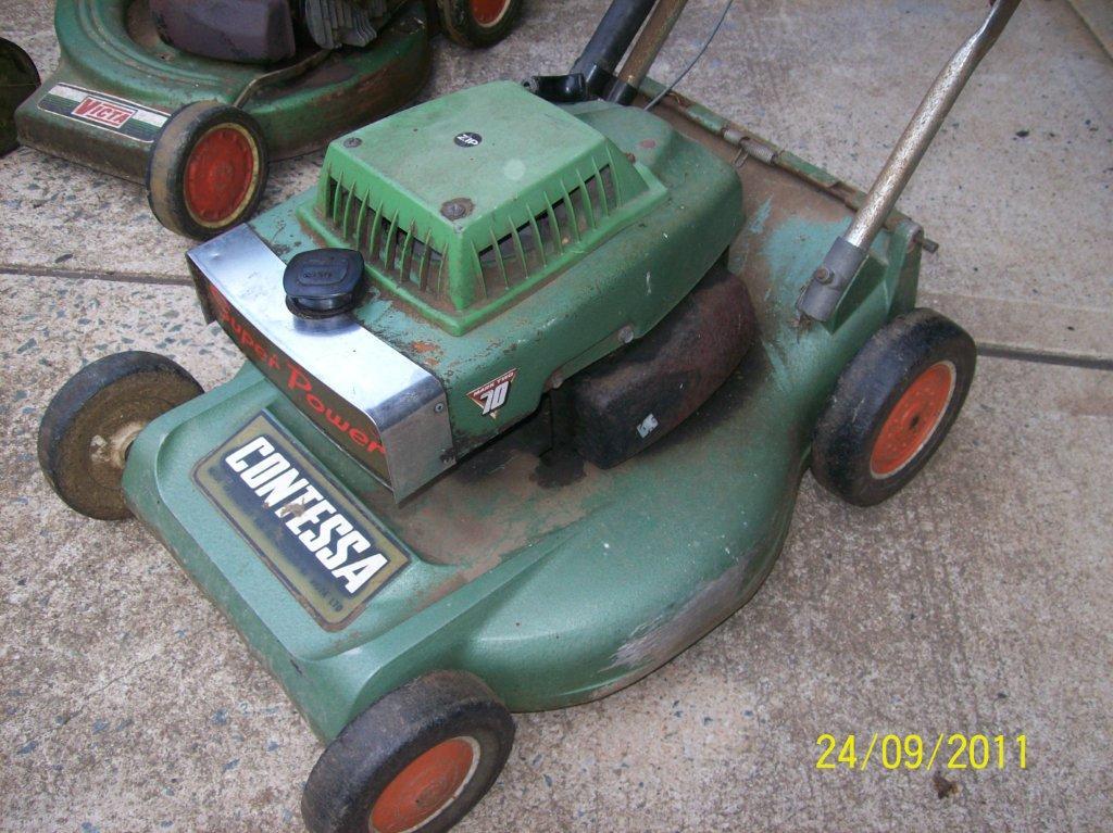

I've been trying to fix this Victa mower. It's a 'Contessa', made exclusively for Retravision at some point. For about two years it's been sitting outside by a shed, but there does not seem to be any weather damage. It turns over fine. There is a spark. It is pumping fuel. The kill switch is making proper contact at the right time. It is sucking in air from the snorkel properly. I've checked for hornet blockages and have found none. It turns over smoothly. However there seems to be a petrol leak at the bottom of the carb, a slow drip usually after the starter has been pulled a few times.

Does it attempt to start if you pour a very little amount of fuel down the spark plug hole?
I would be looking at a minor blockage in the carb after a long sit.

Yeah i was thinking the same thing, jet blockage or oil gunk blockage.
I tend to give any old mower thats been sitting a while the same treatment.
1. Wash the whole mower.Remove cowl and clean out gunk around motor
2. Check underneath for stuff wrapped around shaft and clean out gunk.
3. Remove Muffler, tap and blow out.
4. Clean carb outside roughly, remove carb, dismantle carb, clean, blow out jets, reassemble. Blowout snorkel, attach carb.
5. Flush out tank!! If it's been sitting for a while the fuel evaporates and leaves behind all the gunky oil. Blow out fuel line
6. Remove plug, clean plug, give a couple of quirts of a lube in the plug hole, wind over, check spark.
If all the above goes well, reassemble and let her rip!
Let us know how you go.

Thanks for this advice guys. I've had to fix the carb now, as I accidentally broke off the valve's rocker arm where it connects to the throttle cable. I'm trying to make a new arm, but my improvised arm is rather dodgy.
There was a lot of rust flakes and gunk in the fuel tank, and it seems the carb was getting fuel, but not fast enough. There also does seem to be a fair bit of gunk clogging up the carb where it joins to the piston chamber.

Also update is that there is no spark, and the magneto needs a look at. I can't seem to get the nut off the fan, any tips? It seems to be stuck out of old age.

I got the flywheel off. XD There is junk all over the magnets and they need cleaning. Prior to this, there was not even a tingle in the spark plug lead.

Hi guys. I've started working on it again after a break. I think I'm in need of a whole new dynamo as I've gone over the whole assembly and can't get any spark -> I'm guessing the coil's shot. I fixed the cut-off problem, I've added a silver toggle switch on the body that simply has ON-OFF written on it. I've given it a paint job or at least 50% of it. I resprayed the handlebar and moter+moter cover black, and when I get some, I'm doing the pull start, body and fuel tank in racing green. Will post photos when done.
