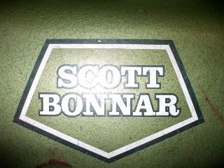

Hi Craig, here are the pics of the decals as applied to the last model (aka "Mark2") Scott Bonnar Model 45.
Handle bar cover decal
Catcher and chain case cover decal

Craig, did you get hold of some decals?? I could use a few myself, for front of catcher, chain cover & handlebars if I could find who makes them.
Thanks- Ross
Joined: Jun 2010
Posts: 85
Not yet Ross, working on that at the moment, Devoisi did say he had a contact though.. Maybe if you get a hold of him? I would be happy to know aswell! Other wise I'm going to get someone local - sticker maker to make some up.. I'll give him the design. Prioity is to get the thing back together first! Lawn needs a mow!.
Joined: Jun 2010
Posts: 85
A guy from Adelaide on Ebay is selling some SB decals. I have purchased the green pentagon for the catcher and round red decal for the handle bars to suit the early 1980 Model SB45's. Im not sure if he does the chain case cover though.. So if Anyone is interested have a look.
Cheers, Craig.
