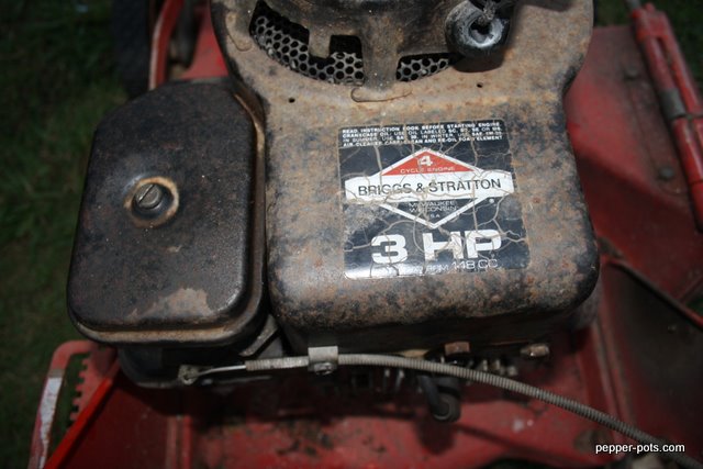

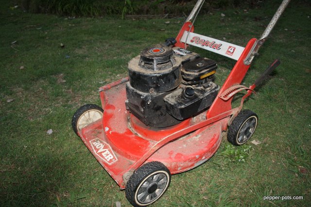

Hi there. I found a Rover Rapid in the hard junk collection.
It has a 3.0 HP Briggs & Stratton 148cc engine - but no spark,
investigation reveals: the magneto has 2 magnetic parts - ie one at 12 o'clock and one at 6 o'clock.
one of the magnetic parts is no longer magnetic at all. the other grips the loosened coil like it's demon possessed.
Should they both be magnetised?
If so - is it worth buying and fitting a new magneto?
or should I put it out the front again... smile

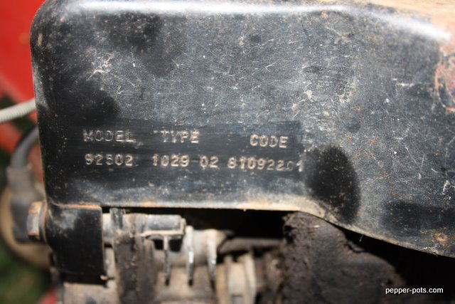

Here's a link to the images:
Serial Number
[Linked Image from lh4.ggpht.com]
Rover Rapid
[Linked Image from lh6.ggpht.com]
Dusty, yes
Your B&S engine - a 92502 model - was built on 22 September 1987. All B&S engines built from 1982 onward have no points, so you are correct about that. A simple ignition test procedure is to isolate the kill wire (engine stop wire) to make sure it is not grounding intermittently due to, for example, having chafed through its insulation somewhere, make sure the module has the correct air gap and is properly grounded (not loose or rusty where it mounts), clamp a spark plug with gap increased to .060" by its metal body to a grounded metal part of the engine, attach the ignition wire, remove the normal spark plug so there is no compression, set all controls in the start position, and pull the start cord while watching the gap in the modified spark plug. If you get a steady stream of blue sparks, the ignition system is good. If you get orange sparks, or intermittent sparks, there is reason to suspect the ignition module is faulty. At that point, if possible try a known good module and see if that corrects the problem. Chances are someone on this site can help you with a known good module for an early Magnetron B&S - it is a very common engine type.
on the code I cant quite make it out is it 87 or 81, cheers.
Having taken a closer look, and compared it with the other two 1s in the string of numbers, I agree with you Joe - I can't tell either. Seems like your advice was better than mine - alwayscurious needs to trace the wires from the module, in case there is one leading into the housing under the flywheel. At least he'll then know whether his engine is 1981 or 1987.
Part of my reason for thinking it was 87 is the radial pull starter - I thought they were all vertical pull in the early 80s.

Definitely an 1981 model. smile Checked the bigger photo - yes 1981.

A 1981 model has points, located inside the flywheel. There are three main possible causes of your problem:
