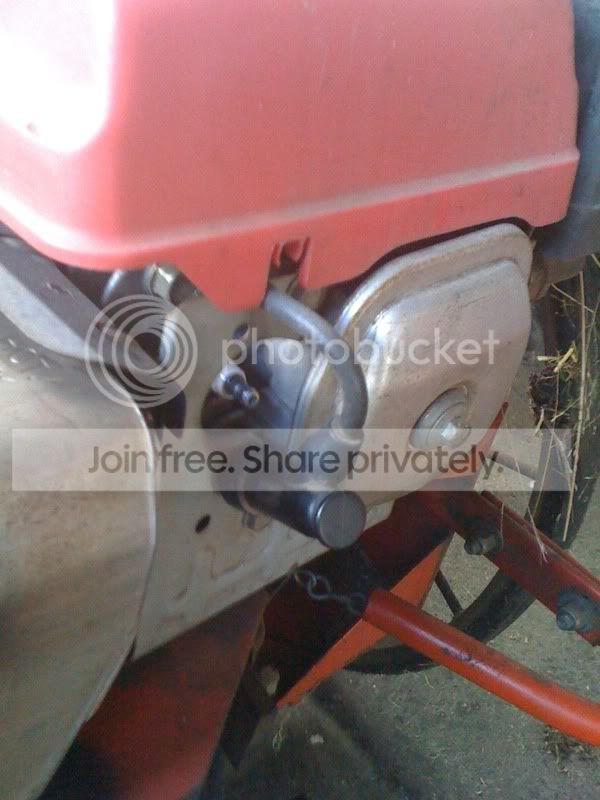

Hey All, I have a Honda walk-behind slasher. Just wondering what the correct procedure is to shut it down. This is a pic of the spark plug cap.
[Linked Image from i928.photobucket.com]
I assume at the moment that the correct method is to pull the cap off the plug ???
Advice please.
Greenfield Evolution 2.
I've never seen a small engine that was intended to be stopped routinely by pulling the plug lead off the plug. Very old B&S engines had a metal lever attached to the cylinder head that was used to short the plug lead to earth when you wanted to stop the engine, but that was pretty crude: you sometimes got an electric shock when using it.
It is normal for the ignition system to have a kill-switch that shorts out the low-tension part of the magneto when the speed control is moved all the way to the low speed position. Honda mowers have this feature, and I'm guessing your slasher does too. If it isn't working, you may need to adjust the speed control cable.

Simon can you post a pic of the whole machine, this may help?
