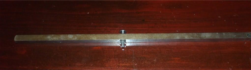

I have used in the past a straight edge with a bolt and a nut welded to it. What I did was put the straight edge on the rear roller and front roller and then adjust the bolt until it was just touching th bottom blade on one side.
Then I would move it across to the other side to see it had any difference and if you did you knew that the frame was either twisted or the bottom blade was bent or the height adjustment was out. cheers2
Bruce, I'd like to know I have a straight frame before I check for localised distortion or bad things having happened to the bedknife mount. In particular, I'd like to check the frame before modifying the bedknife mount. I'd hate to have people filing the bedknife mounting holes oval when what was really wrong, was someone had twisted the frame (with a bit of home welding, for example).
Hi Bruce, grumpy and Rob,

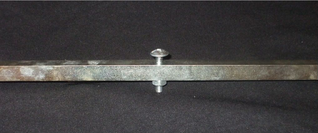

Bruce, your quite correct there mate, I bought this alignment tool a couple of years ago on the advice of my local greenskeeper, to enable me to set-up my Scotty correctly.
It's made of 1/2" square hard chromed steel, 18 1/2" long, and has a cup head screw that is screwed into a tapped hole with a locking nut on the underside. The screw is located in an offset position being exactly 8 1/2" from the left-hand end.
As Bruce has said, you place the rod on the front and rear rollers, and adjust the screw so the underside lip sits on the topside edge of the bedknife blade. You then slide it across the bedknife from one side to the other to see if the alignment is correct.
Hoping this is of help. wink

I see what you are getting at with the bar but wonder how you "run" the bar along the bedknife and the rollers. Is the mower suspended and/or upside down and/or just sliding the whole machine along it in standard position? I guess the other question is that if the blade is only out by the proverbial bees wilbur how can you tell with your bar and nut?

Re: checking with the straight edge, the machine is laid straight back to the ground, resting on it's handlebars, to expose the rear roller, bedknife assembly and front roller. Rob, caution here, as with a petrol engine, the oil will run in areas it's not supposed to....this procedure is best carried out during an oil change, so the oil is not a problem. wink
