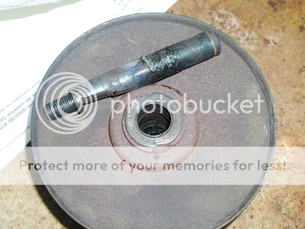

Anyway back to business. i disassembled the variable drive pulley thing and have found its bearing and shaft to be heavily worn (look hard at the shaft and you will see the huge chunk missing!). I am wondering whether or not new press in bearings are available for this unit. I can always machine up a new shaft to suit but are a bit scared about the bearings. If worst comes to worst I can always make a bush out of seamless pipe and do it that way, but really don�t want to!
I have the parts manual and it the part number for the complete assembly is: 738-0141.

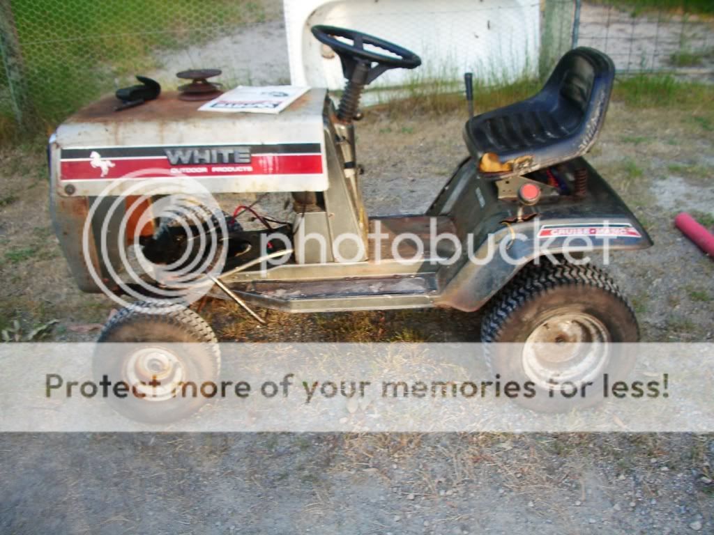

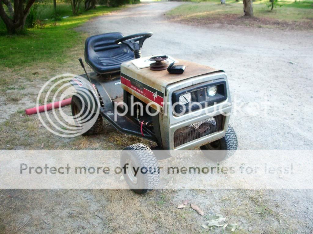

Anyway here are some pics

So the latest is I have sat down and worked out the marvels of the variable speed pulley system and have decided to resurrect the old girl. So I will go to the bearing shop and get some bearings. I have a feeling there is a small, very small chance I may have to machine up a new shaft, but that�s easy as I have access to a lathe. I think I will adapt the pulley carrier so it fasteners the shaft from the bottom and the top, making it more sturdy and hopefully preventing future wear.

Firstly thanks Bruce! I had a look the top bevel gear and it seemed fine so I stood around and scratched the old noggin a bit looking at the parts diagram and then my assembled gear box and could not find a thing wrong. I then started pulling apart and swapping the bevel gears and turning around the selector to no avail. I then proceeded to dig up some decent shims out of the deep depths of the washer bucket and sticking them in between the shaft and the brass bushes to push the whole gear assembly to the other side and bingo that did the trick. It seems the type of grease I have put in was making the bevel gears stick to the selector and slid around in the free space there for bypassing neutral. Anyway that may be helpful for someone in the future. During the week I dropped into the local bearing suppliers (Frankston bearings) and bought the roller cages needed in the variable speed pulley arrangement. These cost about $11 so that�s allot better than mtd�s $70. I will now fill the big gap in the shaft with weld, then spin it down in the lathe and I will be good to go in the drive side of things.
It looks like a mild-steel shaft that's had a really hard life - why not just turn up a new one? Seems more likely to end up straight and true that way. However, we all have our own ways of doing things, and anything that works and is fun, is a good solution.

well its been a hell of a long time waiting but finally shes back together and driving. the transaxel is flawless and shifts and runs better than new after all the work i did packing it out so everything was tight and true. in the end i machined a new shaft because the new bearings were metric and not imperial. i also had to bore the pulley out in the lathe but it was a piece of cake in the end. only thing was that i didn't have anything to make a proper gap for the circlip so i modified it to work my way.
