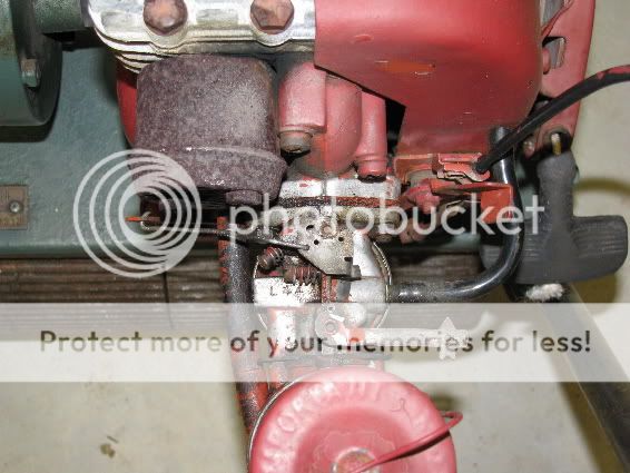

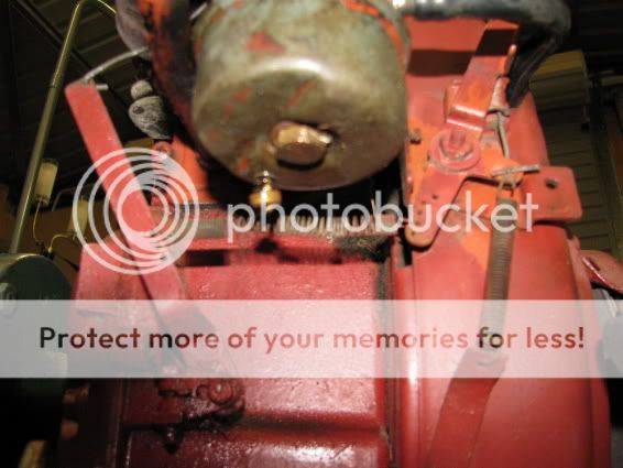

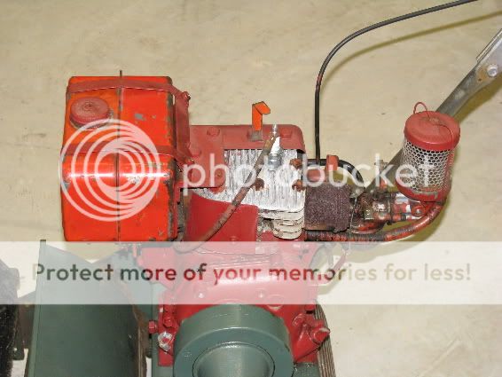

I've tried downloading some photos of my mower via Photobucket. I think it worked. I tried some close ups of the carby so you might be able to see what I'm talking about. If you click on this link it should take you to my post in the photos section of the forum. I'm still learning how to use the forum so I hope the links work?
On another note, does anyone know how much it would cost to replace the motor on my scotty with a new B&S or Honda engine and where I could get one from in Perth and/or where I could get it fitted?
wazzbat, I don't see any close-ups of the carburetor area.
Joined: Oct 2009
Posts: 56
Sorry Grumpy. They were in my photobucket but have only just worked out how to upload pics to the post. Theyre not the best/clearest but try these ones anyway...
This is of the dodgy old spring on the bottom
[Linked Image from i905.photobucket.com]
And this one from the top
And an overall view
That looks distressingly like the engine on an ancient 4 stroke rotary mower I bought (very) second-hand in about 1970. It was hard to start and didn't run very well, like yours - might be the horizontal version of the same engine (I never liked mine enough to remember what kind of engine it was. There was nothing wrong with it, but it ran like a POS. It even set fire to its own air cleaner once. I foolishly put it out - would have been more fun to watch it burn.) On yours, one of the governor springs seems to be trashed. It now thinks it's four different springs in series, each with different characteristics. It started life as a close-coiled spring, as the left-hand end of it still is, but somebody stretched it several times until it yielded severely. It won't work properly in that condition. It can be replaced by any close-coiled tension spring with the same free length and the same 'rate' - that is, how hard you have to pull to stretch it say one centimeter. Standard handyman stuff. BTW, you measure the free length by taking it off, squeezing it until it is close-coiled, and measuring the distance between the two end loops. Usually you can't get a spring the right length and you have to cut and reshape one end of a longer one. Meanwhile that crook spring could be causing all the problems you have described.
Edit: The engine in the pictures is a Kirby Lauson (Australian-made Tecumseh/Lauson).

Hi wazzbat,I have just had another look at your pics, and your machine is in great nick for it's age and properly maintained it will outlast all of us! lol
I think the guy at your local mower shop obviously doesn't know a lot about Scotties. Most parts are still available if you know where to look...(other than catchers for the early models)... but most mechanical bits can still be sourced.
If there was a prob with your clutch (and I'm presuming it is the cutter clutch we're talking about here) you could easily retro-fit a Model 45 clutch and engine shaft if necessary wink
