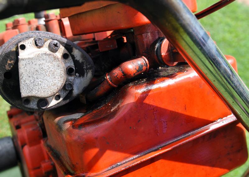

Hope this it what you are talking about..
Yes Peter, that is the positive crankcase ventilation valve, and it looks completely clean. The disc valve you can see through the hole, is supposed to be able to move back and forth as the pressure in the crankcase pulses. This is what the manual says:

It appears to be stuck on one side as I cannot insert the metal strip.
You should not be able to insert the metal strip anywhere around the fibre disk. If you can, the breather is worn out.
1. Did you clean the breather before taking that picture, or was it already clean?
2. Was the disk stuck to the metal, or could it move back and forth (transverse to the surface of the disk, not laterally)?
If the disk was crudded up and stuck, and you cleaned it and freed it up, we have an explanation for your oil-from-the-breather-hose problem. If it was pristine and working, we cannot blame the breather valve and have to consider uglier possibilities for the problem (like a broken piston, for example, since it happened suddenly).

I can insert the metal strip on most sides and can feel the disk popping back in position.
1. Only oil around the seal of the valve was wiped off. I did not touch the disk area.
2. The disk can move back and forth.
The engine still turns over freely and does not seem like there is any broken parts internally.
