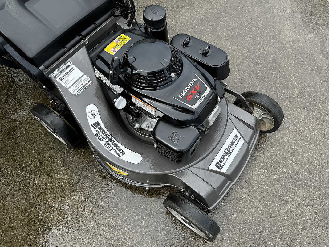

The compromise being the half chute, meaning I decided to keep the Rover for jobs I knew would be ultra thick. The idea being I would reduce the workload of the Rover and prolong its working life.
[Linked Image from i.postimg.cc]
The Bushranger was certainly a stout performer. The GXV160 is such a sweet engine, smooth, fuel efficient, plenty of grunt. Like all of these Honda/Chonda's, the muffler is too small so they are pretty noisy on full throttle, although it does have a nice idle tick-over. The half chute, yeah it did block up from time to time, I just did my best to take the right mower to the right job. And that heavy-duty that made it well built also made it hard to manhandle.

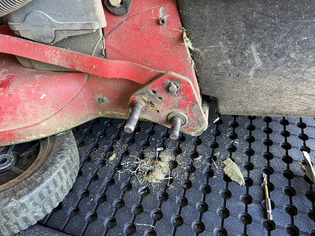

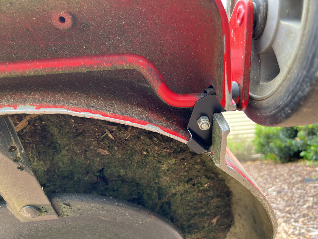

So, in the end, I tracked down a NOS set of brackets and axle bushings and repaired it myself. And guess what, while the chassis did have some wear, it was not as bad as they made out and certainly did NOT need the engine removed or the chassis welded.
Old, missing bracket.........................
New......................................
I later tracked down a set of NOS bushings as well.

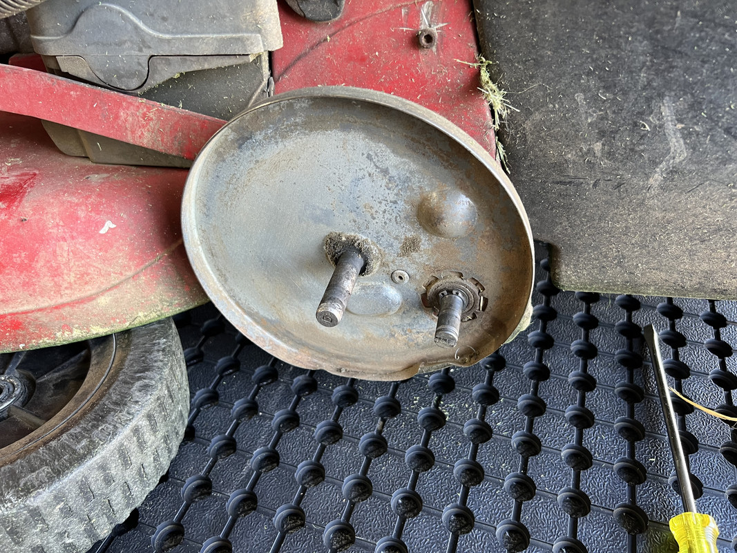

After getting the front axles sorted, again, the Rover was back in action.

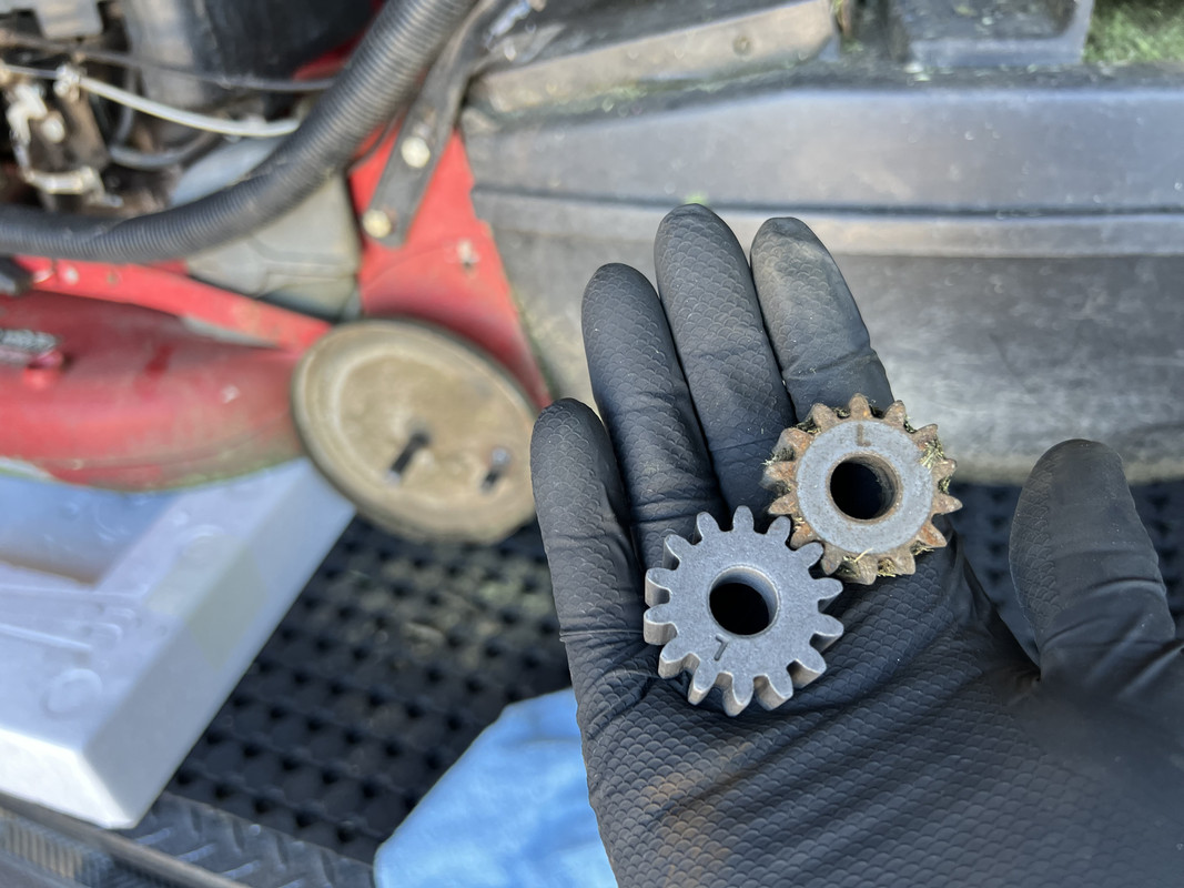

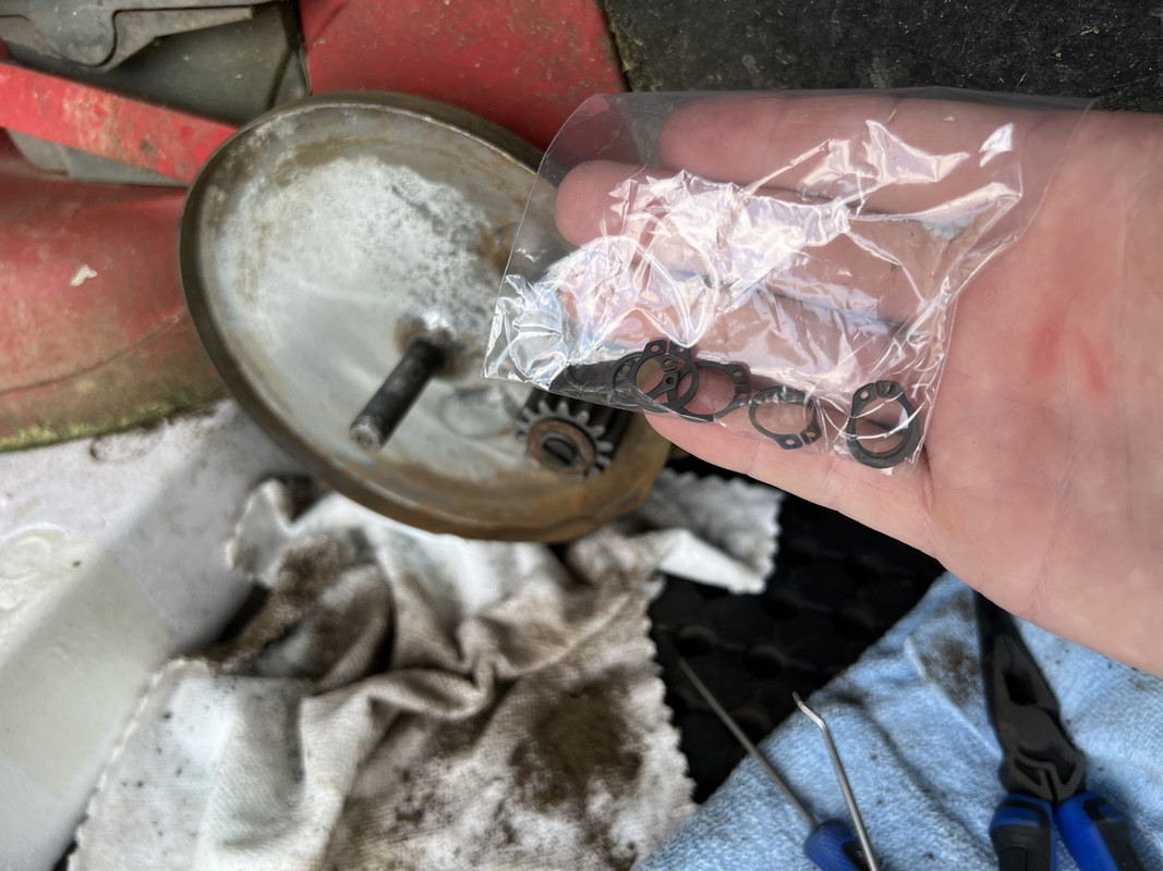

Early 2024, it was then time for another round of self-propel servicing. I was having issues with one wheel peel, in effect driving the mower to one side. This would be the first time I had played around with the drive system, so this became a learning experience. So, I ordered a set of cogs and pawls and got stuck in.
With the hub cap and the wheel retaining washer removed, the wheel slides off the axle. Then, the circlip retaining the cog is removed, allowing the cog and pawl slide off.
Old vs new, not terrible but not great…………………
The kit didn’t include circlips, and because they were so old and worn, I promptly snapped the originals during removal. A trip down to the local bearing shop, I got some suitable replacements along with a proper set of circlip pliers.
Before the wheels went back on, I lubricated with graphite powder.

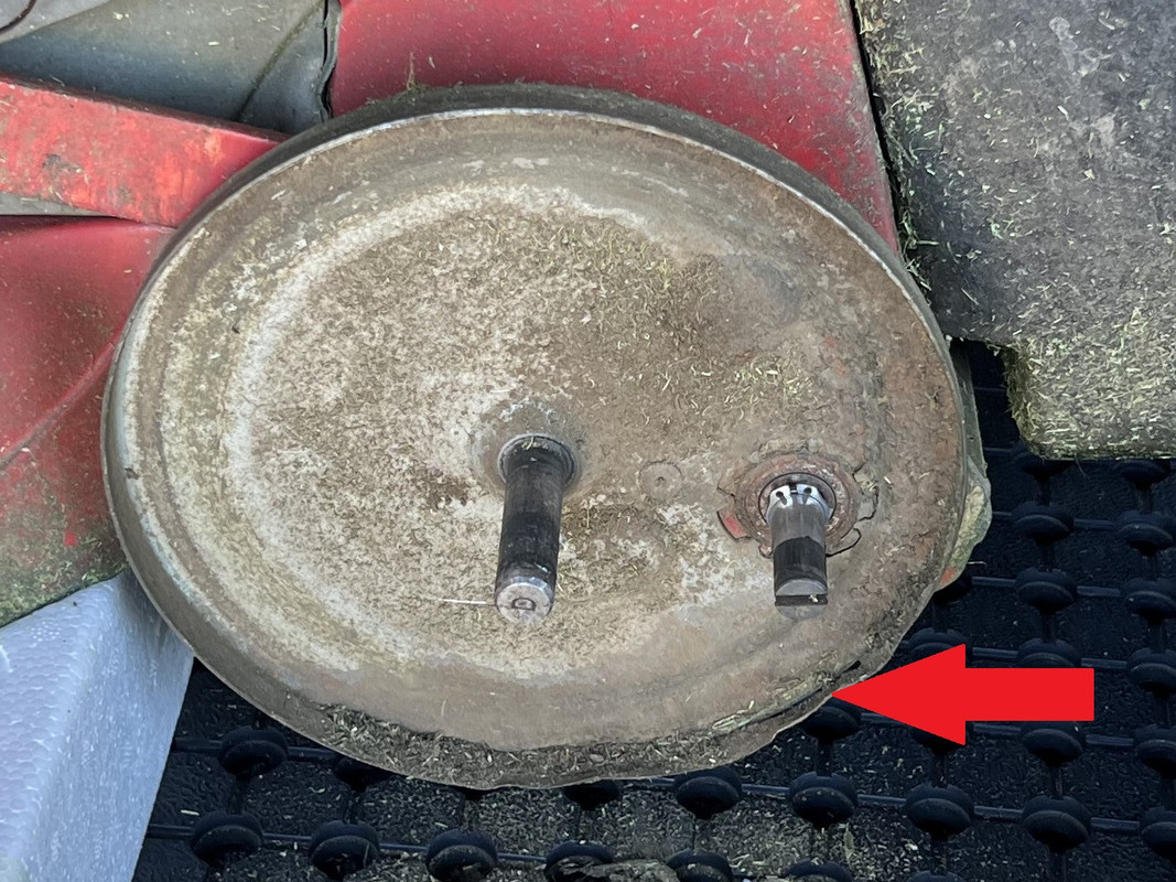

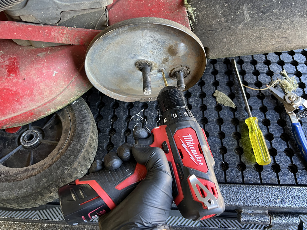

While I was doing this, I noticed the backing plates were severely worn, in turn letting too much dust and debris to enter the wheel and cog assemblies. Once again, these parts were very hard to find.
Even so, I put everything back together, then went searching for replacement backing plates. Rover used two or three of few of these backing plates, ProCut 50 and 560 have separate parts listings. I eventually found someone who had a set for the 560. So, the wheels came off again………………………

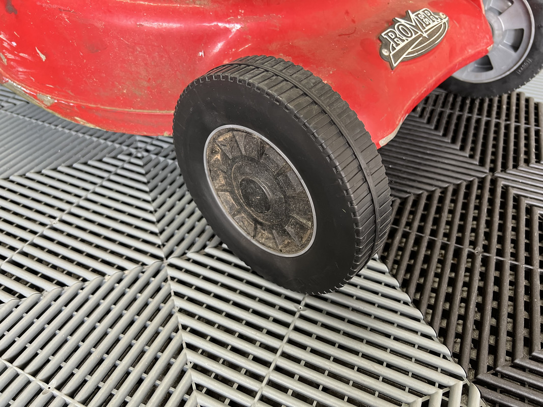

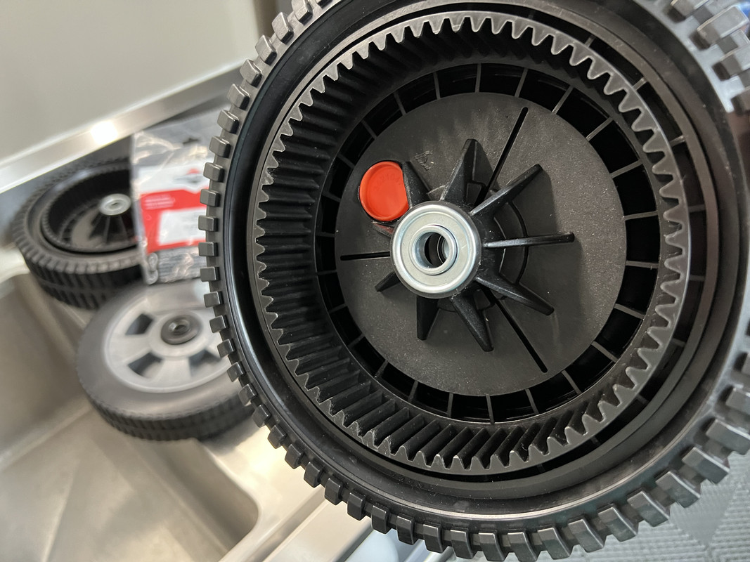

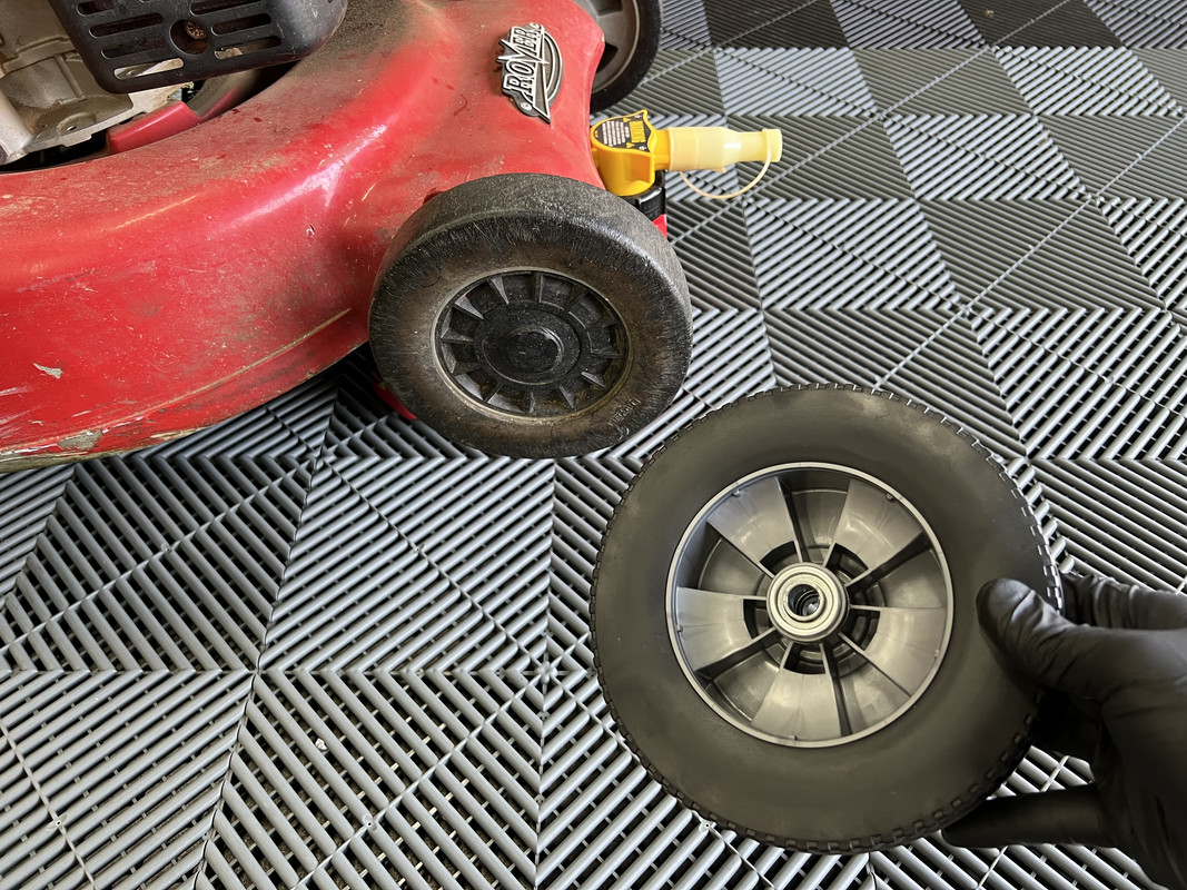

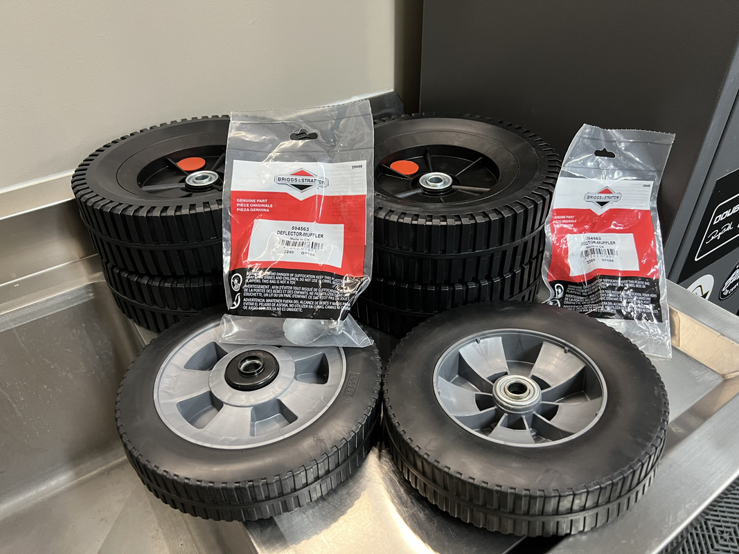

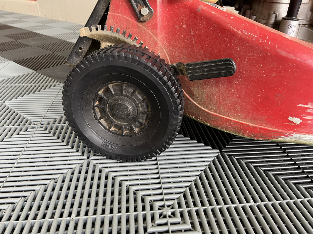

Upon further inspection, the lack of drive to one wheel was caused by a failed wheel assembly, meaning it wasn't engaging properly and causing the single wheel drive. Once again, off I went trying to find parts for an older, obscure machine. I make it sound like a chore, but I actually love tracking down parts, the thrill of the chase!
Now, there are two versions of these rear wheels, one for the ProCut 50 and one for the ProCut 560, neither are interchangeable. So, a very specific part for a very specific mower. After searching and reaching out to a past contact, it turns out these wheels are still available from Rover, so I ordered four of them! I get it now, these are not parts a retailer will have sitting on a shelf considering how expensive they are and only fitting one specific mower.
In this case, this is the 9-inch rear wheel as used on ProCut 560, Rover part 634-05015 or A10669.

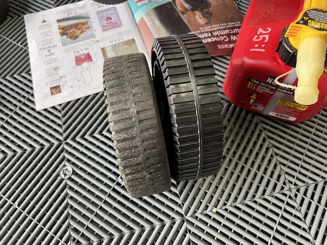

Knowing one of the two was broken, I didn't know which. As soon as I opened the box, I knew what the problem was, the new wheels not spinning withing the "tyre" so to speak, meaning the left wheel had failed internally and was free spinning rather than locking and then engaging with the cog.
Old wheel on the left, new on the right. It's at this point I remembered what had been done last time the wheels had been attended to. These are not the original wheels, the shop replacing both the left and then right on two separate occasions, the left-hand wheel being the oldest, somewhat explaining its failure. It also had less "tread" than the newer right side.
New wheel against the old hub cap does things to my OCD............. rolleyes

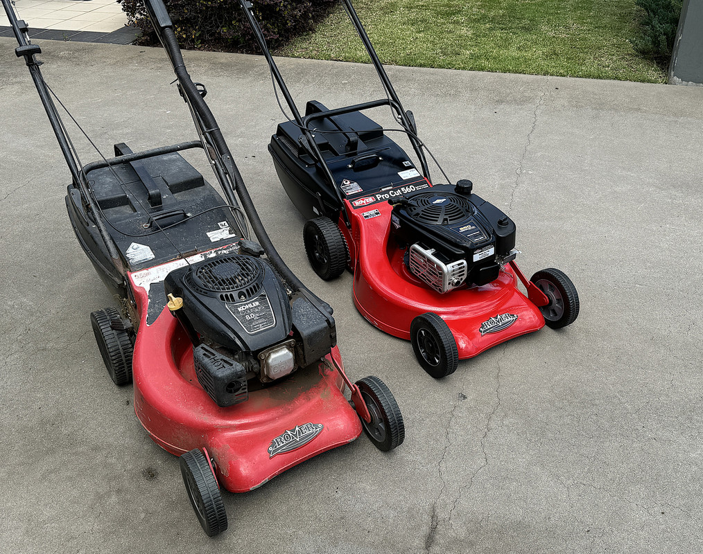

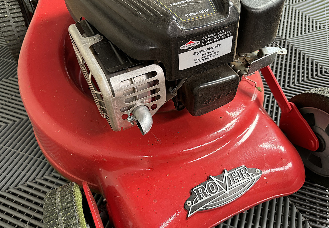

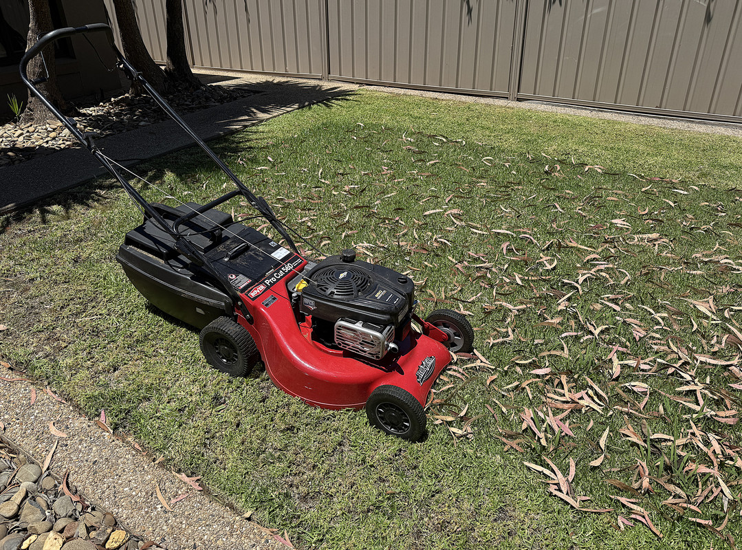

After near 20-years working part time for the same company, starting in early October 2024 I decided to use up some hard-earned long-service leave. It's a long story, but I had been planning this leave for just on two years, basically waiting for my brand new Mustang to be build and delivered. Yes, I waited two years for a Ford. I ended up taking off on leave two weeks before the car arrived, promptly finding something that caught my eye on Facebook Marketplace....................................
This is what I call the Unicorn.....................a Rover ProCut 560 with the Briggs and Stratton 190cc 850-series engine. Having had a number of these over the years, this is the engine I always wanted on the Rover. The OHV 850-series appeared in the late 2000's and replaced the older Intek Edge engines. With a cast iron bore and a healthy 190cc, I've always found these engines to be super strong, pretty much the only 4-stroke push mower engine that can keep up with a Victa 2-stroke. The only main drawback to them is the fuel consumption, but I'd much rather have power and torque to spare than saving fuel.
This example presented very well in the advertisement and was located only an hour away.
So, after I contacted the seller on the Saturday and organized a time to have a look at it, I got in the Ranger on Monday morning and set off towards Cobram-Barooga.
Once I arrived, I spotted the mower in question was stunned at its condition, the photos didn't do it justice! Chatting with the seller, he seemed to be into mowers as well and once bought (another, not this one) brand-new Rover from the factory back in the day. This particular ProCut was handed down from his grandfather, which nearly had me in tears because I too have my grandfather's old mower. Apparently, the seller was downsizing so the Rover was just too big and heavy for him. The machine was originally sold by Sugden Kerr in Toowoomba, its better traveled than me!

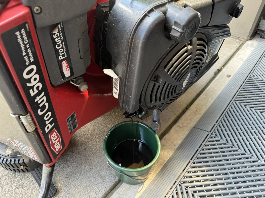

Once I got home, I wasted no time and got stuck into mowing the front nature strip to get a feel for it. I then grabbed the tachometer, the 3030 rpm is the fastest standard Briggs 850 I have come across, most of them sit at 2800 - 2900 rpm from the factory. I then grabbed my excellent Knipex curved pliers to bend the governor spring tab towards the front of the engine, bringing it up to a healthy sounding 3670 rpm. This also speeds up the self-propel to a more efficient walking pace.
I do this to all of my engines, usually after the first oil change. I don't necessarily run an engine at 3600 rpm all the time, but it's nice to have some headroom when the going gets tough. And compared to some contractors I see (and hear) going around, 3600 rpm is tame!
The seller mentioned it had synthetic oil in the engine, and it still looked golden, if a little over-full. After tuning the governor, the oil was up to temp, so I decided to change it out for peace of mind. Oil of choice being my usual preference, Penrite 10W-30 semi-synthetic.

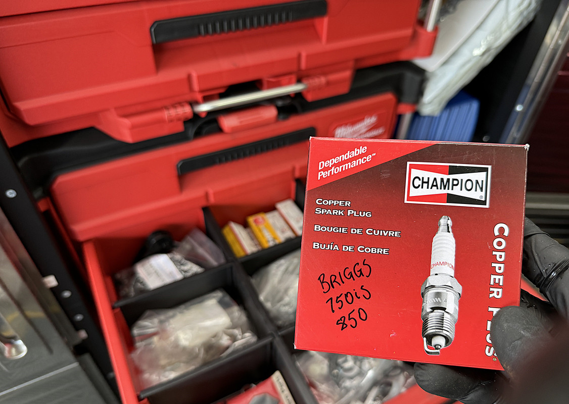

Next, I decided to pull the plug, which was ok but well worth replacement. The 850-Series uses a Champion RC12YC or NGK BCPR5ES, of which I keep the Champions in stock. You will need a 16mm deep socket for this. I use these plugs across 3 Briggs 850's and one 750iS.

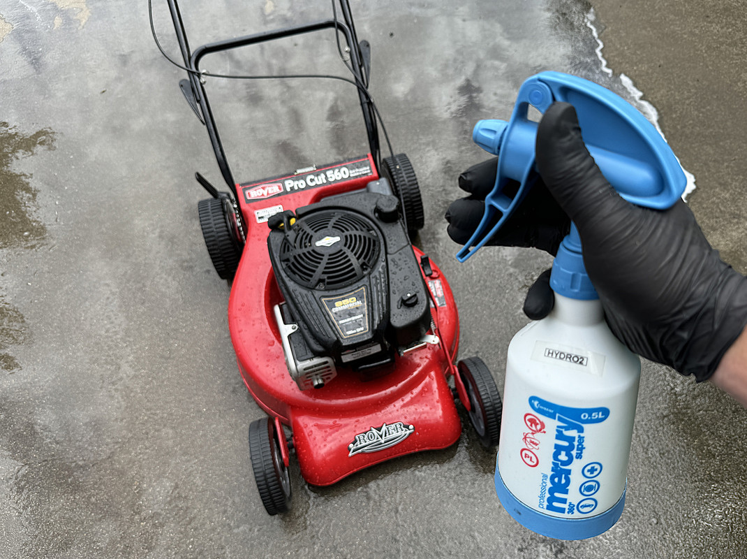

Because clean mowers cut better, I then got stuck into giving the new-old Rover a little detail.
After a rinse with the pressure washer, I sprayed the Rover down with Shine Supply Wise Guy, agitated with a brush and then rinsed. I then followed with Carpro Hydr02, which is a touch-less water activated spray sealant that is applied while still wet and immediately rinsed with water. From here, I dried it off with a leaf blower, then went over the catcher, engine plastics and wheels with Megs Hyper Dressing.

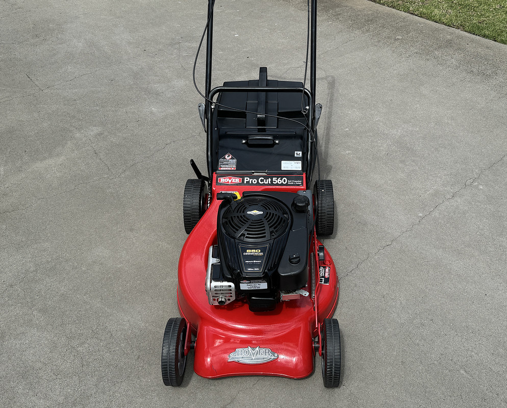

After a basic service and a clean, the Rover was ready for work. Hard to believe this is a 11-year-old mower........................
Comparing my well used Kohler powered example, the main difference being the bale/drive lever. The Briggs version has a single drive bale, but the Kohler uses that for the engine brake, as such it has a secondary lever to control the drive. I've always hated the useless engine brake and used a small clamp to keep the engine running to prevent restarting after each catcher dump. But I did like the single-handed drive control lever better, so no doubt some adjustment would be needed on my part.
The Briggs version didn't have the handle mounting for the starter rope, so I just swapped the one off the older Kohler machine.
A short video from the day..............................
The next day, I cleaned up the Bushranger 800-SP that was supposed to replace the old ProCut, then listed it for sale. Four years old, it cleaned up well and went off to a new home in short order.

On the day I picked up the Briggs powered ProCut, I went and ordered a few bits and pieces for it. Some of those parts were for good reason, some were simply because I wanted to……………a muffler deflector tip to match the rest of the fleet.
These deflectors are designed for alternative engine applications and redirect exhaust gasses away from the machine and avoid carbon accumulation. A very old engine/mower, but it illustrates the purpose.
So, in my case, completely useless other than it makes me happy. I mean, it could be worse………………….

Since I picked it up in October 2024, the ProCut was put to use and continues to be a faithful workhorse. This week, with the onset of a heatwave, I went ahead and changed out the oil and gave the whole thing a clean.
In this case, I went with Bilt Hamber Surfex, which is a water-based degreaser and all-purpose cleaner that can be used anywhere from neat/undiluted right out to 200:1. I've been using Surfex at 1:1 for small engine cleaning, it's much nicer to work with compared to solvent based degreasers that tend to be messy and stinky.
https://detailingshed.com.au/produc...5f8&_ss=r&variant=42998774890711
I've cleaned some truly filthy machines with Surfex, including this 1980's Stihl 028 AV Super.................................
Once clean, I applied Carpro Hydr02 followed by Koch Chemie Motorplast for the plastics.

Once clean, I changed the oil and sharpened the blades.
Clean, fresh oil....................ready to mow!
So, that's where I'm at, basically a new-old Rover ProCut 560 to hopefully last me another 10-years like the original did.
Speaking of the original ProCut, I decided to keep it, mainly for spare parts if needed going forward. Having said that, I’ve gone stocked up on a few parts while they are still available, such as the drive system parts, belts, cables, wheels ect.
For the most part, both old and new ProCut’s function the same. However, having the larger Briggs engine makes cutting through thicker grass much easier. Where the Kohler would choke and ultimately stall, the Briggs 850 powers through it. The other thing to note is how much quieter the Briggs is at full tilt, those Kohlers need a bigger muffler to suppress the quite pronounced exhaust “putter” at high revs.
2 members like this: Nick James, N1KK0

Deck –
While I had the blade carrier off, I took the opportunity to scrape off the accumulation of dirt and grass. Nothing special or glamorous here, just a paint scraper, wire brush………………….. and a giant mess afterwards.

Briggs normally specify SAE 30 oil, which I use in their older engines or for break-in. Otherwise, I’m using Penrite 10W-30 semi-synthetic. For the big block 850-series, you need 590 – 600ml of oil.
If Penrite is good enough for a Bathurst win last weekend, its good enough for my lawn mowers. …………………
I normally drain or suck the oil out via the dipstick tube. On this occasion, with the blade carrier removed, I decided to remove the sump plug instead. I’ve actually never done it this way, in fact Briggs & Stratton have removed the drain plug from their engines in recent years. Victa’s fitted with this engine are pressure lubricated via an oil pump, which is ran through an external oil filter. Those little filters are extremely expensive at $19.95 each, twice the price of some automotive filters. For the ProCut, Rover went for the basic splash lubrication, which saves me $20 per service.

Spark Plug –
The plug was last changed 12-months ago when I got the mower. I could have just cleaned it, but I had them in stock so just went ahead with a new one. I went with the Champion RC12YC, but NGK BCPR5ES works as well.

Ready for Work –
A quick test fire and the ProCut is ready for the peak mowing season.
