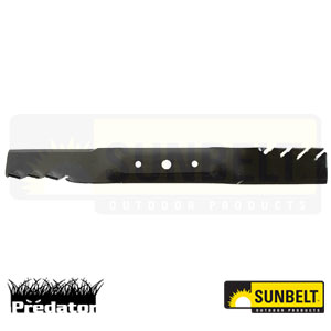

Hi all, I ordered some new blades for a mate, but he is telling me when he fitted them, the blades are touching when he rotates them. I am not in a position to have a look, as he is a few hours from me these days. I ordered them going by what the supplier listed for the model, so I am at a loss to think what could be wrong. Any ideas that could save me a long trip would be great. Regards. Geoff

The blades can not be timed. They are driven by a simple v-belt. But yes the do have cross over cutting wise as they are offset. Basically while the deck is on the mower the right hand blade trails the the left hand blade. As for low vibration it called having the bar blades in balance.
Geobee double check the blade specs. These are Gator type mulching blades. But JD original blades are mulching style blades that are m\no tooth but the specs are the same other than the thickness.
[Linked Image from aiproducts.com]
C to C 3-3/4" (the two outer holes)
Center Hole 11/16"
Length 21-3/8" (measured diagonally)
Outer Hole 13/32"
Thickness .187
Type Toothed
Width 2-1/2"
It is worth there are timed bar blade decks but they use a timing belt and timing pulleys.

Just an update on this. Well, without explanation, I get a refund into my bank account for the blade set. This was after I sent the supplier an email re the issue. I then questioned why they simply refunded without reason, and they said, oh, those blades are made wrong, they are 1mm too long. Would have been nice to know this before my mate went to the trouble of fitting them. Looks like they were just going to let it ''through to the keeper'' and wait until we come up with the problem. As soon as we queried the blades with the supplier, they refunded, so they knew there would be a problem in the first place. One supplier in my little black book.

We that was a good win, just cut 1mm off the end of each blade and you have a free set of blades, I'd be happy with that.

At least you got a refund easily. As Norm said, cut 1/2mm off each end, balance them and off you go
