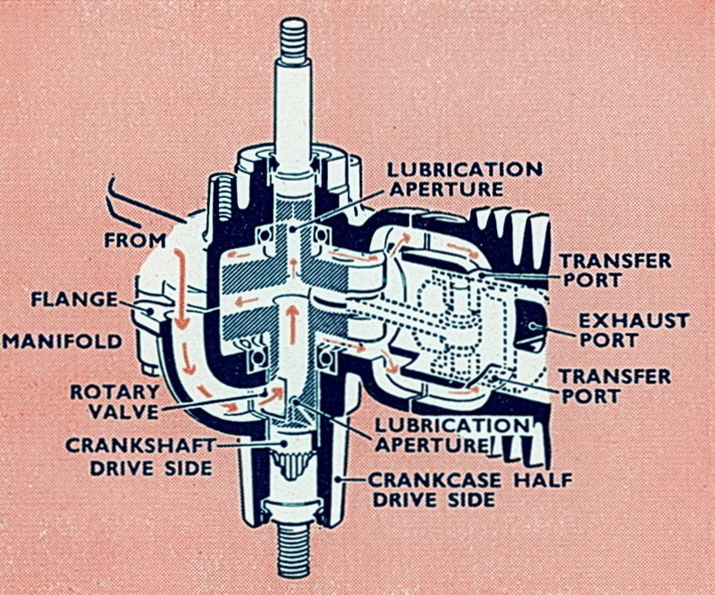

What is a Rotary Valve 2-Stroke?
Pope was always a competitive company and it had a proud tradition
as a market leader in irrigation. If Merv Richardson and John Boundy
could make their own lawnmower engines, then Pope could too!
Pope claimed that the rotary valve design had a clear advantage
over the loop-scavenge designs used by Victa and Boundy engines.
A rotating valve in the crankcase would eliminate the drawbacks
(pun intended) of a piston acting as a valve for mixture intake.
Pope’s explanation is presented in the following gallery.

Note that the fuel charge would enter the bottom crankcase
via a manifold and hollowed crankshaft. The fuel would then
be scavenged via cylinder ports to the combustion chamber.
The rotary valve and intake are clearly visible here ...

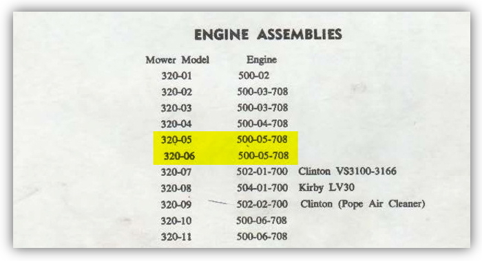

This later engine manual I date to 1960-61, when the
320-05 and 320-6 were introduced.
This would make the engine the 500-05-708
