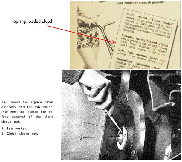

The Rotomatic had a more-complex engine protection system than what was needed.
The swing-blade system used on other rotaries - including Victas, right from the prototype onwards -
was a simple, elegant shock control system for blade holders directly attached to the crankshaft.

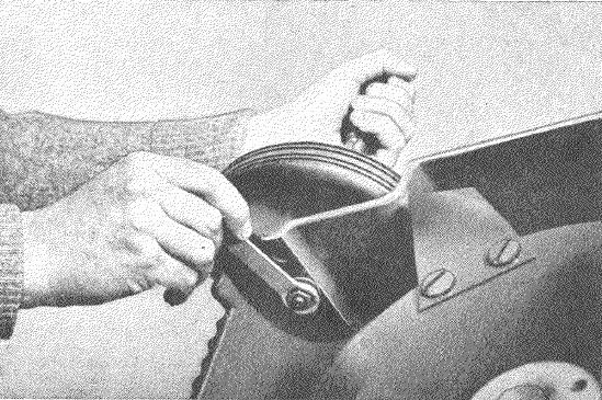

Instead, Ogden used rigid-mounted blades (to the blade holder) and incorporated a spring clutch to
protect the motor from shock loads. [see image below]

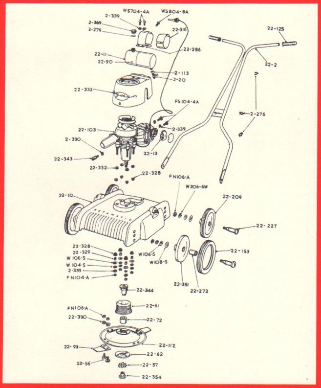

Here is a specification taken from my 1950s Mower Maintenance Guide:-
OGDEN ROTAMATIC
