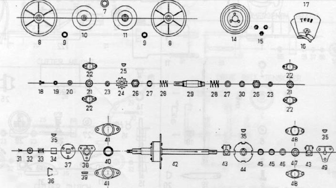

First, here is the relevant page from the Illustrated Parts List, for your clutch shaft and drive axle:
![[Linked Image]](https://www.outdoorking-forum.com.au/forum/uploads/usergals/2014/10/full-2772-18045-greenfield_ohv_14_32_drive.jpg)
Are you trying to remove the sprocket, Item 24, from the clutch shaft?
Have you removed all of the items on the outboard side of the sprocket, and removed the clutch shaft and clutches from the tractor? At that point, the sprocket can slide off the shaft. I don't understand your reference to a tiny grub-screw, please explain where it is.
