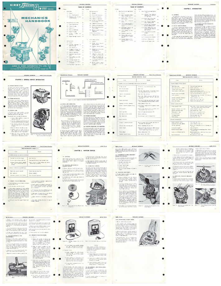

PART TWO – Chapter 1, 2 and 3
This part presents a Table of Contents, then a general introduction.
This is followed by General Service Information and then Ignition Service.
KIRBY MECHANICS HANDBOOK PART 01

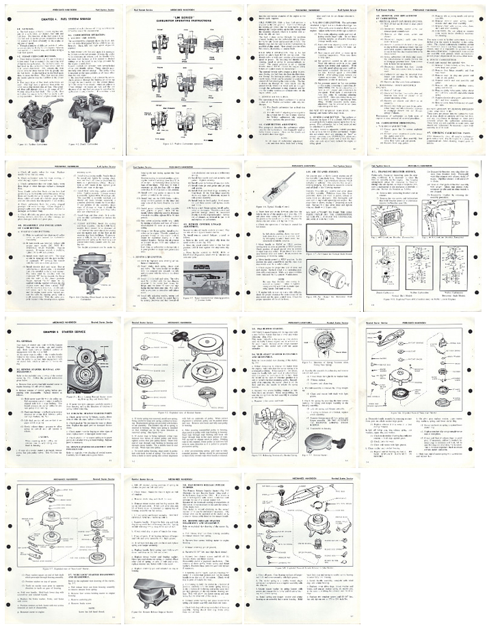

PART THREE – Chapters 4 and 5
Here the handbook covers Fuel System Service and then Starter Service
KIRBY MECHANICS HANDBOOK PART 02

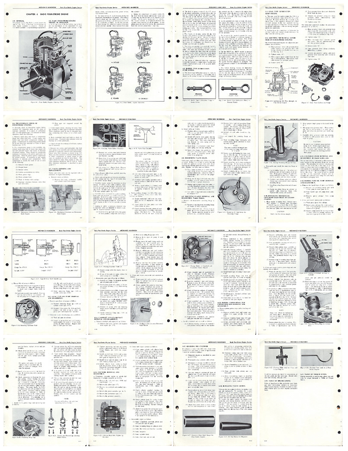

PART FOUR – Chapter 6
This chapter covers the theory and repair of the
Basic Kirby 4-stroke Engine.
KIRBY MECHANICS HANDBOOK PART 03

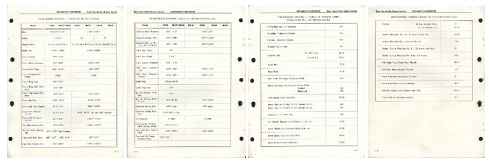

PART FIVE – Specification
A very handy set of tables covering specification, clearances and torque limits.
KIRBY MECHANICS HANDBOOK PART 04
