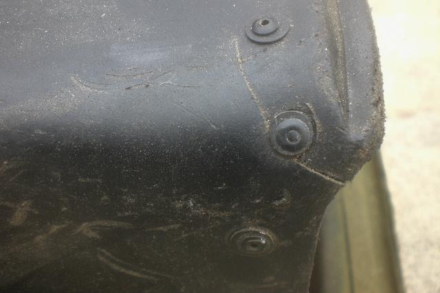

This catcher has a small crack on the top. I'd love to just glue it together but haven't had a lot of success gluing other plastics up. I know I can reinforce it with some sheet metal and pop rivet it but then it I guess I'd have to paint it as well to make it look good. What would be the quickest way to repair this or is there no easy way?

hears some pics off another silver streak catcher which was cracked and I repaired , pictures show how the repairs done, 1mm ally formed to shape and riveted from the out side. I have used this repair many times and never had any more trouble with cracks, washers added to top and bottom of rivets for more support [Linked Image]
good luck damo wink
Joined: Mar 2008
Posts: 612
Thanks Damo, a picture worth 1000 words.
Much the way we used to repair VC160 catchers back in the 1970's. Except that we used galvanised steel for the patches, sometimes on both sides of the repair, if it was very close to the front lip.
The washers are a must.
