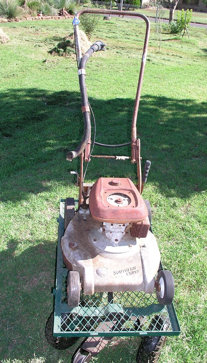

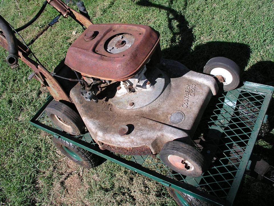

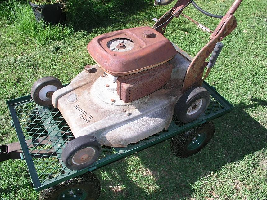

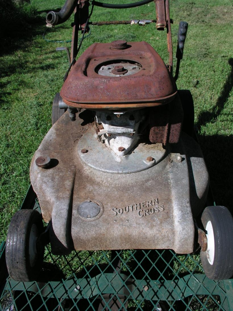

I purchased this beautiful lump of "rusty metal" yesterday. Clearly it is a Southern Cross mower, but not one that I recognize. Can anyone tell me which model this one is, and the approximate year? Has this one got one of the notorious Ballarat-made engines that were known to be troublesome? I am not even sure if it is a 2-stroke or 4-stroke! The base is not tin. It is cast alloy material, just like on the KXD-2. It does not have gears.
Also can anyone tell me if the cut out piece midway along the bottom on one side is the result of breakage? The shape suggests it was original and perhaps some sort of reinforcing plate was fastened to this position? There is a larger reinforcing plate on the other side, which is still intact but extremely rusty.

Your mower is a KX-A with a 140cc Villiers 2 stroke engine which is said to be reliable
Year?? the KX-A last made in the late 1960s
Ian

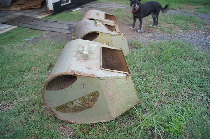

Hi Jack the catchers are out there
https://www.facebook.com/groups/SouthernCrossEngines/
Ian
Likes: 308
G'day Ian
I see that now. Amazing.
I note here a difference in the side and rear discharge rotary mowers
of the 1960s: side-catchers were always optional; rear catchers were
standard. That makes sense.
