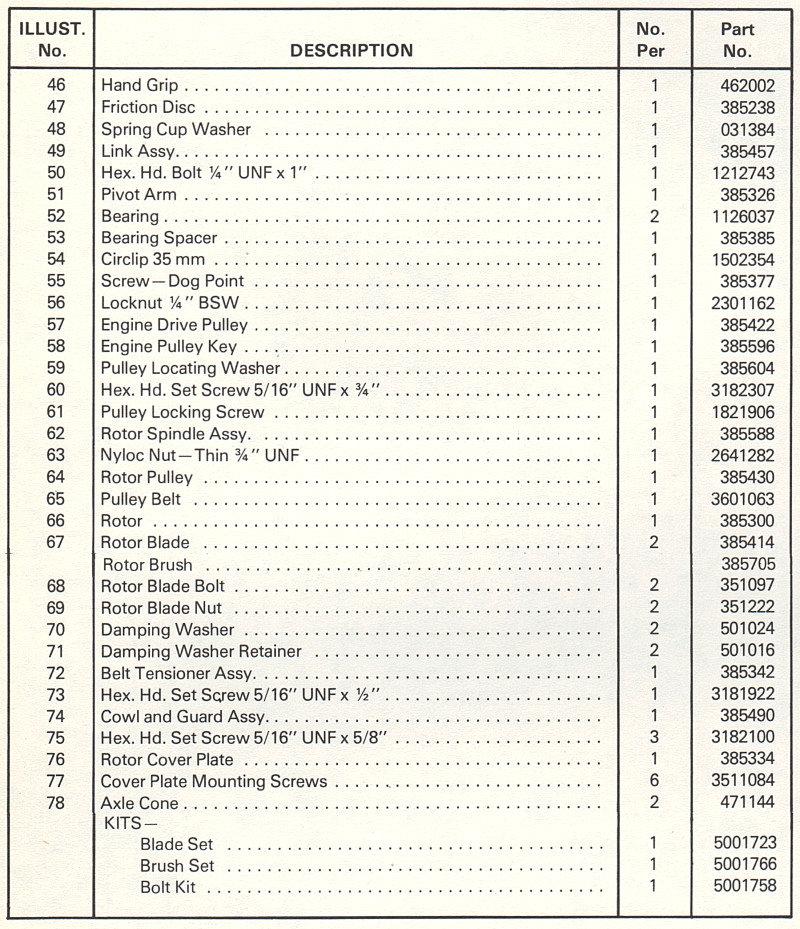

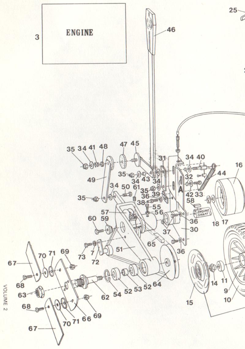

Hello gavin38 and vccomm,
The best I can do is an exploded parts view.
p/n (67) was the blade or brush.
Edger Blade Set:

amazing , if it doesnt help gavin it helped me ! now i know i need 47 and stuff , stops it dropping its why i stopped using it . thanks jack
cheers2 , Dave
Yes ...
good ol' Number 47 - the Frictionator.
I guess it would be made of ... cork (?)
p.s. the engine is poorly drawn. laugh

Right thanks for the replies ,my edger just has the rotor blades ( no 67 ) thanks cyber jack for the pic , I just bought some wires from outdoor king and im wondering where they attach to ?
hi gavin351 , 67 is the blades ...... 66 is the plate that they bolt onto you will need the bolt set for either blades or the wires .
