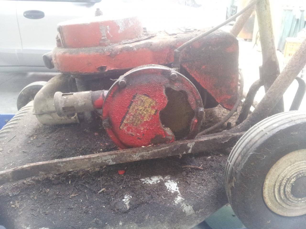

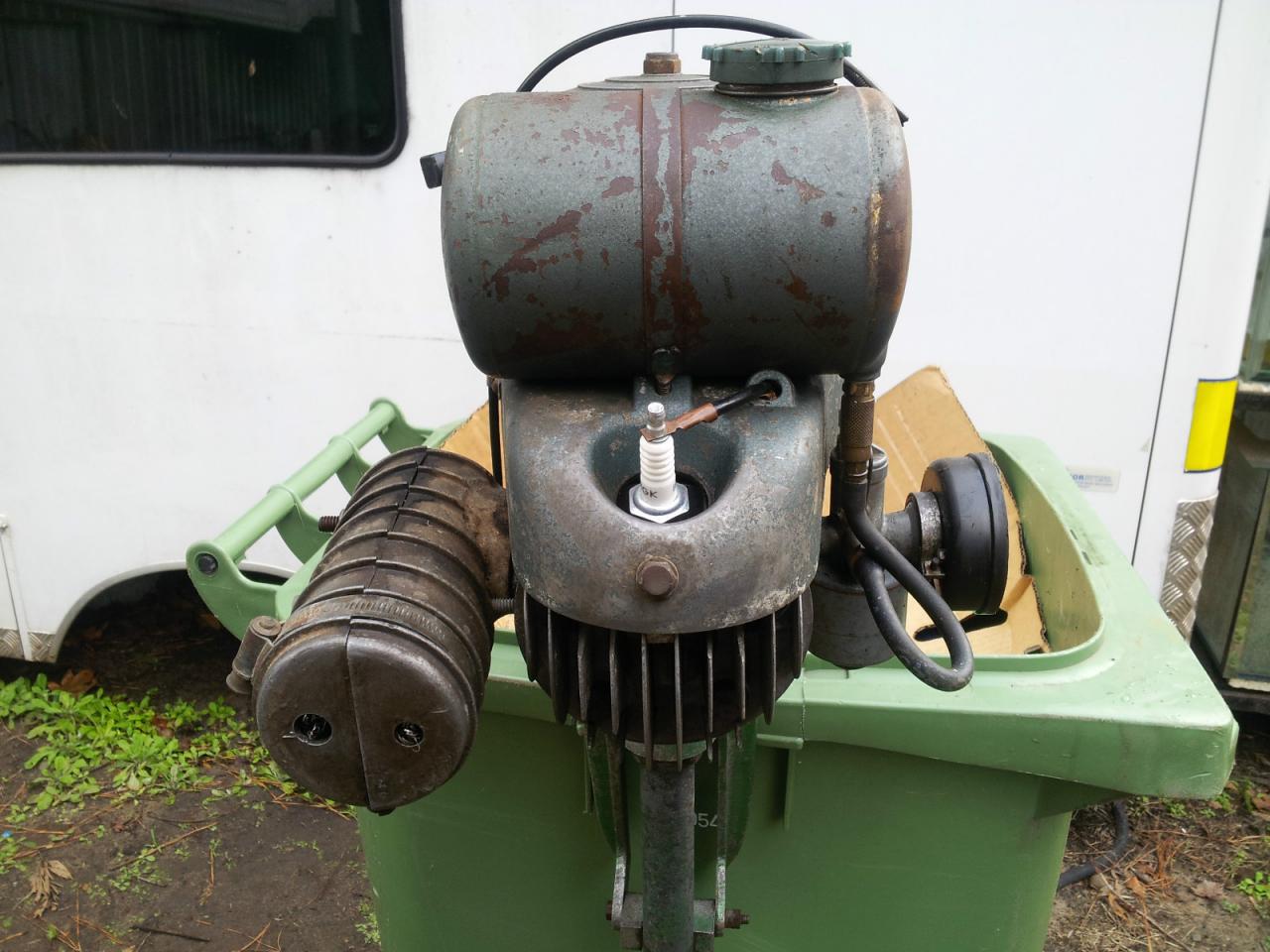

hey all, new to all this so bear with me, I want to restore an old mower that I got from the wifes family farm, more for sentimental reasons than anything els, it is I believr a bms series 10 lawn patrol, all complete and in fair condition, one of my main concerns is the missin bit from the side of the carby plate, can this piece be found ?i will try to upload pics and wait for suggestions,
thanks, pete

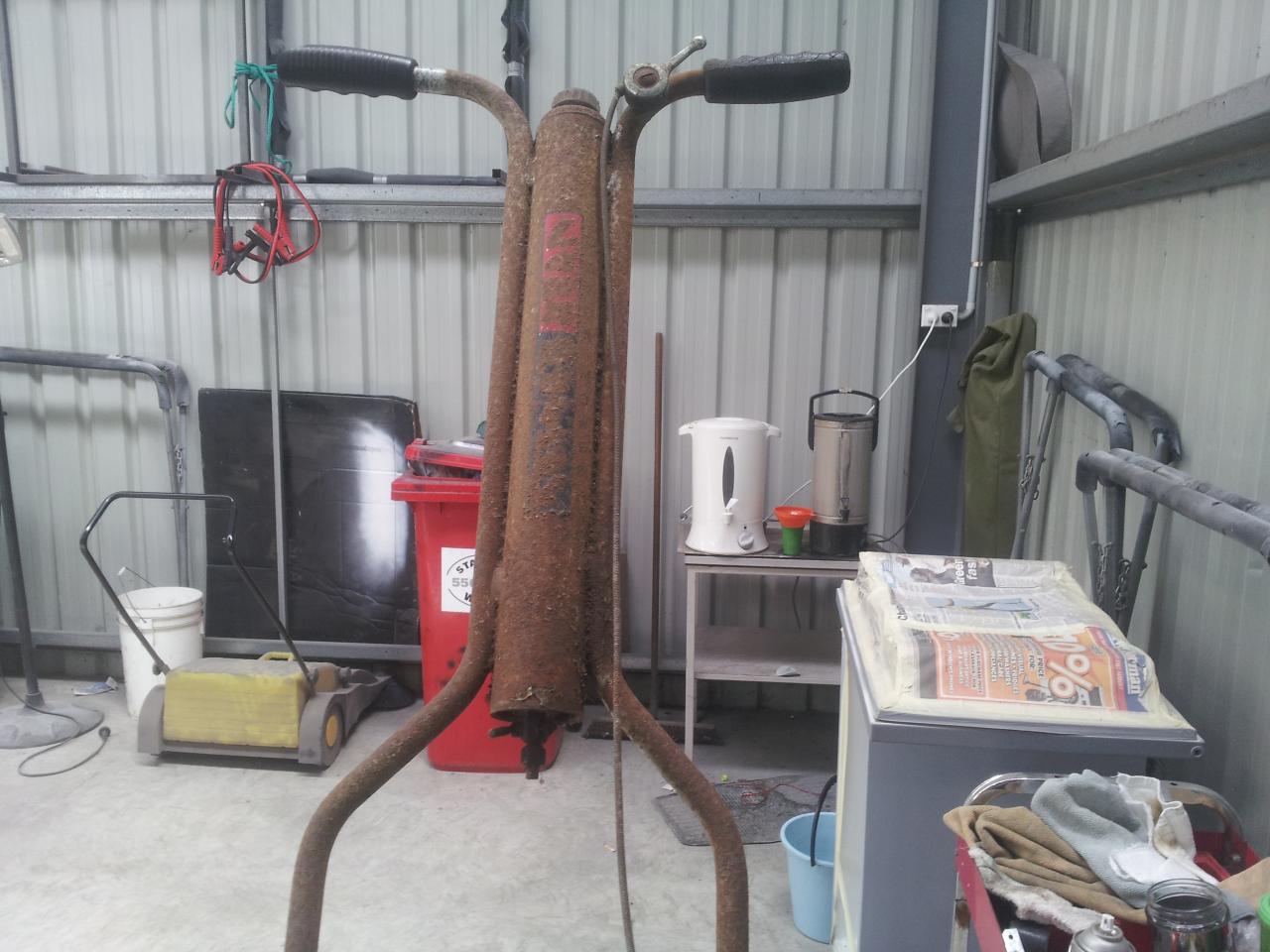

just gave it a hit with the pressure washer
Posts: 119
looks awesome....great Retro Mower...
Keen as Mustard to see how you go with it.... shocked
similar to this?[Linked Image]
http://www.ebay.com.au/itm/Lawn-Mow...s&hash=item4d0d2571a6#ht_1215wt_1018

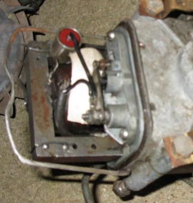

I've seen the BMS Lawn Patrol before, and I myself have it's baby brother, the BMS Lawn Cub.
I did have a number of spares for the Lawn Patrol, sadly, I think they have all gone missing.
The engines are similar, and you might find some interesting info in THIS thread.
Hi Ty, and thanks for putting up the link to your original thread....I knew I had seen one on ODK somewhere but couldn't for the life of me think where! lol
It's a rather interesting engine, BMS used their own set up, a crank case magneto, the coil, stator, etc. are all contained in that little plastic nose cone on the engine.
With the Lawn Cub, the points are not, by memory they are up under the flywheel, however on the BMS Lawn Patrol, I believe you will find the points are pushrod driven from within the crank case, and are indeed contained under that nose.

Lawn Patrol Ignition:
Thanks for that Ty, that design appears to be years ahead of its time....as our friend on VM would say..."all very interesting" grin

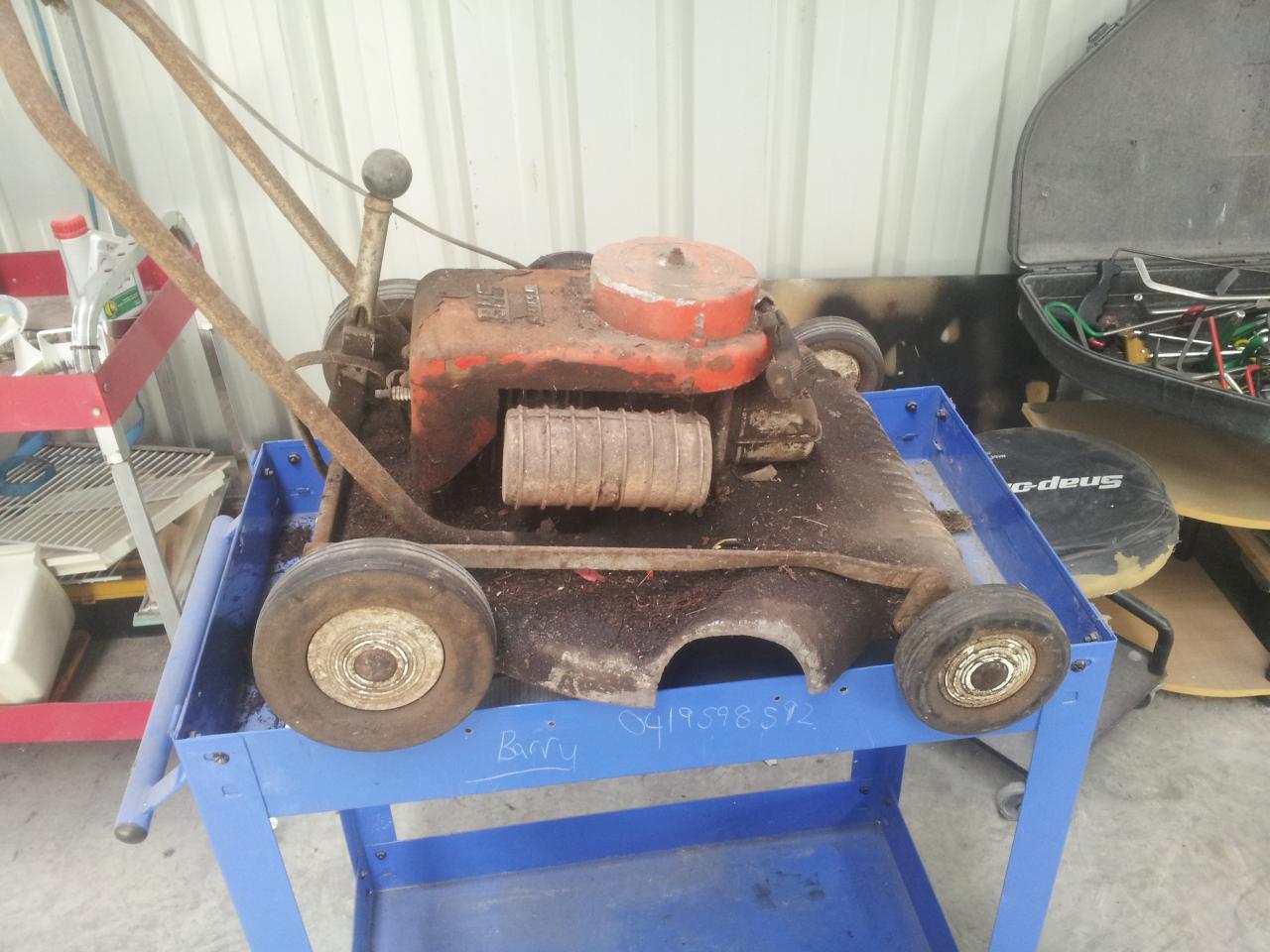

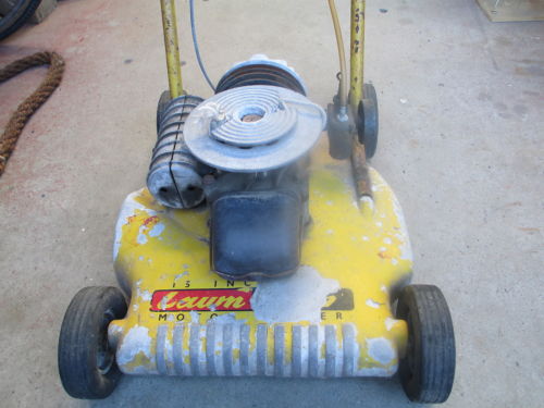

Just doing some reading up on Boundy after picking up a Nock & Kirby mower this morning, in his memoirs Bob Davies mentions Kelvin Grove. Was the Boundy Factory/Workshop located in Brisbane? Below is a pic of the mower I picked up this morning, original owner bought from N&K store in Blacktown.
