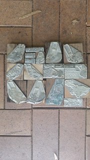

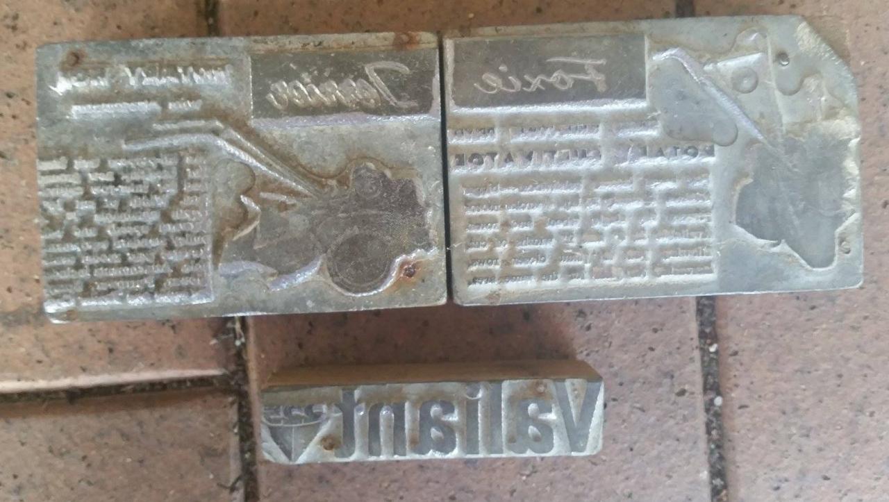

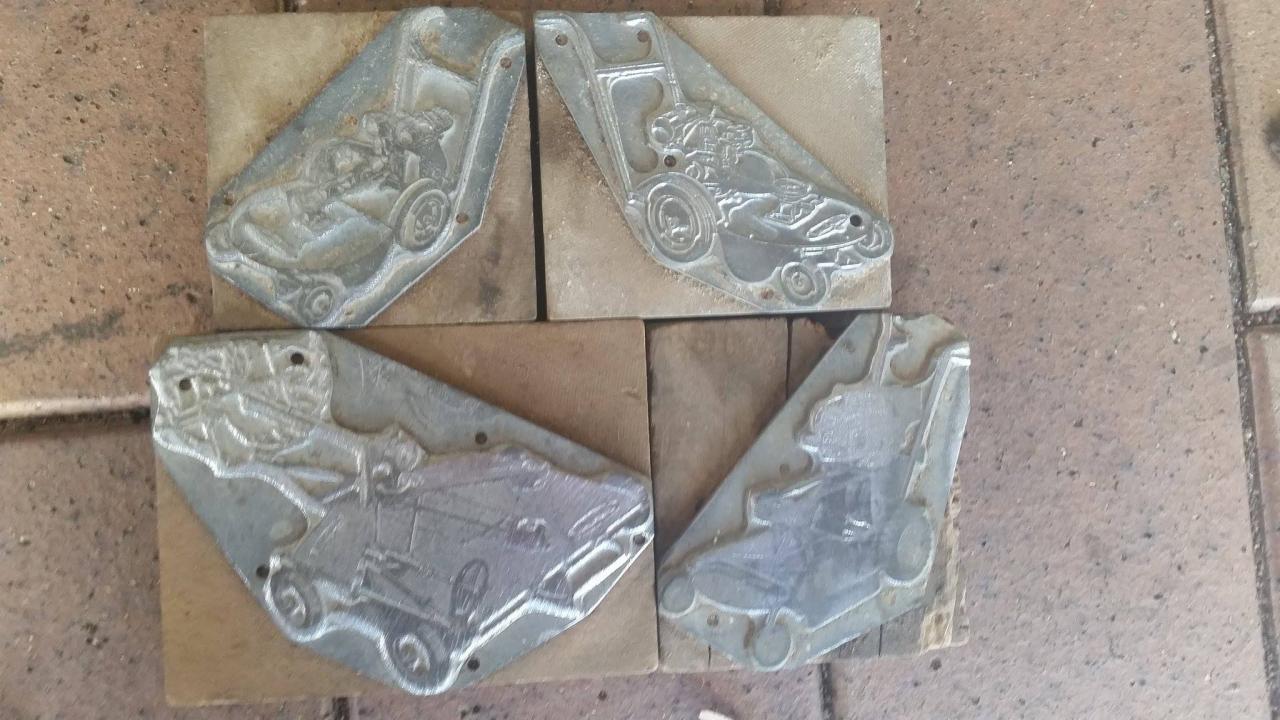

Scores these beauties today! 16 Stamps, most for mowers. 2 Victa Badge stamps, a little one for a consul 2 maybe? then 3 big ones, one for a self propelled, one for an Envoy and the other one for a Consul something. 2 Pope stamps, 4 that I am not sure about (the badges on the mowers look the same), 2 for some farm equipment and 1 for a Valiant 225 car. There is one that I think is for a coping saw that i forgot to take a pic of, its a bit scratched up.
16 beauties!
6 Victas!
2 Popes
2 Farm Machines and 1 Valiant car Stamp
I am not sure what these are, they look like they have the same badge
Thanks For Reading!
Kye.
Thanks for reading!

That's pretty impressive Kye they have to be particularly rare. Being lead they are quite delicate and surprising they weren't melted down for scrap or fishing sinkers by now. I have an old ad for a Chrysler dealer that I keep wrapped up in a rag in the bottom of a drawer. Where did you come across them?

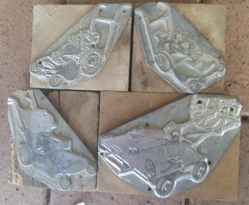

I'll do the unknown one (last stamp).
The top two are Australian Whirlwind slashers
Bottom right is a Whirlwind Tractor drawn slasher:-
Bottom left will be a Cox Mowmatic

I found them at the local flea markets Slash, I was very happy laugh
Thanks Cyber! I thought the badges looked like whirlwind but i wasn't quite sure. I am planning to someday frame them with the printed version. Thanks for changing the name too!
Thanks for all that info Gadge, I knew they would have been used for printing blocks but all i could think of in my head was stamps.
You just need to look! lol
I also just realized that the coping saw one is not a saw, but a chain saw sharpener! Very cool and will go with my dads chainsaw collection once we have them set up!

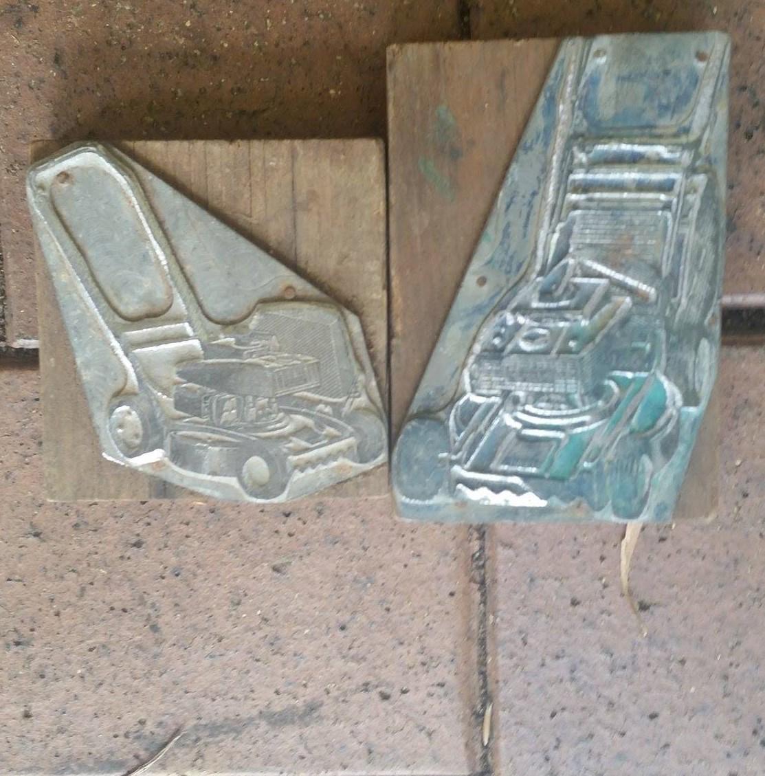

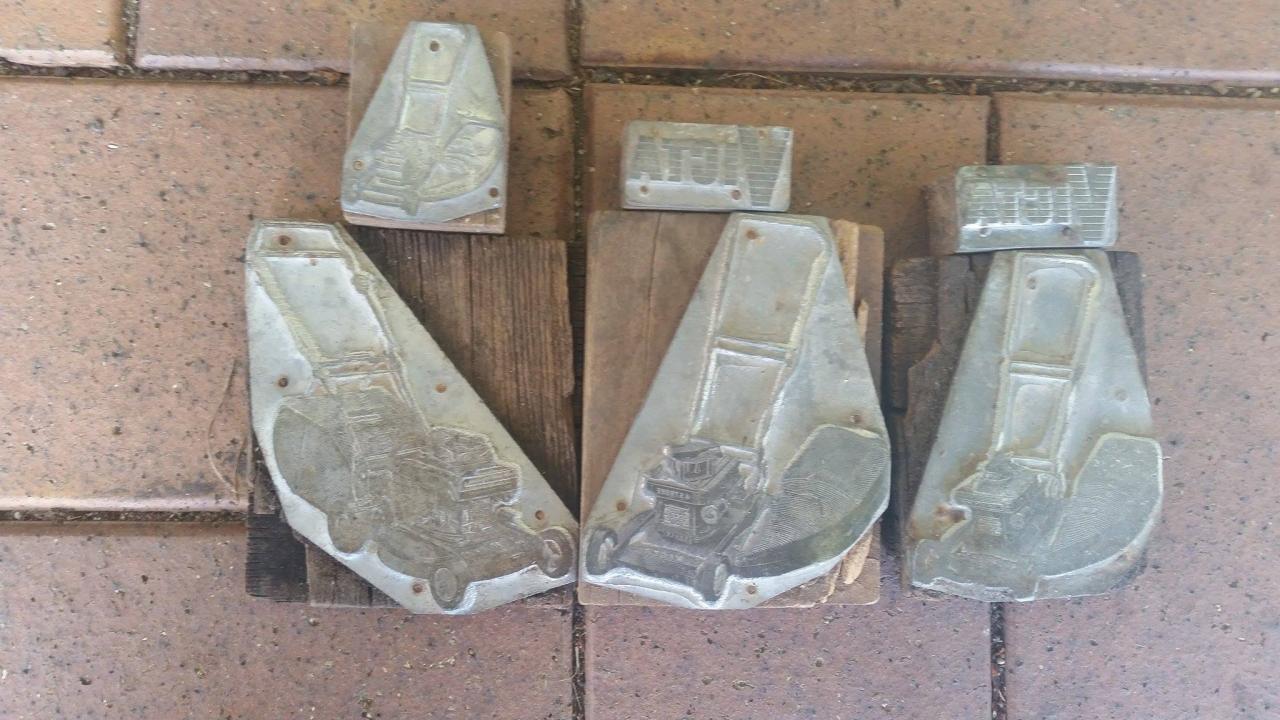

The Howard Foxie and Terrier blocks might be of
interest to collectors of Australian-made Howards...
The Pope ones date from the mid-1960s.
Bote I think are two strokes, but with the 4-stroke air-cleaner
that Pope were fitting prior to the snorkel designs.

Haha Jack I just get lucky, everything seems to be there waiting for me to buy it! Yes the terrier and Foxie definitely would be good for a collector! I am willing to sell if anyone wants them, sadly they are quite scratched up, I don't collect those so i don't really want to keep them, the rest are taking up enough room as it is haha! Someones already claimed the Valiant.

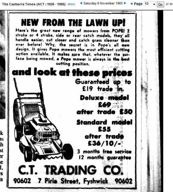

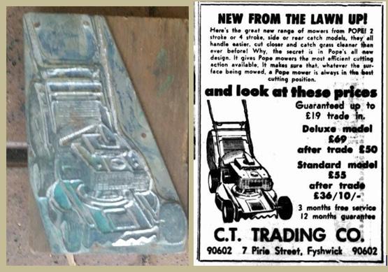

True, but, if good examples of the actual ads as they appeared in print
could be found, then that's the trick. You frame the block and an example
of how it looked in print. The block, itself, is admired for what it is,
worn or pristene.
For example, the Pope ad I re-produced above, would look great next to
the block that made it. Here, I have reversed the block to show that I
believe it was the block type that made the advert illustration.
Just thoughts.
Joined: Nov 2015
Posts: 637
Yes that would look very good, i wouldn't mind framing them with the original ad and an image that i made with the actual block, would be interesting to see how similar they turn out to be. I am also planning to sell of the Foxie and Terrier on my Facebook page in the next couple of weeks, or months, they look very nice sitting next to my laptop! The Valiant is sold and the rest i am planning to keep, might change my mind though, its a bit selfish not to share lol
