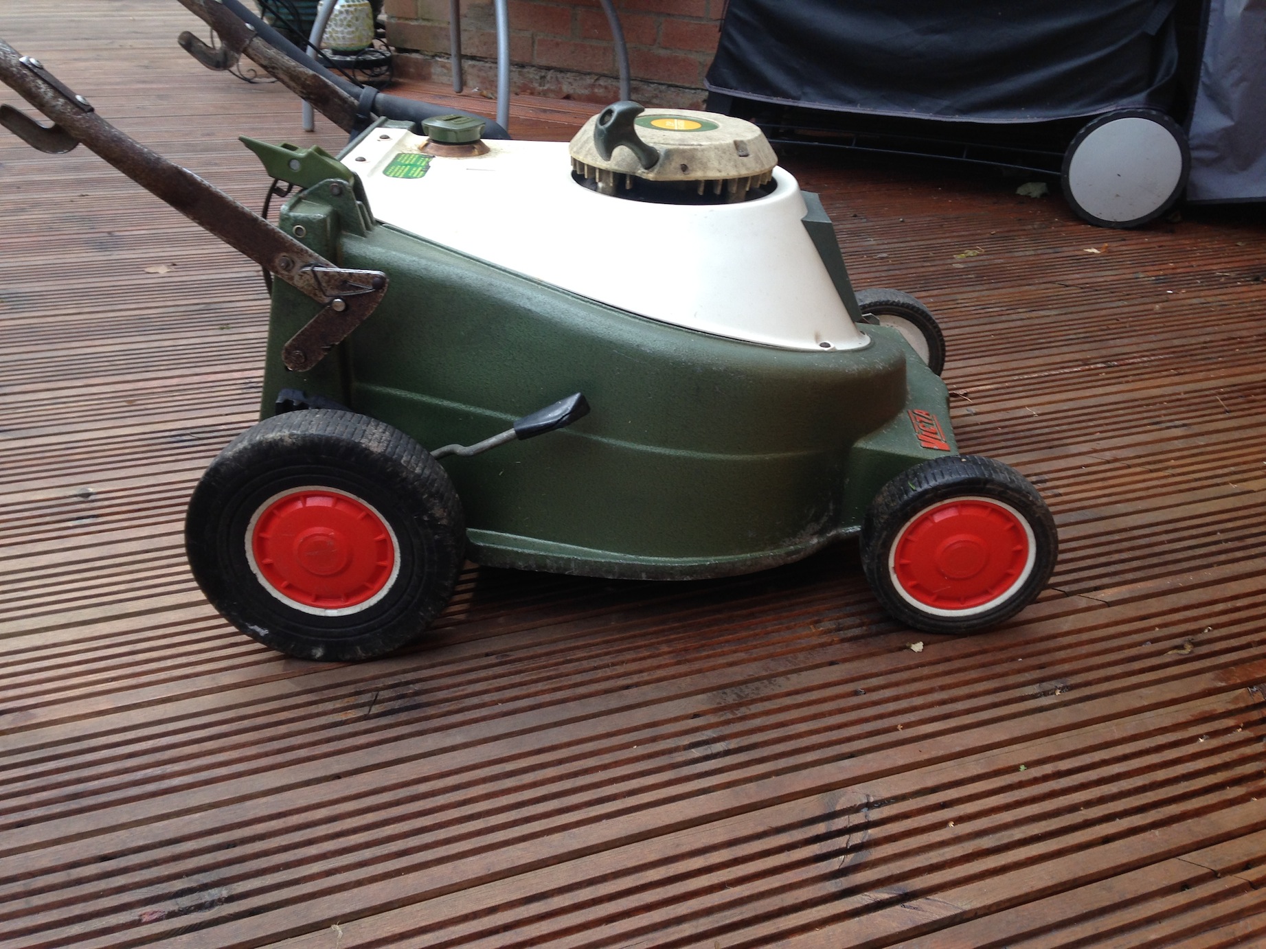

I had not seen my VC's for a while the green one looks OK.
Hi Blumbly,
Are replacement "Series 70 Mk II" decals available at all as they would be rather straight forward ?
Hi BB they are being done by one of our members but again they were originally done with a foil backing.I did purchased some but they just don't look the same so I didn't use them.As instead of the foil backing they were just coloured with silver ink.Just didn't look right.
I guess maybe that's just me but I feel if I'm going to go to effort of detailing the way I do and the decals aren't right then it kind of takes the look away.I want them to look as if I have just pulled it out of the box.
Yes the green one doesn't look bad at all.I take it you haven't got it running? The stater handle is missing.

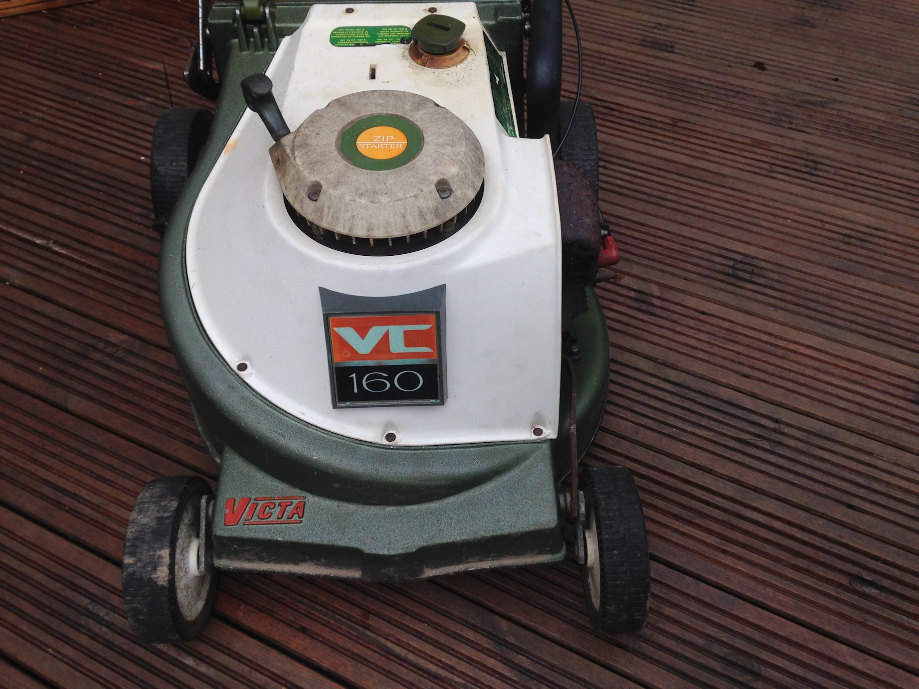

The Auto Drive lettering may have faded ,the underside of the starter is a good
colour match.

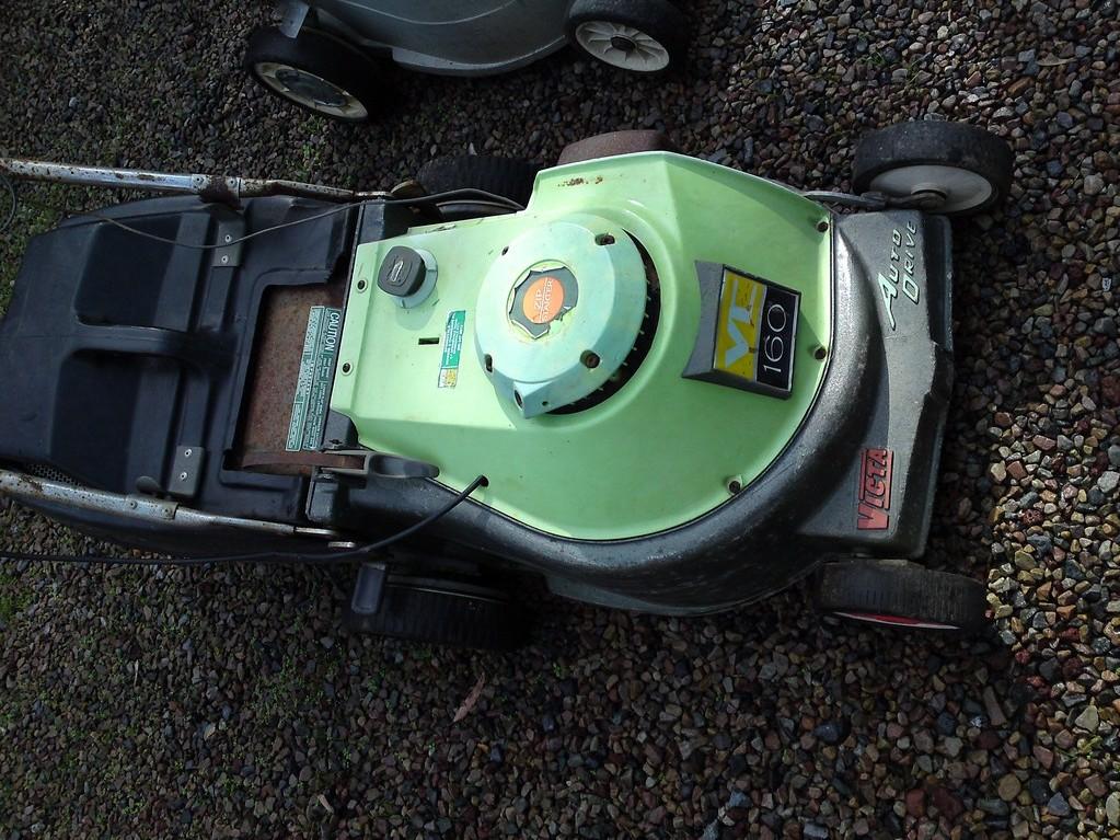

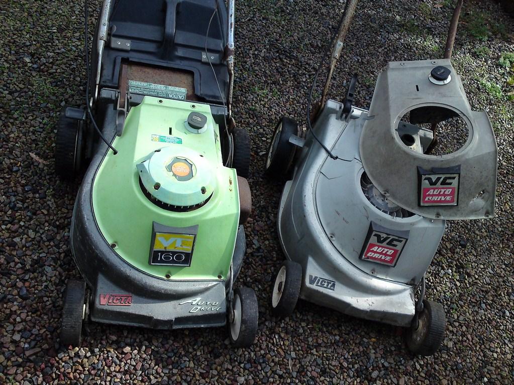

Managed to find another machine, a VC160 Mk2..??
I can probably only count on one hand the number of these I have seen on ebay over the last couple of years. There is not too much wrong with it but, although it runs really well (I cut my lawn with it when I got it home).... sadly, and I say this with a heavy heart, I am going to have to use a number of the parts from this for the Auto Drive.
https://www.outdoorking-forum.com.au/forum/uploads/3741.jpeg
https://www.outdoorking-forum.com.au/forum/uploads/3740.jpeg
As you all know I desperately need the dress cowl in particular (fortunately it has a really good one). I also need the snorkel, throttle lever & cable, air filter housing and several other smaller parts.

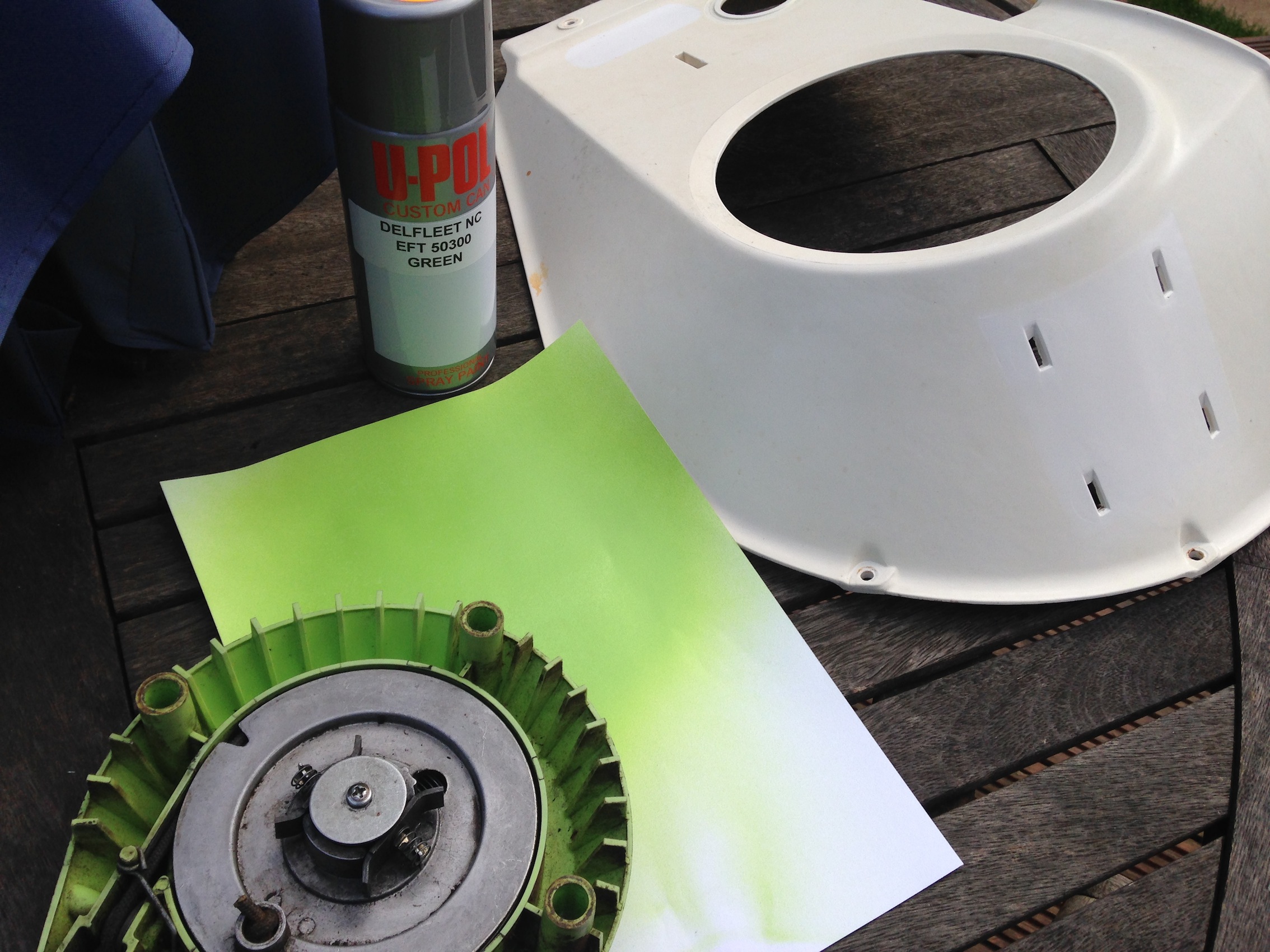

Well, I took the zip starter to the paint shop yesterday and got some paint mixed that was matched to the underside of the starter (as kindly suggested from Maxwestern & Mowerfreak). I had second thoughts in the end about getting a colour that would be somewhere in between the top and bottom of the starter and I really hope it turns out ok as it really does look "very green"..... it wasn't cheap either..!!
https://www.outdoorking-forum.com.au/forum/uploads/3742.jpg
I need to get some plastic primer next as it was ridiculously expensive at the paint shop, then I suppose I will be ready to paint the cowl.
One question though, would you guys recommend putting a petrol resistant clear coat/lacquer over any painted parts like this when its done? I don't want it to look glossy as I don't think it would have been like that when it was made?
