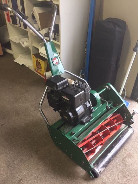

I have seen another one with a b and s 3.0hp black engine on it.
Were the 33's sent out new with these engines on them or is it definitely non factory.
Also is there anywhere that could supply a catcher for the 33, or anywhere in perth that could make one?
Evo
Hi Evo
Yes, not factory - but a replacement.
To my knowledge, Model 33s were fitted with Villiers 2-strokes or 4-stroke BSAs, or Kirby 4-strokes.
They were not fitted with B&S engines.
