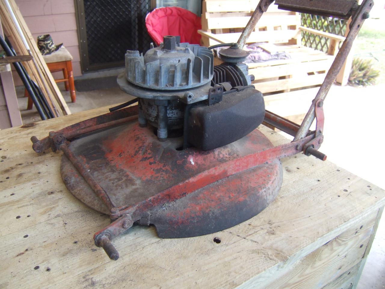

I did a computer job for a friend.... I mentioned ODK and he said he got rid of all his mowers, only a toecuter he was going to put in dumpster......
Now I have another project, good comptession.... a decompressor so it can't be that old. Maybe a 125cc.
speedy
Joined: Feb 2006
Posts: 4,675
Likes: 165
It's a 160cc going by the spark plug position and decompression valve. It needs the fan replaced too.
The red toe cutter base and decompression valve ( zip start) combination places it as an early 1970s utility model.
Hope you find the necessary bits to get this back on the road. Nice model.
Yup. Through studs on the barrel make it a 160cc, serial number says 1974 model year.
Edit: So the VictaCode No. will be V144 or V168.

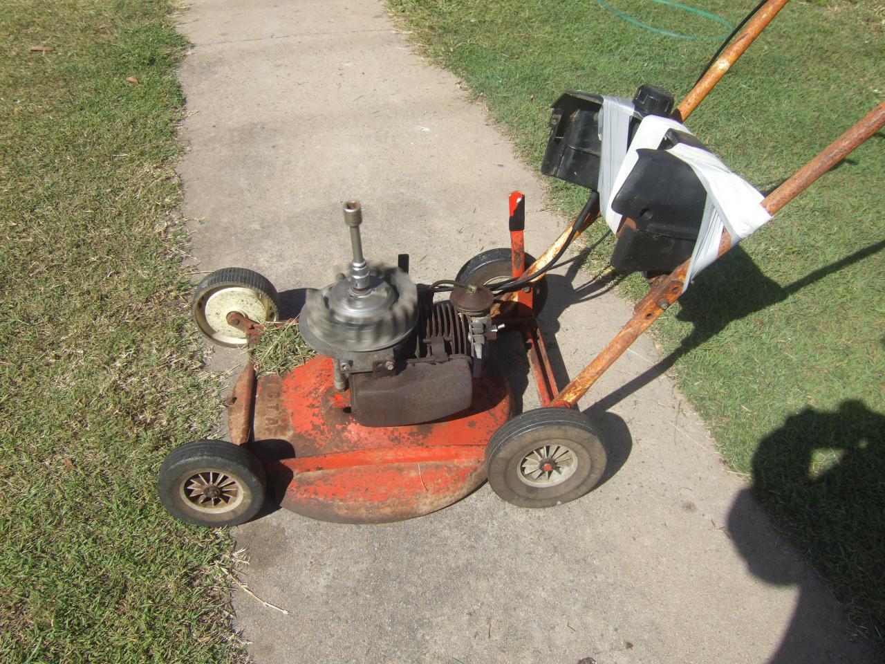

I greased the axles, faced and adjusted points. put a carb cable on bodgied a fuel tank.
It started after a few turns of the electric drill.
But the socket and shaft stayed on the mower, so I did a few runs of the front lawn.
Good power little smoke, now I'm ready to disassemble it into the mollasses bath......
speedy

smile Nice capture of the running engine.

I just had to mow the backyard, I needed a snorkel as was sucking in grass.....
Started easily with the Sidchrome/Bouch easystarter I made.
That govener must do something but it ran ok..
It messed up the guy next doors TV.... then it came good.....
I mowed lawns for 7 years when I was young and still don't like catchers......
I think I wil paint it orange with white handles...
speedy
