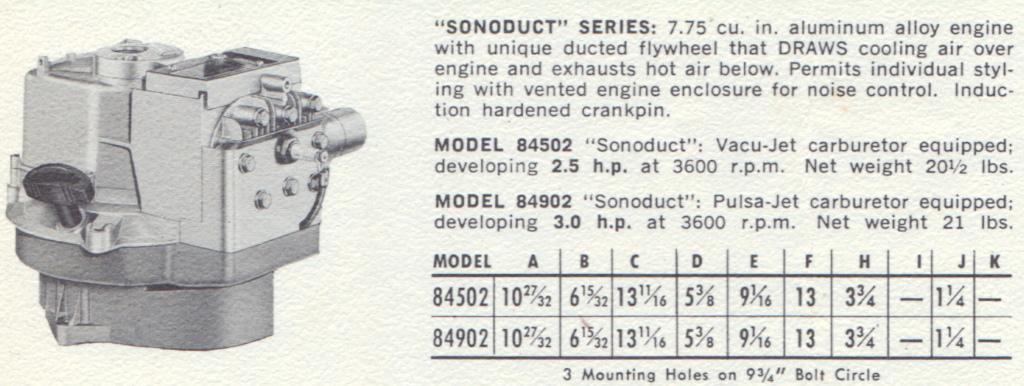

The Briggs & Stratton Sonoduct Series of engines were revolutionary when
introduced in 1960. They were a commercial flop ... in the vain of the Ford
Edsel and the Bristol Brabazon. It wasn't a fault of the design.
Perhaps too radical for the day, the design would prove its worth decades
later, and was a design inspiration to the Victa Power Torque engine. The
radical feature was the moving of the ignition flywheel and recoil starter
to the under-deck.

The name gives it away. 'Sonic' relates to sound. This was an early attempt
to make a quieter engine. A spin-off advantage from this was in styling potential.
Lawnmower makers could make a lower silhouette rotary lawnmower.

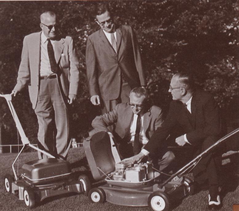

In a 1980s Briggs publication, a brief story is told [with accompanying image]:
" the SonoDuct, a totally enclosed, quiet engine, was in the experimental stage
in 1958 when examined by Ed Oehler, Hugh Brown, Bob Harkness and Jack Ebershoff.
The SonoDuct was unique in that the flywheel was located under the unit rather
than on top. It did go into production, but acceptance was hampered by the fact
that a large, odd-shaped hole was required on the deck to install the engine."

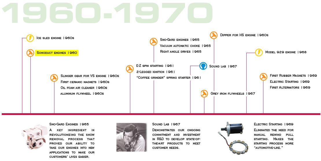

In this extract from a Briggs 2008 publication, the factory lists 'highlights'
from the 1960s. I have used this to date this brochure.
NOTE: Easy-Spin starting and the 'Coffee Grinder' starter appeared
in 1961. Brigg's Sound Lab was operational in 1967. I feel that is a
good indicator of how seriously Briggs took 'noise' at that time.
