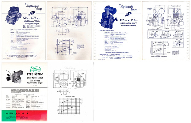

Here is a selection of specification sheets for the horizontals: -
VILLIERS - JAP - LIGHTWEIGHT HORIZONTAL SPECIFICATION SHEETS
