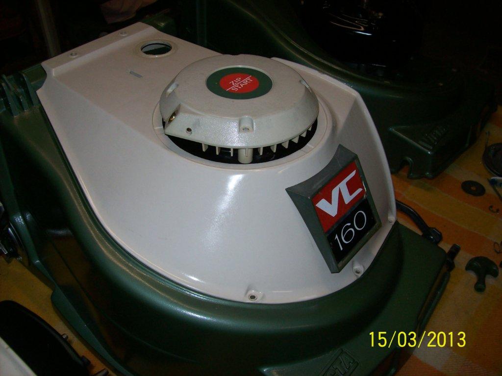

I don't think matching the colour on a computer will work ,the image comes out
a different green depending on background lighting.
I took two images one after the other and got two different shades of green,
what I did find is a Light Green glass deco paint pen is a great match
for the green cowl.
If you paint the green on over the black cowl it will come out a different colour,
you may need a spray putty primer first then grey primer on top of the spray
putty primer then the green.I only mention those steps because if I don't
paint that way the paint is easily scratched off.
The glass deco paint pen is only a good colour match when it is still wet in
the pen,when it dries out it turns a dark green, so if you can find one or put up
a wanted ad for the green pen to colour match at a paint shop it should be a good
match if the inside of the cowl I photographed has not faded.

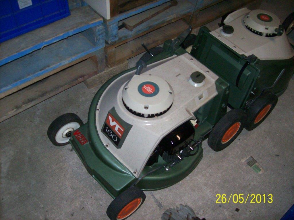

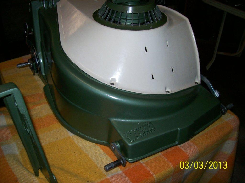

I did wonder if the green paint on the Auto Drive lettering was a match for the cowl (something I can check later) Cheers Max.
Joined: Sep 2015
Posts: 2,727
Likes: 220
SENIOR TECHNICIAN & HISTORIAN
The Auto Drive lettering may have faded ,the underside of the starter is a good
colour match.

Well, I took the zip starter to the paint shop yesterday and got some paint mixed that was matched to the underside of the starter (as kindly suggested from Maxwestern & Mowerfreak). I had second thoughts in the end about getting a colour that would be somewhere in between the top and bottom of the starter and I really hope it turns out ok as it really does look "very green"..... it wasn't cheap either..!!
https://www.outdoorking-forum.com.au/forum/uploads/3742.jpg
I need to get some plastic primer next as it was ridiculously expensive at the paint shop, then I suppose I will be ready to paint the cowl.
One question though, would you guys recommend putting a petrol resistant clear coat/lacquer over any painted parts like this when its done? I don't want it to look glossy as I don't think it would have been like that when it was made?
Alan.
PS, The sample looks a little bit lighter in colour, it was just a light coat of spray as I didn't want to waste too much..!!
