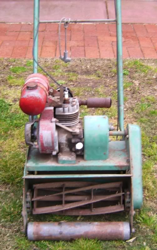

Hello everyone, first post so be gentle
I have just got a SB 40, 14 inch with what i think is a villiers motor on it due to the fact it has villiers on the air filter shroud.
I cannot find any pictures on the net with the same motor set up as i am trying to find the age out on it.
I want my kids to strip, and rebuild it back to as close original as possible but without the pik's i am a little stuck.
Can anyone help?

Fingers crossed see if this works, a bit blurry because the boy took at part of the project.

The engine looks like it could be a villiers mk15 about 147cc, 1.95bhp @ 2,800 rpm, with 47mm stroke and 63mm bore

I think this engine is a villiers 150cc lightweight as it appears
to have an alloy cowl and the f15 engine had a pressed metal one.Both engines have the same bore and stroke.villiers list as
supplying scott bonnar the 75cc and 150cc lightweight engines.
sorry but i dont have any information on the dates rhey were made.

Thanks guys, yes it is a alloy / ally side cover, and the pull cord bolts to this. Has scott bonnar grips too. Villiers on the carb and air filter housing.
The kids want to tear it down, but i want to make sure i know whats what before stripping and painting.
Speaking of painting, is there a paint code for that green and red?

Witht his info We are now thinking 75 cc, and i keep searching the net for one with an identical fuel tank, unless of course the old one rusted out and was replaced with this round item as this is the only real difference from the diagrams, and maybe the pull starter.

hello mik, the fuel tank on your engine is the right one for the
150cc engine.the 150cc has a screw in oil filler and dipstick,the
same as yours but the 75cc has a needle type dipstick which is
located on the top of the crankcase cover, see your parts book.
The 150cc engine should have a on/off switch on the alloy cowl.
the best way to be sure if its 75 or 150 cc would be to remove the head and measure the bore.regards john

It has the screw in oil cap rather than the dipstick, i did notice that, and the carb is just ever so slightly different to the ones in the diagrams.
There is no kill switch on the cowl, you have to earth the HT lead on the head.
I will get the head off this weekend, good excersise for the kids to measure the bore and stroke and work out the cc. I have a feeling it could be a 3 Ltr motor by the time they finish, but it will help with maths at school for volume Etc.

Head off today and it looks like 75cc
51.5 bore
34 stroke plus piston dome
r x r x Pi x S
By reading other post's it looks like the paint will have to be matched, just need to get the kids to schedule the strip down.
