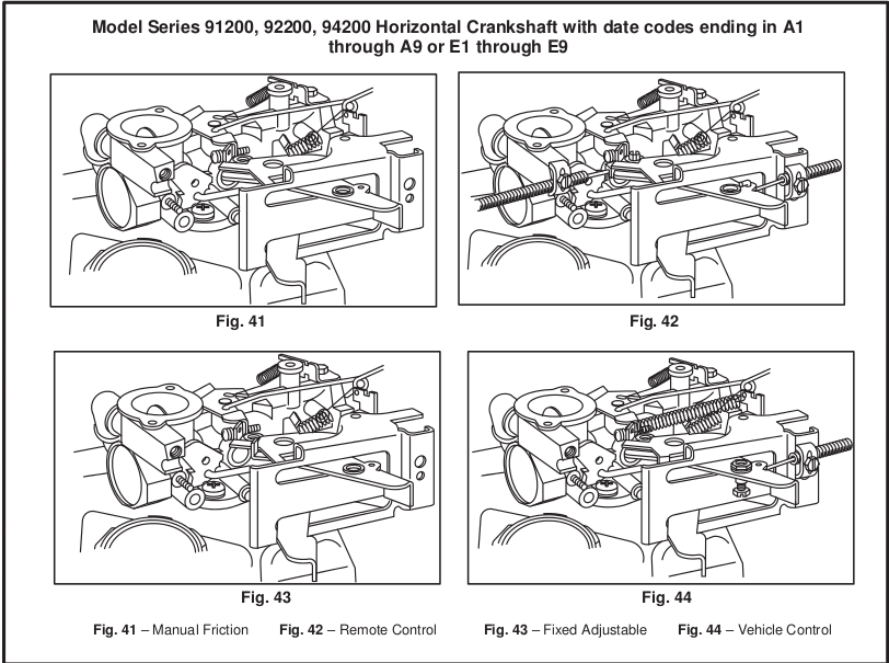

Need Help!! Have a B&S engine with and air vane governor system. Old Carburetor, manual choke. Have no idea how to connect the governor spring/s. Some old photos show 2 some 1, at a loss. Any advise and Pictures would be appreciated. Want to ensure its right.

There will be two springs according to the number.
PN 691289 Governored Idle Spring
PN 691825 Governor Spring (Red)

Thank you as I have two springs. Would you have a pic of their connections.
G'day folks,
This diagram from the B&S L-Head Single Shop Manual should be it;

Perfect done deal my machine now works perfect. Many thanks.....
