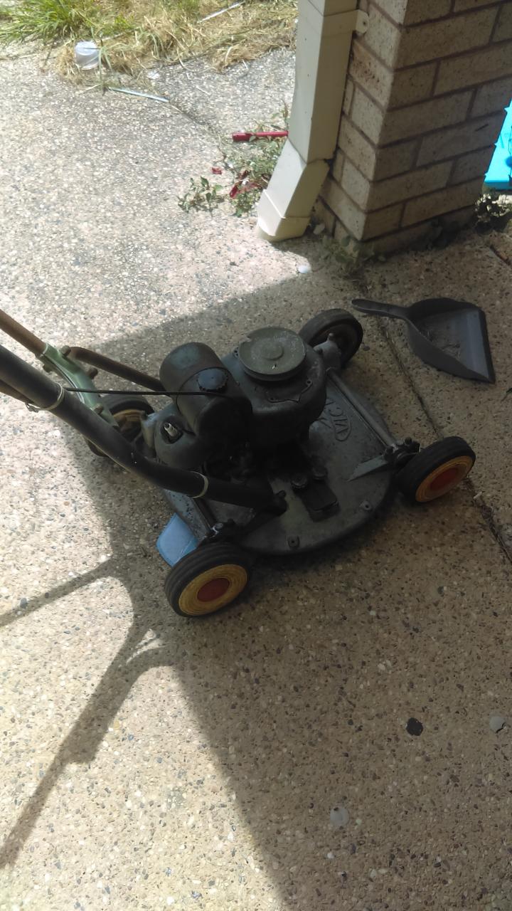

So I have decided not to do a traditional restoration and go with a more custom approach will still go with the traditional green for the base and handles but will have polished brass nuts chrome where I can probably some updated wheels because I don't want to trade my kidney for a ridgy didgy set and what ever else I can think of along the way.

It all starts here a fairly original model 4 wheels are bin worthy cracked and generally worn beyond repair haven't tried to start has good compression though and good spark

Got the old girl running today though as soon as the fuel tap was turned on fuel came flowing out of the primer are there rebuild kits available for these carbies?

Got bored so rolled the mowers out for a few happy snaps

Not as such. NOS needle/seat sets do come up on Fleabay, and they are the main wear part for these old 3F/3L carbies.
Apart from that, the only parts which generally need replacing are the 4 fibre washers.
Repair guide download: https://www.outdoorking-forum.com.au/pages/Victa/Carby%20Information/G3%20Carby/G3%20carby.pdf
Floats do sometimes spring leaks and sink over time, but are usually repairable with soft solder after you get the fuel out.
