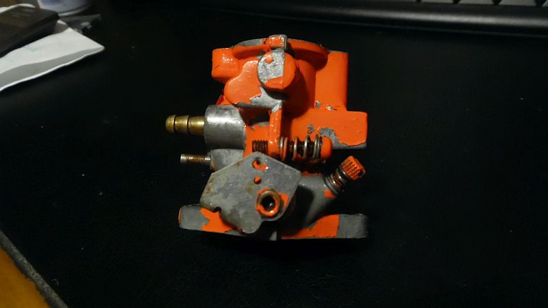

Yup, you have it. Here's a pic of one, from a past thread:
It doesn't need to be that good a spring steel - a piece of steel pallet strapping would work.

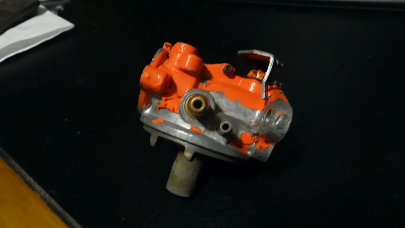

On the carby needle seat question, if it doesn't have an external hex or driver slots, it's pressed in. That means it can't be removed without wrecking it, as far as further use goes. What does the conical tip of the needle look like, condition-wise?

To answer your question...yes...it looks like it is pressed in and unfortunately there is a concentric wear ring on the Needle Valve tip.
That being said...and to your knowledge...has a pressed in Needle Valve Seat ever been 'drilled out and a new one pressed back in?
Oh...I will now say that you must've read my mind...my next question was..why is there a plastic hose pointing upwards from the same place the Main Fuel Line enters the carby..taadaa...a Primer bulb connection of course.

As far as those primer bulbs on the Kirby engines are concerned they are a bit of a waste of time as Kirby's usually start first or second pull once the petrol tap is placed in the open position.
