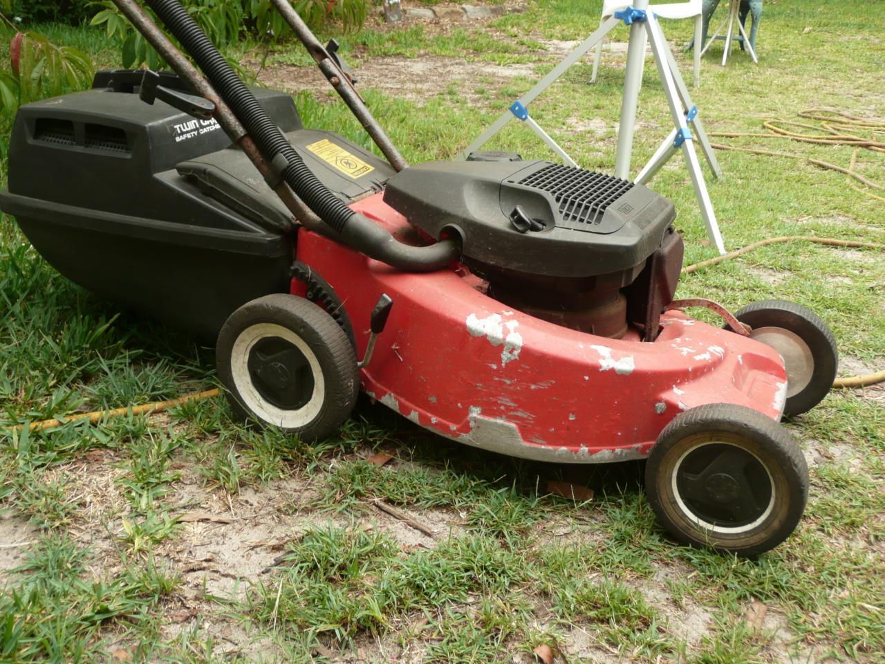

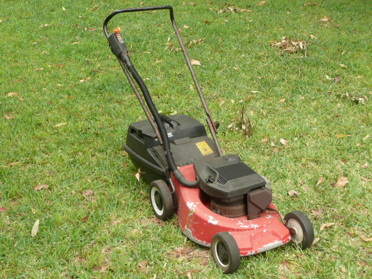

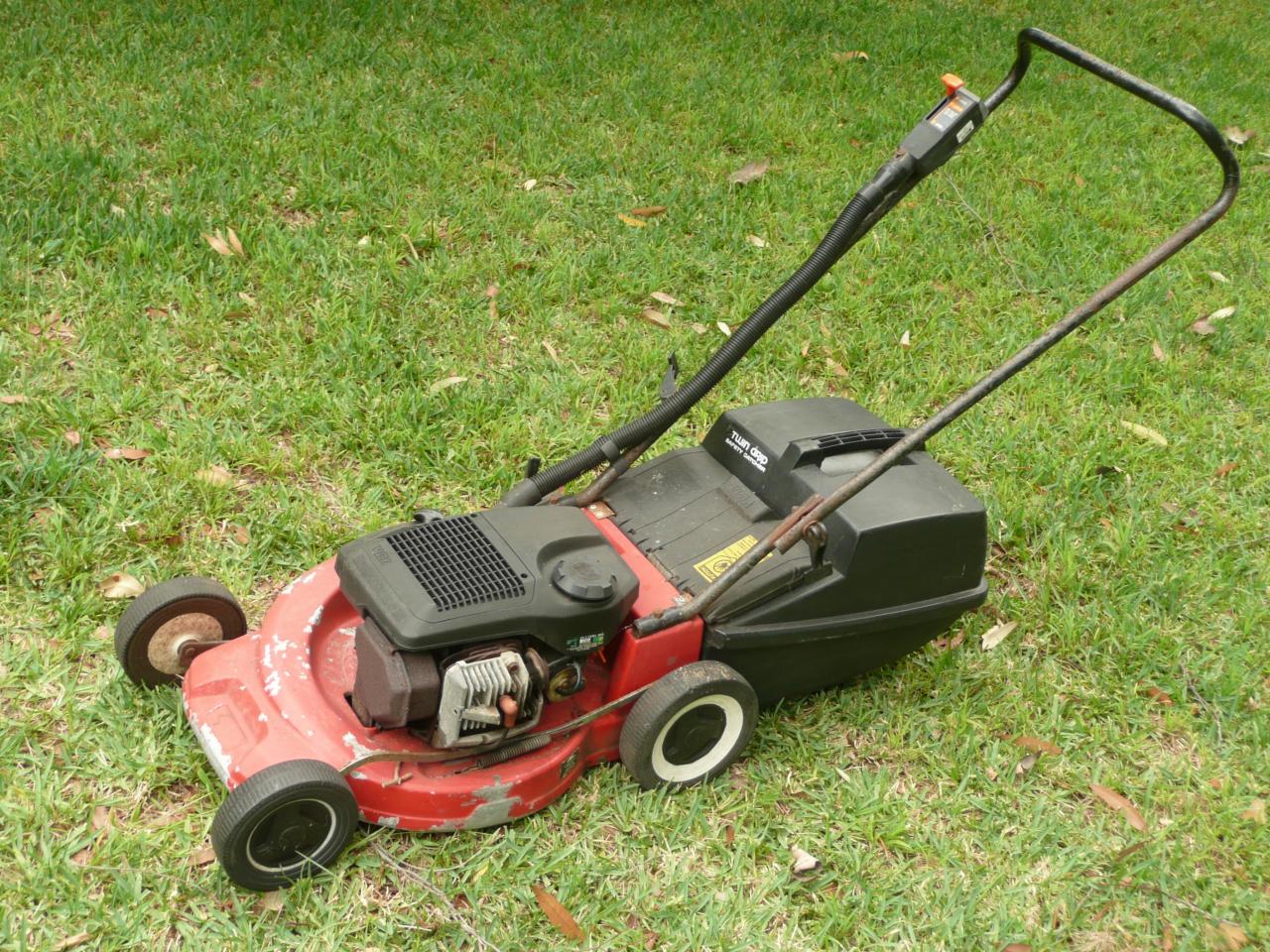

NormK #81637 23/01/17 09:34 AM
Joined: Feb 2006
Posts: 4,675
Likes: 165
Here's one I had until over a year ago. I have owned one other with a beige frame.

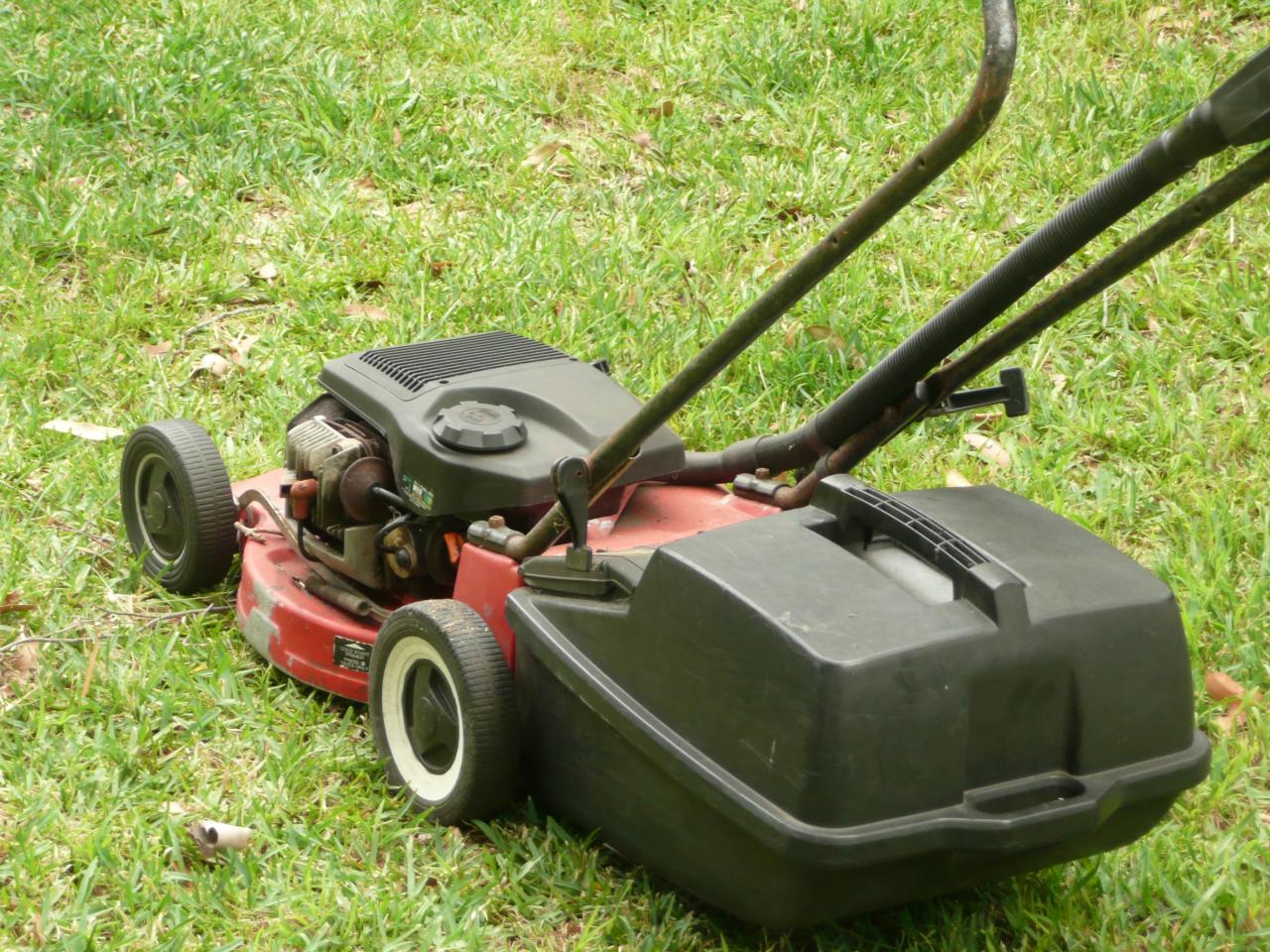

NormK #81830 27/01/17 08:15 AM
Posts: 8,216
Another interesting bit of trivia if anybody is interested, I have a solution for anybody struggling to find a catcher for a high arch alloy Victa. If you rivet a Rover rear catcher door to the existing door, a Rover catcher fits very nicely, problem solved. Seems a pity to dump the alloy bases because of no catcher when the motors are so rebuildable
