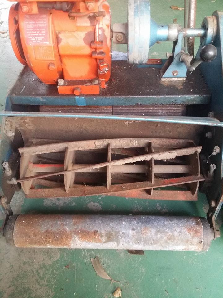

Hey Guys looking to restore my Scott Bonnar Lawn King and get some infor on the model? .I have never done anything like this so some help would be great. Where do i start? Do i just pull it all apart and clean every inch? Also how hard is it to service the Kirby motor and put a new cord on it? cheers guys.
Nothing is going to hit as hard as life.
Hello LawnKing,
I can't believe all the sudden Scott Bonnar interest in South Australia, it's incredible.
The machine you have is the Model 33 and the later variant as it was manufactured along side the model 45 in its early days of production. Your machine was actually built in 1971.
As far as the Kirby engine is concerned the starters are rather easy to change the rope in but it really is one of those jobs you need to experience yourself from pulling it apart as it's rather hard to explain.
The Kirby engine itself is a good engine, but their carburettors are rather finicky with the wear on the butterfly shaft being the major culprit. There are basically no parts available for these carburettors which certainly makes life difficult.
The best advice I can give you is to get it going engine and transmission wise reliably and once satisfied then I'd strip it to get the end result you want. No point in doing all the work and then find major issues that can't be resolved economically.

Thanks for your help. Yes there is a bit of a Lawn Movement in SA at the moment its great. I picked up the Lawn King off gumtree about 6 months back looking for a little project for myself.
The motor wasn't going when i got it as the previous owner had it sitting with old fuel in it for 2 or so years. i tried to get it going that's when the cord snapped lol. so i guess my first move will be to put a new cord on it and try to get it running. Im thinking i should clean the tank out first and put new oil in it? Whats the best way to clean out the tank?
secondly is it just worth putting a new B&S on her?
Cheers!

Hello LawnKing and Mod BB
These are great machines.
I appreciate the photos - particularly the maker's plate.
This is a 330026, the second version of the Lawn King line.
This is a SB Model 33 (with mods) that sold alongside the Model 45 in the
early 1970s.
I would love a photo of the drive train.
I'm guessing this is an all chain drive (with no belts).
You are in good hands with Mod Bonnar Bloke.
