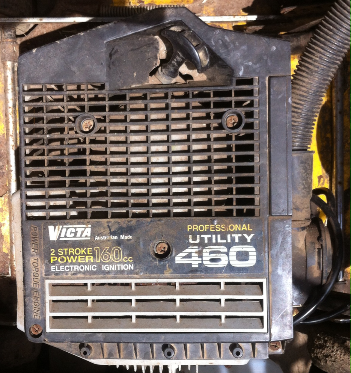

Are the current Victa 2 stroke engines as good as the early 2000's engines?
I have heard people say they now use plastic parts.
However, are they just meaning that they have a plastic carburettor, which has been around for some time?
Joined: Nov 2016
Posts: 56
Victa obsessed
No, the new ones are Not even made by victa now, the production of them is licensed out to a company in Adelaide. The way To tell them apart is on the proper victa ones, the fins are thinner and closer together, but on the newer ones, the fins are MUCH thicker and further apart.
Joined: Jun 2013
Posts: 407
LRT
Offline
Thanks, are the new Victa's 2 strokes worth buying still?
Posts: 8,117
Likes: 231
The 2 stroke Victas ceased production earlier this year due to non compliance with emissions. All Victa did, apart from manufacturing them in China with the difference as Totally mentioned, was change the plastic top on the motor to make them look like a new model. They also changed the ignition by removing the ignition module. Both ignition types are extremely reliable. Motors are so tough but the carbies can be troublesome but can be sorted. As for buying a new one, whatever suits you, depends if you want to fix an older one up. Only other thing is the steel bases are prone to rust out on the top left hand corner, I clean them out and paint them with fish oil up in the rear area in an attempt to slow the rust. The Chinese bases seem to rust out quicker, probably due to lack of rustproofing at the factory. Not a bad run for a motor to start production in about 1984 till 2016 with only cosmetic changes to the engine cover to give a new model appearance. The base and catcher remained unchanged the whole time, I guess if you get it right, why change it. My opinion is it is the best small engine ever designed and built.

Thanks Norm. I also have a c1990's Victa that out performs the bigger 4 stroke self propelled mower in heavy grass. Although its noisy compared to a 4 stroke, it does the job so much faster without having to let the engine recover. Caleb
Victa still list four professional and one domestic 2-stroke models on their website. I dunno if their Adelaide contract assembler has ceased putting the engines together yet, but the writing was big on the wall, early this year.
New national emissions standards for small engine equipment, now due to commence in 2018, will spell the end for sure.
Victa outsourced the casting and machining of the PowerTorque blocks to China some time before 2000, so any later engines were assembled here only. The earliest Chinese blocks had a few QC problems, IIRC.
As said above, the simple way to spot which block you're looking at is the spacing of the cylinder fins. Comparison pic is HERE. The Chinese block engines do seem to be more prone to overheating, not surprisingly.

Thanks Gadge,
Judging by the fins in the link you gave me, this one looks like an Aussie one.
