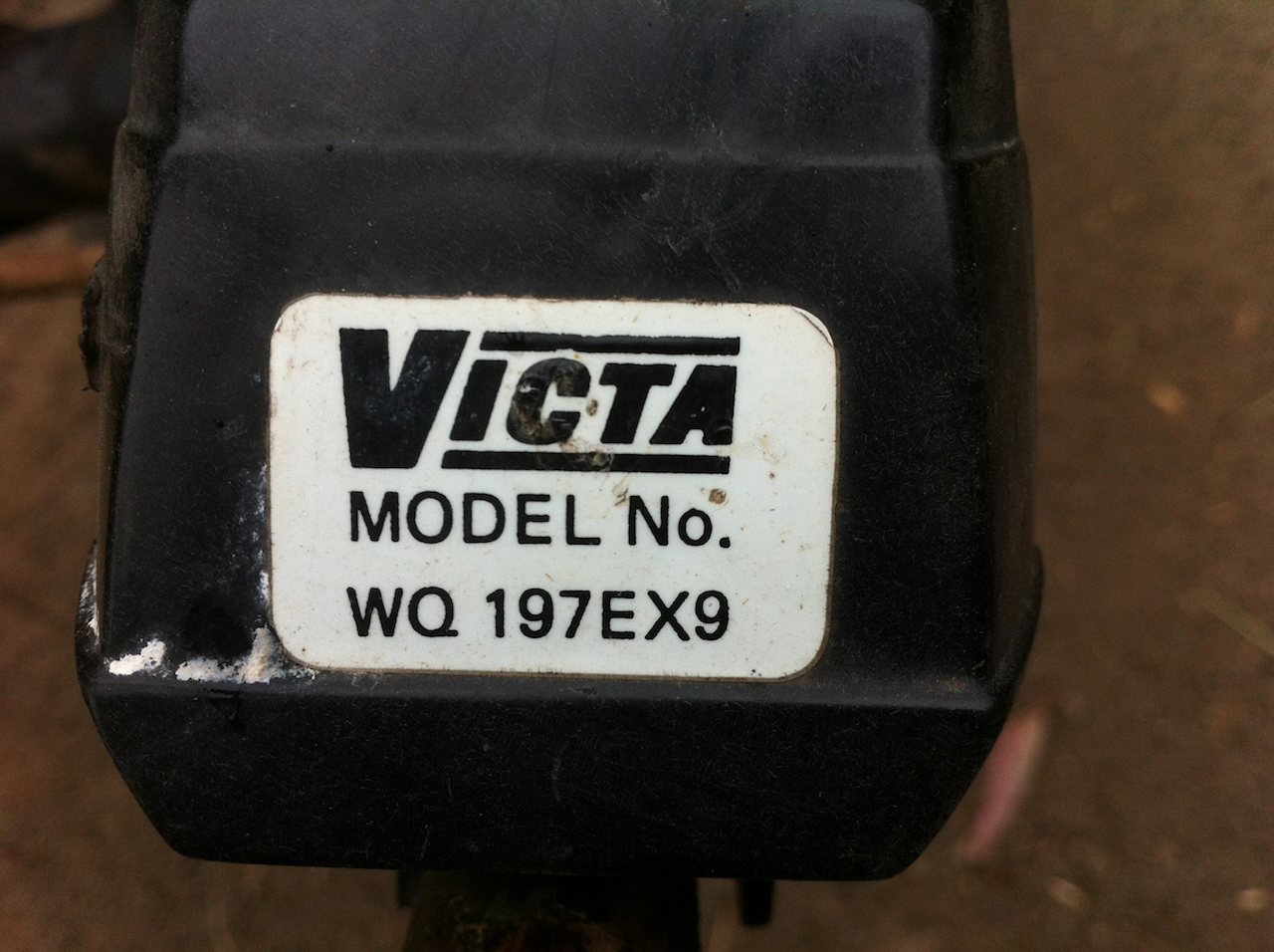

What year would this Victa Professional 550 be?
The model number on the air filter is: WQ 197EX9

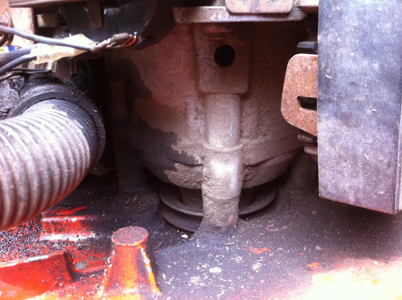

When turning the engine over, it looks as though it has a bent crankshaft.

those motors used a longer crank than a regular 18" engine, what makes you think the crank is bent?

When turning the engine over, the flywheel and centre of the shaft has a pronounced side to side wobble. There is no side play as if the bearings have worn.

fair enough, they are simple enough to strip and rebuild,
does the height of the blades vary on rotation ? ( from side to side )

No there isn't any noticeable height difference between the blades when they are rotated. Can you still get piston rings & the magneto from Victa?
G'day LRT, and a warm welcome to the ODK Forums.
From that model number, it's 86-87 year of manufacture; it's actually the 'Pro 550 Self Propelled' model. One of the very last of the full-crankshaft Victas; most of the model range had gone to the half-crankshaft PowerTorque engine by then. So it's the original engine I'd say, and no, a PowerTorque won't fit it.
