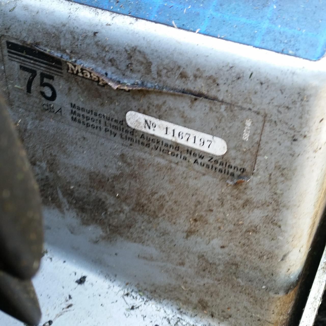

There were a couple of stickers which had the following numbers
YBSXS.190VC 2743543566 and 1167197

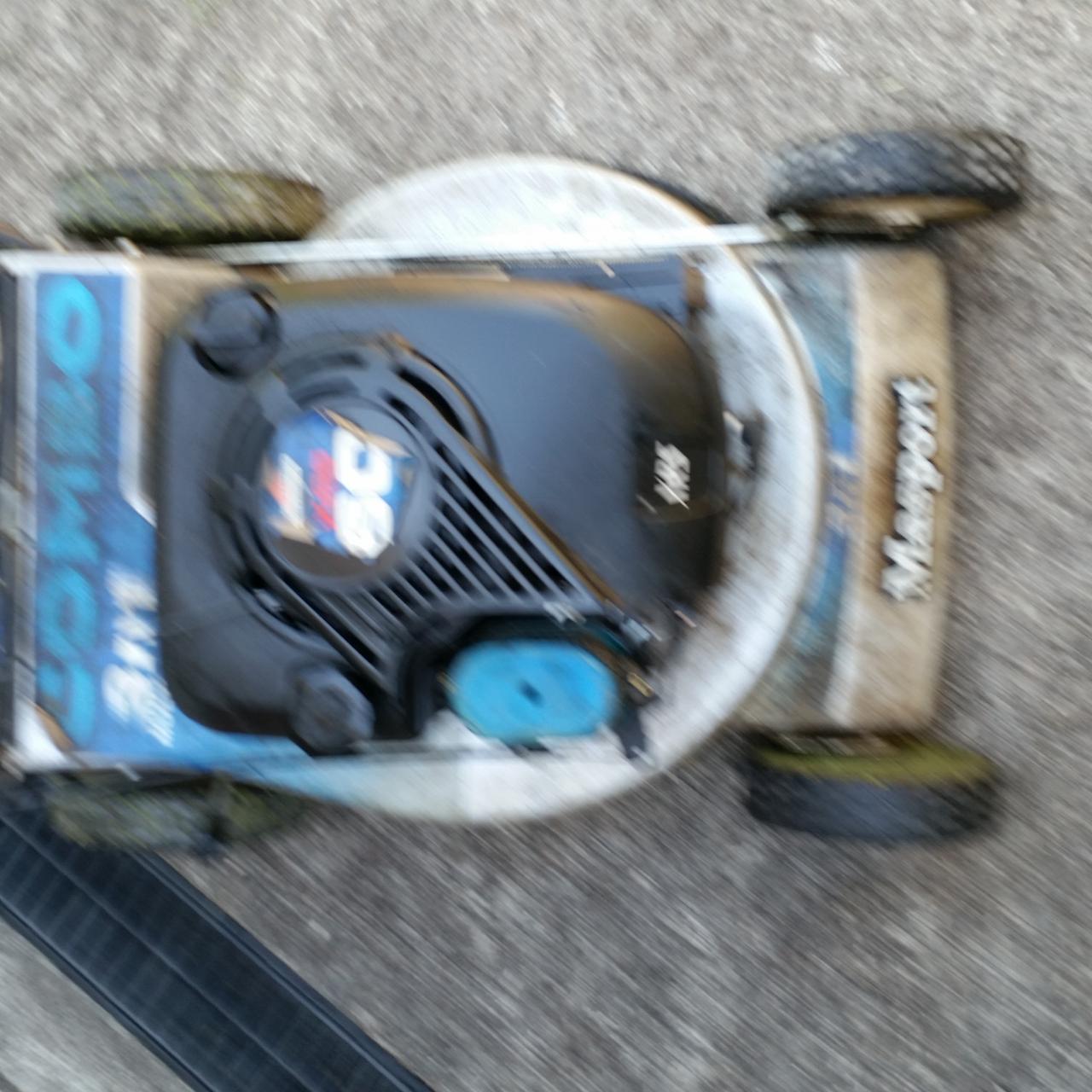

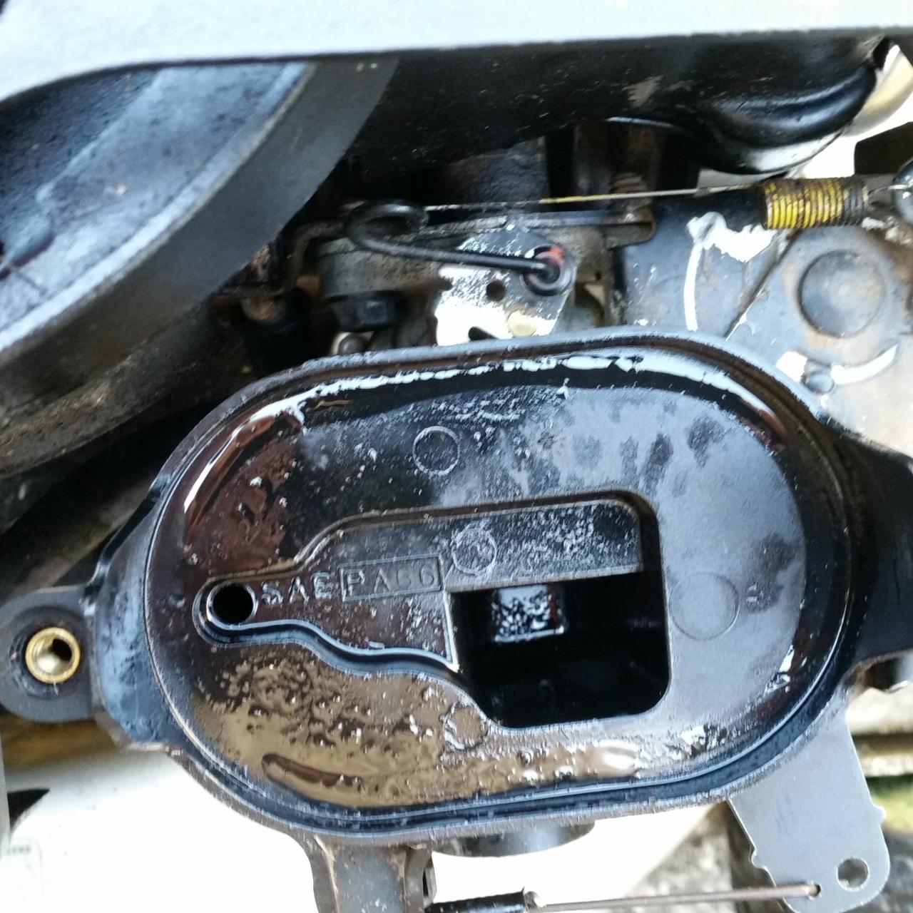

These are a few pics from around the mower and one from the carby and linkages. It seems from watching a few videos Ive not set the governor up correctly so will sort that out and see if it fixes the problem. (apologies for the blurred one...no idea why but it will give an idea of what sort of mower it is at least).

Adjusted the governor correctly and the mower is fine. It seems to leak a bit of oil from around the seal of the filler pipe, but that's just a poor design fault and I will replace the seal if it gets annoying. Needs a new air filter to complete the job and the mower will be good for a few laps yet.
