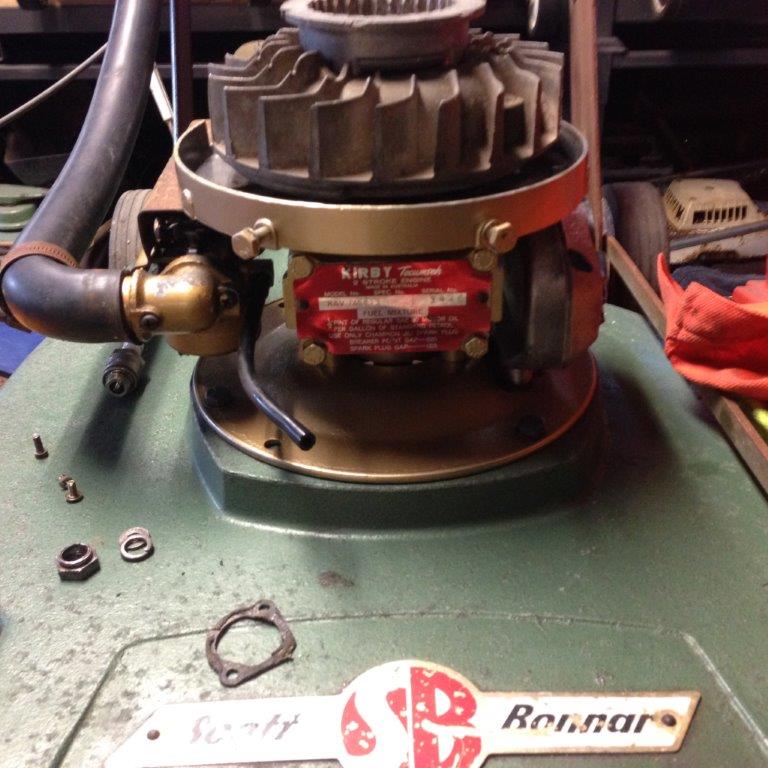

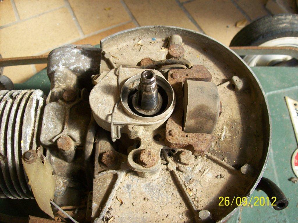

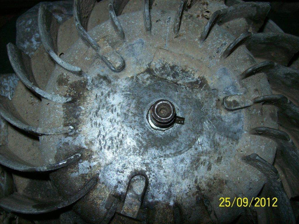

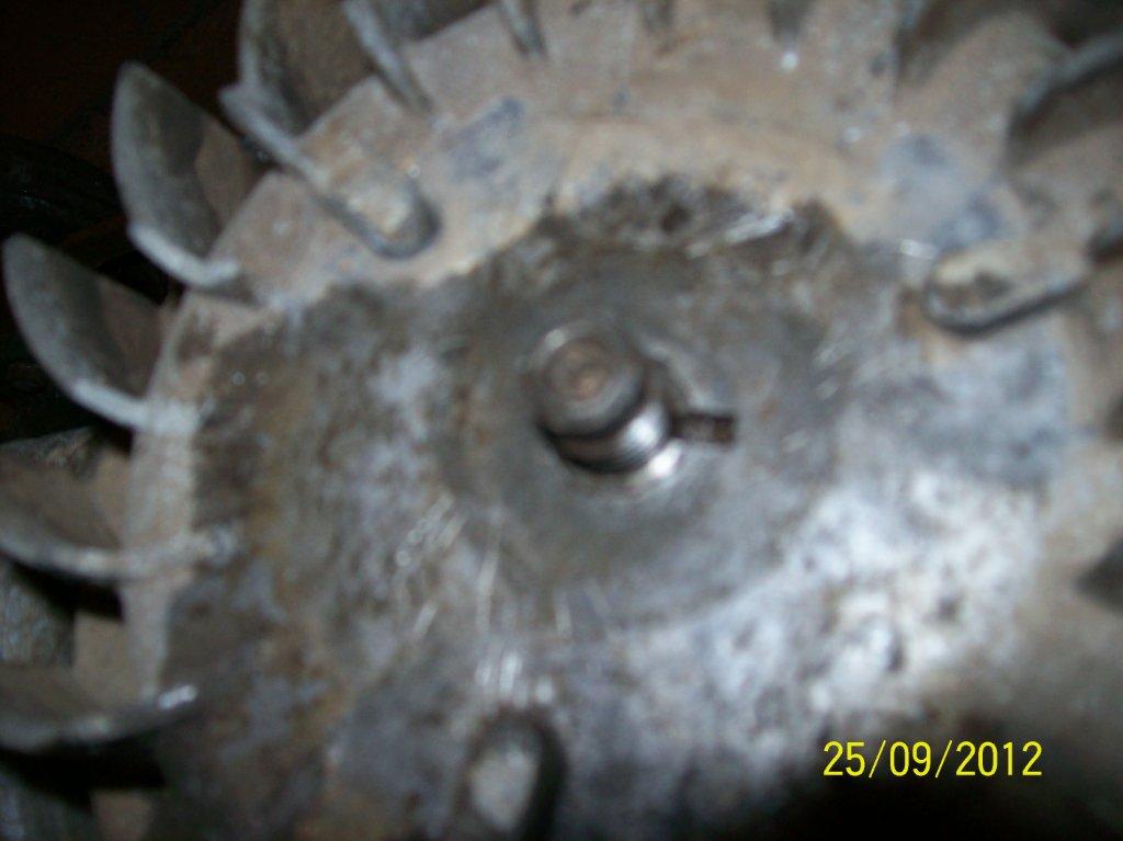

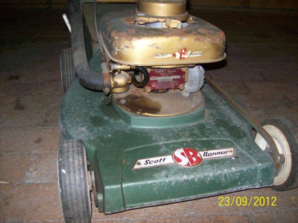

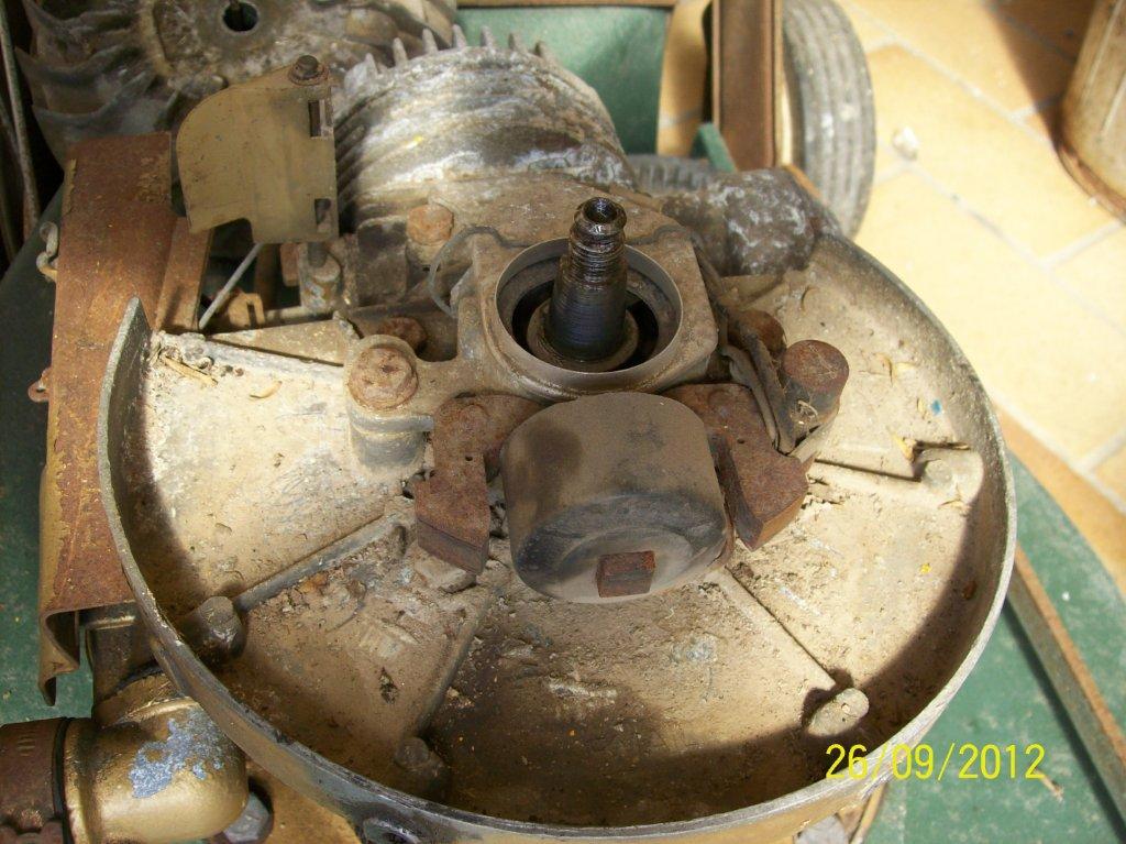

In between looking for a job I started work on this old girl.Already found a problem.It looks like somebody has some problems with the nut that holds the starter cup-flywheel on. ![[Linked Image]](https://www.outdoorking-forum.com.au/forum/uploads/usergals/2012/09/full-5048-7913-102_0124.jpg) As you can clearly see some tool has put wire,yes that's right electrical wire under the nut to try and hold it down and tight. Of-course it didn't work. ![[Linked Image]](https://www.outdoorking-forum.com.au/forum/uploads/usergals/2012/09/full-5048-7914-102_0125.jpg) This second photo didn't turn out real good,but what they have done is tried to get the flywheel off by tying to prise it off and snacking the top of the crank.Only burring the top of the crank.Then decided hey this isn't working so lets put it back together.In that process they have crossed threaded the nut.Gladly I can say I believe it is save-able.Not the nut the nut is trashed,I will need to file the top of the crank to get rid of the burr.I would be interested if someone had another flywheel there is some damage.I could still use it but another good clean unbroken one would be better.Then again I haven't got the flywheel off yet maybe it wont in one piece.Fingers crossed for that one.Will keep you all updated. ![[Linked Image]](https://www.outdoorking-forum.com.au/forum/uploads/usergals/2012/09/full-5048-7915-102_0126.jpg)

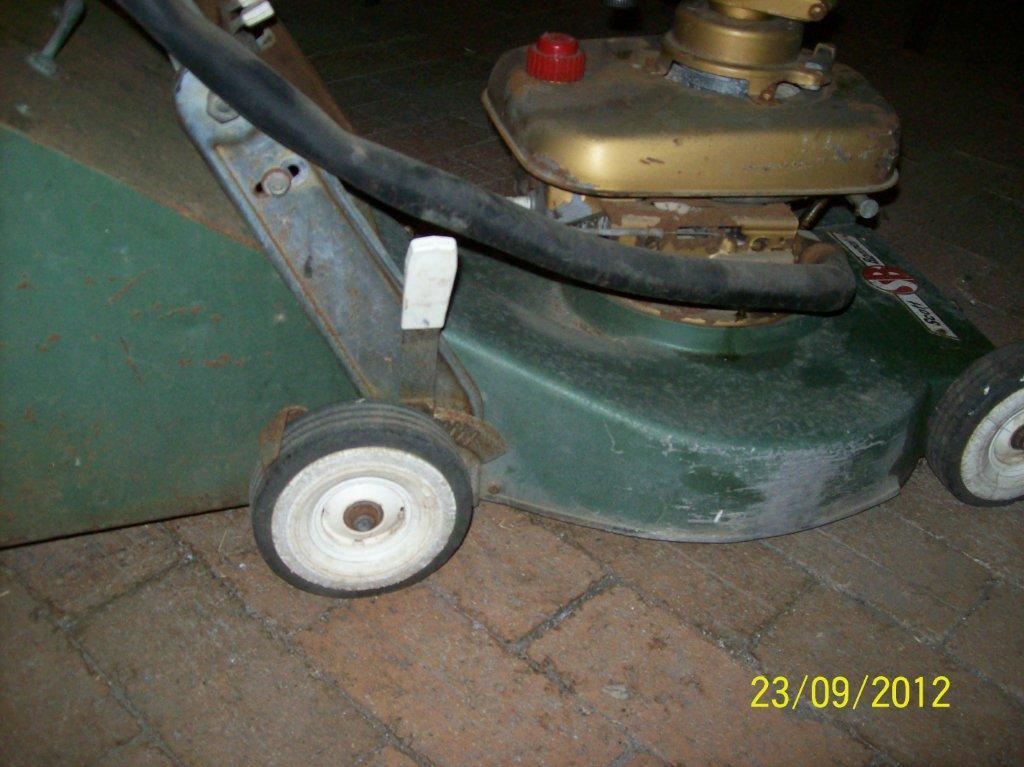

is that a kirby 2stroke ? if yes fast grass might get excited n help with some bits . sorry though no luck with wheel caps for it but i'll keep looking .. cheers , Dave
Posts: 4,291 Likes: 4

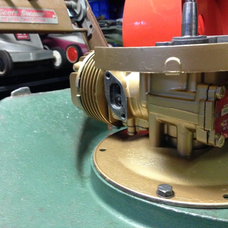

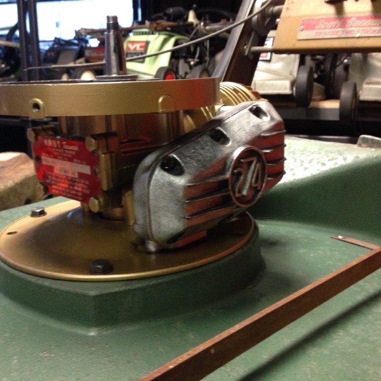

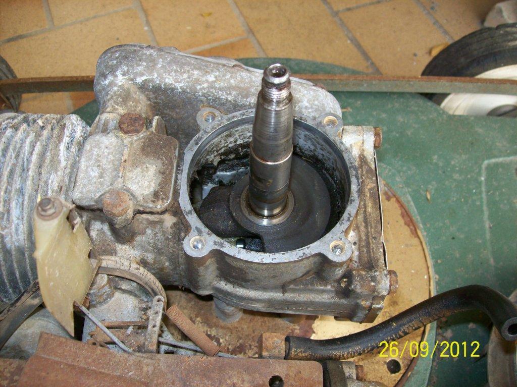

Well yeah it is sort off.Here I'll show you what it has on it. ![[Linked Image]](https://www.outdoorking-forum.com.au/forum/uploads/usergals/2012/09/full-5048-7922-102_0127.jpg) ![[Linked Image]](https://www.outdoorking-forum.com.au/forum/uploads/usergals/2012/09/full-5048-7923-102_0131.jpg) So yes I guess it is.
Posts: 2,738 Likes: 6
So much for being a "Victa Only" man!!! I have parts here for that engine if you need mate, maybe even a spare, so when you come back down this way for your car, I'll make sure to have anything you need aside. I also have the workshop manual for that one, so I'll make some copies on my lovley new photocopier  That's definitley quite the find, and the base seems to be in good shape too!

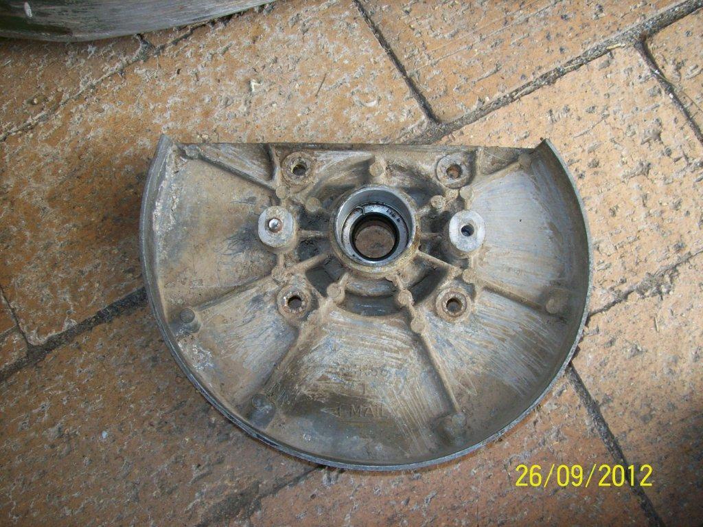

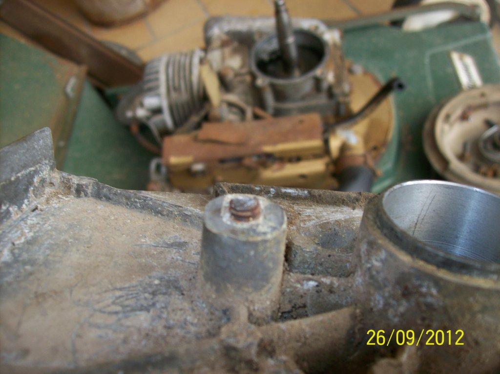

I'll see if I can't find that engine for you tonight, hopefully we can get that plate out of it, if your in a rush for this one, perhaps I should post you the plate.
Cheers Ty
and some spare bolts and starter cup I might end insane from bordem. I know that's really not a word but it's what will happen.
Posts: 1,819 Likes: 6
To get that bolt out. Theres a few options.
Sit the plate on an anvil and smack the bit of the bolt thats poking out hard with the hammer twice. Make sure its supported right under where the bolt threads into and is sitting nice and square. You dont want to crack the alloy.
Another trick would be to whack it in the oven and heat it up, try and crack the bolt while its hot.
Try grabbing whats left of the bolt in the vice and rotating the alloy plate. Take it easy.
If it wont work.
Grind the bolt down flush with the alloy, or even just so the top is flat/square and a little proud. Mark it carefully with a centre punch.
From there you have a few options.
Drill and give it a go with an ezy out. Theres a couple of schools of thought here. Dont go too big with the hole, if you do the metal distorts in the ally as you can put too much force into the steel and spread it. Id say in your case this is the one, the bolt is probably whitworth and they are not hard bolts. Other school of thought it the bigger the ezy out the better as you can get more force. Dont bust the ezy out, they are harder than a drill bit.
Try and get your hands on a small LH drill bit. No Poo, they do exist. When drilling into the bolt, in reverse, if the bit grabs in the steel it will wind the bolt out.
Or if you are set and square, you can drill a small pilot all the way down through the broken bolt and out the other side of the alloy plate, then with a bigger normal RH bit, drill back through from the other way and if that grabs it will screw the bolt out as well.
With reguard to any hole you drill being off centre. Start with a small pilot, then using that hole as the centre guide, drill oversize to what size the bolt was. But you will remove the threads. So in effect you are best to take it out to the size it needs to be to helicoil the hole. Or up to the next size bolt, most times you can get away with this. Trying to drill it to the size that you need to tap a thread in the hole the same as the bolt that was in it, I have found is near on impossible. You need to be super accurate with the pilot hole marking and drilling, and as you drill all thats left in the hole is the threads of the bolt, they can grab, tear and send you off line hogging into the alloy.
The closer you get to the size of the bolt with the drill bit the more likely you are to run off center or it will show you up as being off center and due to the alloy being softer than bolt the drill will pull and hogg into the alloy and make a mess.
Its a pain in the butt situation but there is a way to save it.

Thanks Bob I'll give some of them a go and see how I go.I do like the oven idea.Might try that first.Thanks man.
