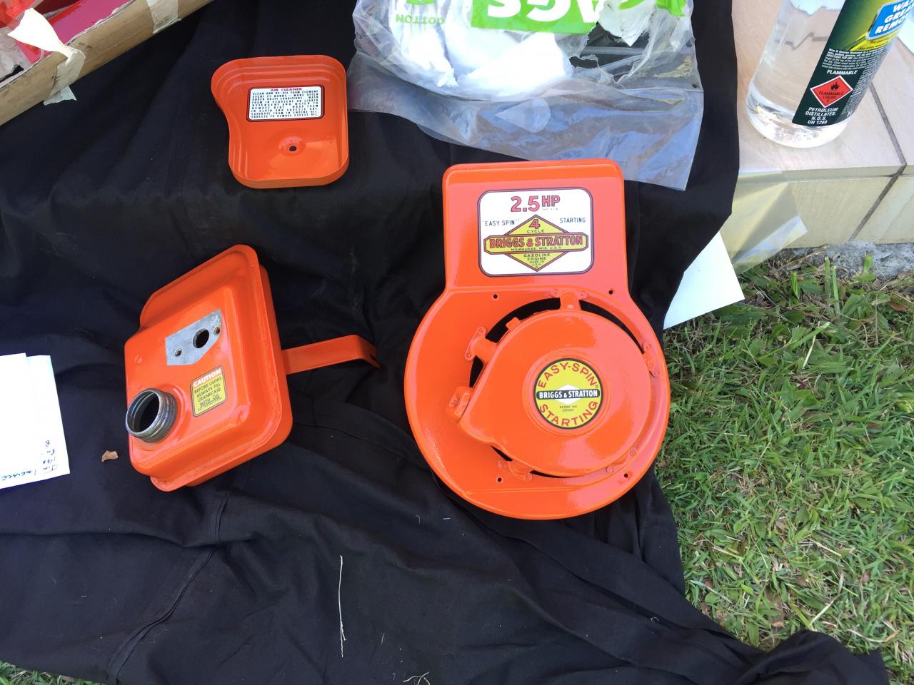

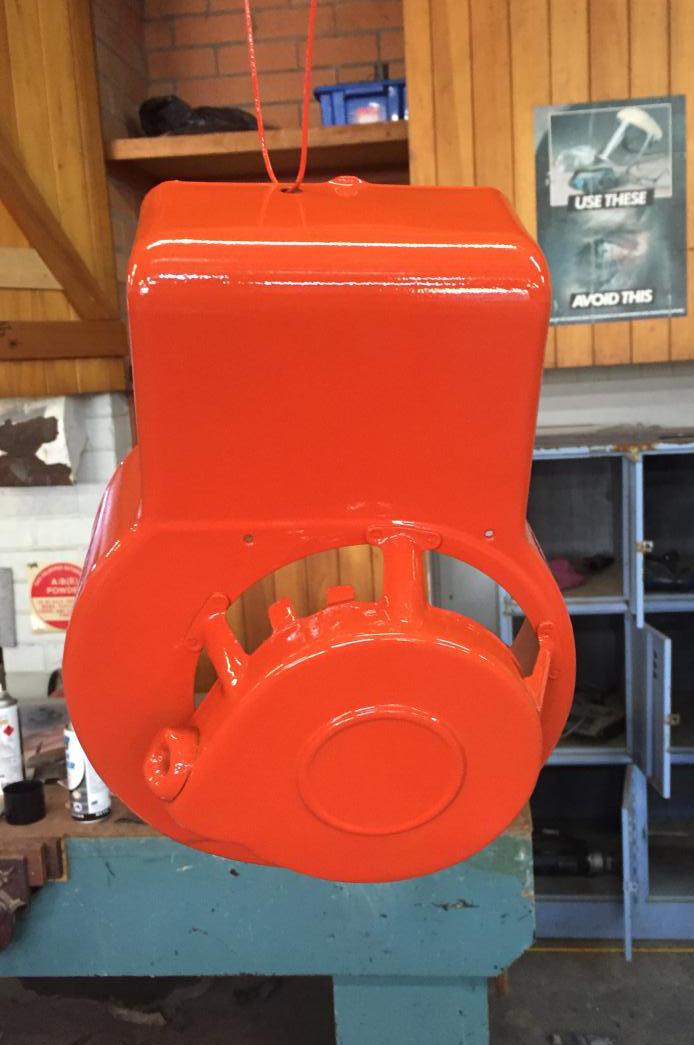

Hi BB,

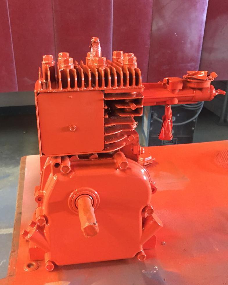

I've been productive and now all parts but 1 are painted (i forgot the little motor stop switch - can you believe it!?!?!).
The orange paint seemed to be quite thick so I added more thinners than recommended, but I still used a lot of paint on the motor and it looks very thick in the photos. Rest assured, I applied very light coats and there are no runs. However, I needed a fair few coats just to get the right coverage.
Here are a few photos of where I am up to:
I replaced the head and carb gaskets and will do the rest upon reassembly. I'm going to have to paint the stop switch and the clutch cone at some stage this week so that it has enough drying time. I'm actually on holidays, so I was hoping I wouldn't have to go into work again until reassembly. Whoops! I also need to paint the handlebars in the chrome paint and then everything should be ready for reassembly next week. The reel and bed knife will go in on Friday (hopefully) for sharpening. I'm starting to create a document with tips from various threads to help with reassembly. There is a lot of information to take in on this forum, that's for sure!
Em
Hi Em,
That colour on all the chassis parts looks absolutely spot on in it's colour match. Yes it's a bit more glossy but that's even better in my opinion.
The engine looks ready to add the extra bolt on parts and thus looks stunning.

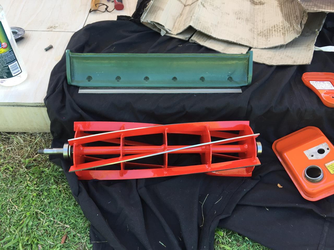

Don't forget to fit new "RLS5" bearings to each end of the reel before handing it over for spin grinding. Ensure the bearings are a tight fit over the shafts and not loose. If they are you'll have to centre pop the shaft surface area upon where the bearing is located using equi-spaced pop marks around the shaft. Then press the bearing over the pop marks which will lock the bearing in place.
I'm going to go out on a limb here and say that this is going to be one of the best restos I've seen in quite some time.
I can't wait to see the photos of the final assembled product, something many on this forum seem to fail to do thus leave us all hanging, but I'm sure you're not going to do that to us here.
PS. Yes that's a good observation in regards to various lots of info being spattered all over different threads. maybe we could publish a full limited edition step by step workshop manual on how to do it from start to finish.

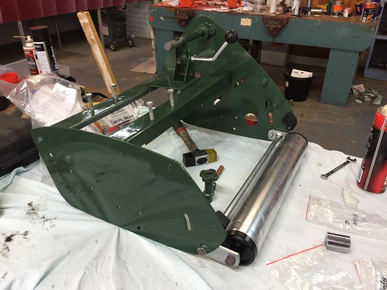

Thanks BB. I need all the encouragement I can get, because I'm feeling a bit out of my depth.

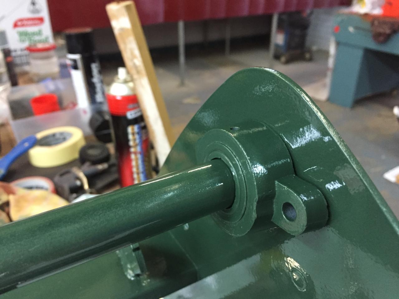

I ran into trouble today when trying to sort out the bearing in the housing pictured below:
I ordered the bearing as pictured in the parts list on outdoorking - but it's not the right one. I believe this bearing is self-aligning, can anyone tell me what type of bearing I need to get? I'll have to have a look at a few local bearings places over the weekend or on Monday. I ordered this bearing , but it doesn't allow the shaft to fit through
Any help would be appreciated. Here is where I'm up to as a lot of the parts are still a bit tacky, so I can't handle them too much....
Will put the rear roller in with new bearings on Monday and hopefully the reel and soleplate will be sharpened by then as well.

Hello emk3,
My advice would be don't put it together until the paint is fully cured, maybe wait a week or so.
You don't want to spoil the great finish on it. If it's tacky you will get finger prints, marks etc. all over it.
I know it's exciting to rush in and put it together but it's best to let the paint fully harden.
So far, well done your machine will look better than new congrats rolleyes
Hi Em,
I agree with what member freebird has suggested and as it's enamel paint without a hardener added it will stay soft for quite some time.
Rushing into it will spoil all your hard work that you've done and as you've probably guessed by now that I've very much supported everything you've done on this amazing rebuild and you wouldn't want to trash it at the eleventh hour.
May I suggest that you put all the Hammertone enamel painted parts outside in the sun for a few days, this will speed up the curring process, especially with the metal heating up and cooling down day in day out.
As far as the bearing is concerned I totally agree with you that it should be a self aligning unit but if I recall correctly Rover in their wisdom decided that a standard bearing was good enough due to cost cutting (I don't agree). I gather you may still have vto original unit that you removed and on that it should have the bearing number on it. You'll probably have to look with a magnifying glass, well I'd have to anyway. Check out "CBC Bearings" as they'd have it. I know it's still available.

Yes that will be the only way of getting a sample to obtain the info. Honestly those self aligning bearings aren't a problem overall as they last for more years than I care to remember as they are not subjected to much shock like rear roller bearings and reel bearings are.

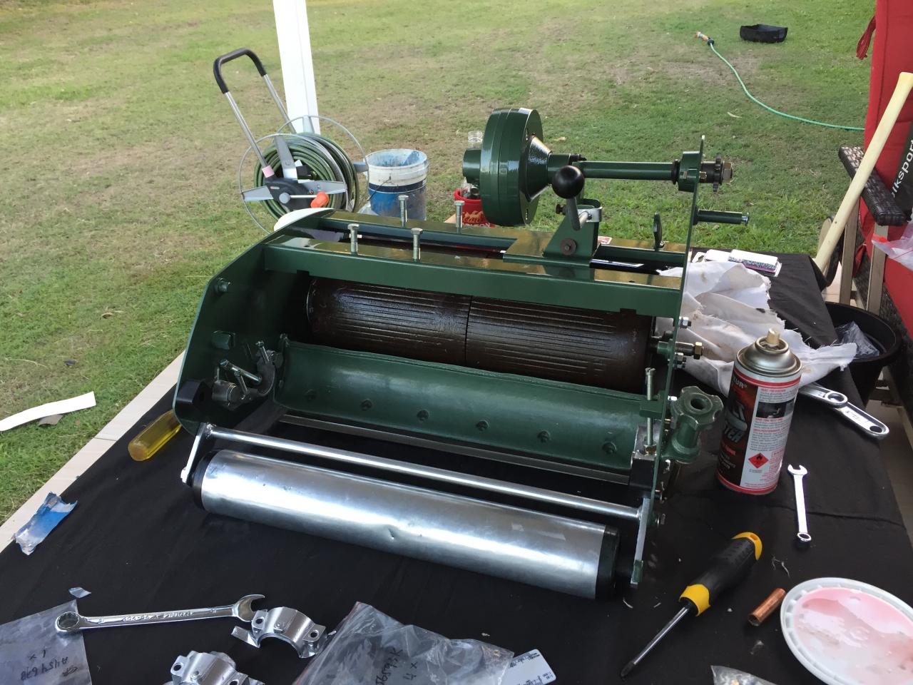

Hi Solman, thanks, but it's really just a temporary solution - I used white knight chrome spray paint. In hindsight, I probably should have just clear coated over it after sanding. I've already scuffed it up a bit on reassembly and I imagine the wear will be terrible once the mower is actually used. I was wanting to get a new stainless steel front roller with bearings as a few of the members here have used on their rebuilds, but I can't seem to locate one either. Apparently they used to be sold on eBay, but there's nothing there now.
BB - I made a mistake - the self aligning bearing situation is sorted. I was sent the right one - blonde moment. Also, out of the 4 SB45's I have, only 2 of them actually had that rubber seal near the housing. Isn't that odd? Anyways, I 'borrowed' one from another mower and have used it.
I tried to replace the rear roller bearings today and they do not fit into the housing (for real this time). I took them to a local bearing place and they confirmed that the old bearing diameter was 37.1 and new was 37.3. They didn't have anything that they could give me, so I'll try another place tomorrow, but I may have to reassemble the rear roller with the old bearings, which is not ideal seeing as though I have now replaced every other bearing along the way. I will, however, dismantle one of the 'spare' mowers and see if the housing is different by any chance.
Will hopefully be able to share some progress photos tomorrow as everything will be ready to go! smile

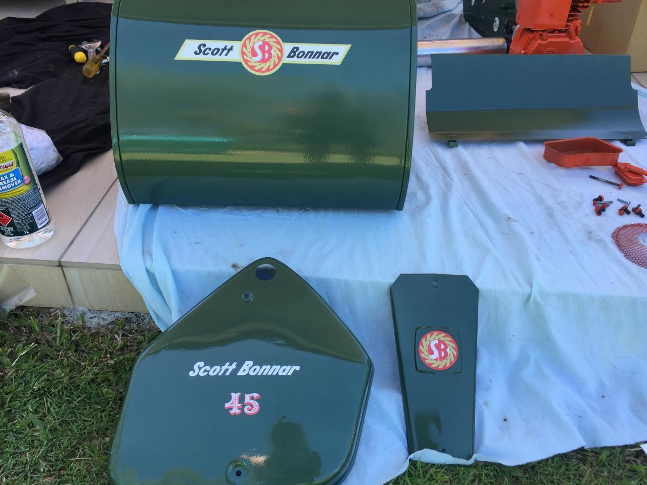

Hi All,
Here is where I'm up to with the rebuild:
I picked up the reel and bedknife today
I also put all the decals on and applied a clear coat to protect them
Hopefully I can adjust the reel to bedknife tomorrow and install the sprockets, etc. Any advice or anything that you think I may have missed?
If all goes well, I may be able to test the motor on Thursday or Friday smile

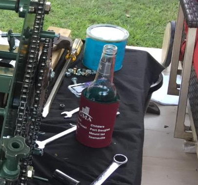

Chains and sprockets on and reel adjusted. How time consuming is the adjusting!! I watched the video tutorial and I set it so that it touched (barely) and backed it off about an eighth of a turn.
Ignore the motor in the photos. I just had it there to hold he clutch and sprocket square in order to tension the chains. I will be working on it tomorrow and then will try to fire it up on Friday. I imagine once (if) I do get if going, I'll have to fiddle around with the clutch cable settings and also the carb adjustments as most of the screws were fiddled with. From memory, it ran really 'fast' or 'high' last time I played with it.
What do you think of the chain tension? There is only a little bit of play in them. I'll grease them up once I know I've got them in the right positions.
Hi Em,
Things are looking superb, the only thing I can pick is that the chains do look a tad on the tight side.
How much deflection are you getting in the centre area of the cutter chain between the PTO shaft sprocket and the plastic tensioner guide ?
Yes it's a fine art to getting it all correct and it's not quite as simple as it seems, but once you've done about a 100 of them you've pretty well much mastered it and can do them in about 5 to 10 minutes.
So is the reel still making contact with the bed knife ?

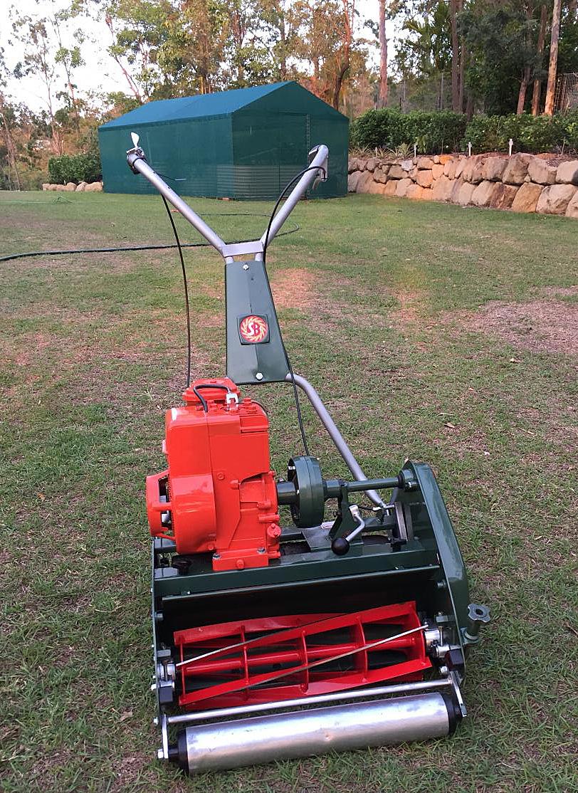

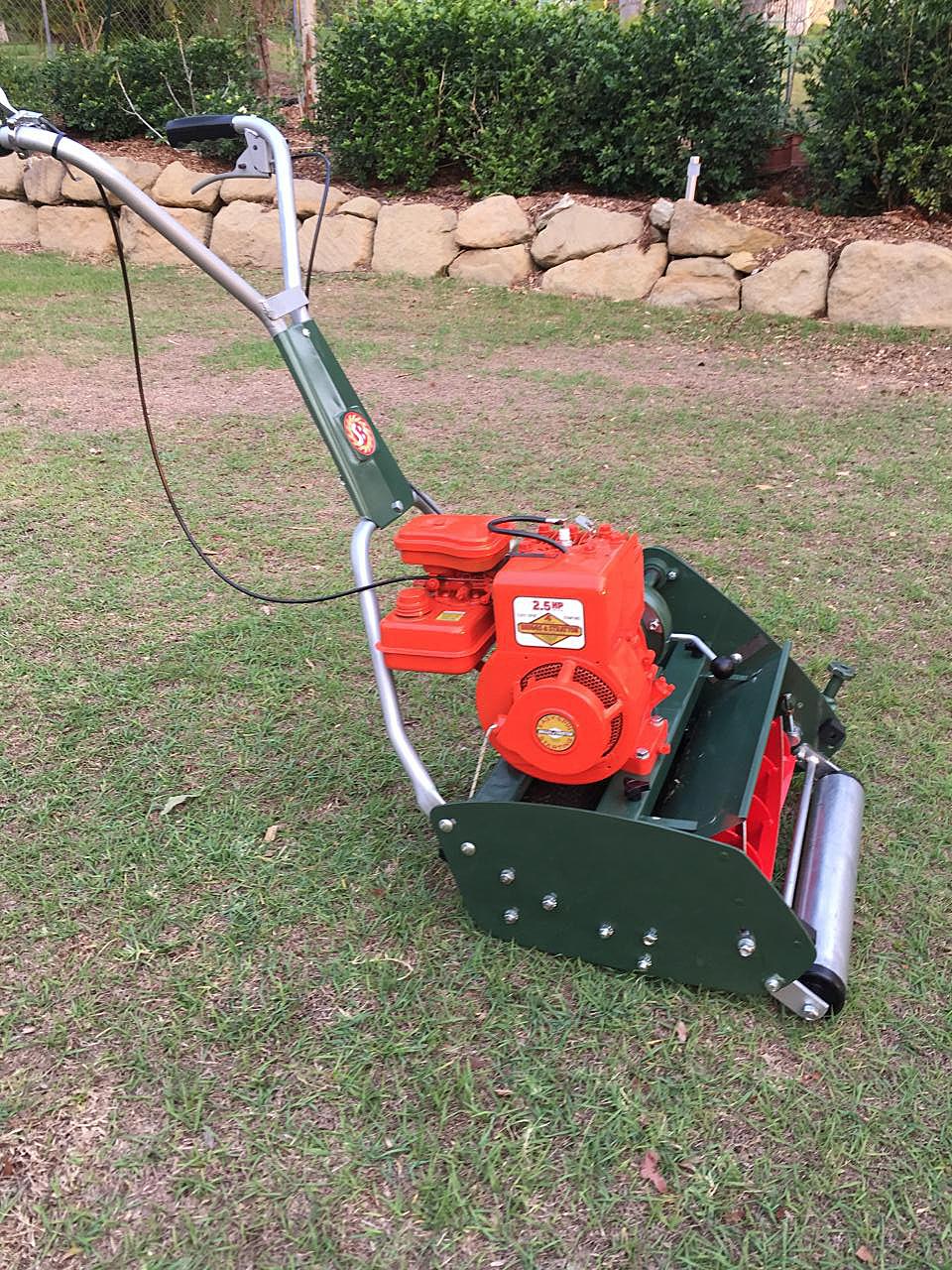

Here are some photos. Got the motor running well today, so will make a few minor adjustments to the reel (it was tearing the grass, so I think I need to drop the cylinder down a bit closer to the bottom blade) and then clean it down ready for Christmas. I'll take some more photos including the catcher before I put it away to hide it!
Likes: 310
Hello emk3, BB and Contributors
What a fantastic restoration, and this is a credit to yourself
and the art of full restoration.
From my perspective, the images are outstanding.
The first image in #79793 is almost theatrical!
I do also notice the subtle difference in the 'chemicals of preference'
used in these images ... [interesting]:-
I'm sure BB will explain the importance of a good set on the reel.
Also, a seasonal back-lapping will limit service costs.
I feel this thread will help members in their Model 45 projects.
Just Brilliant!
