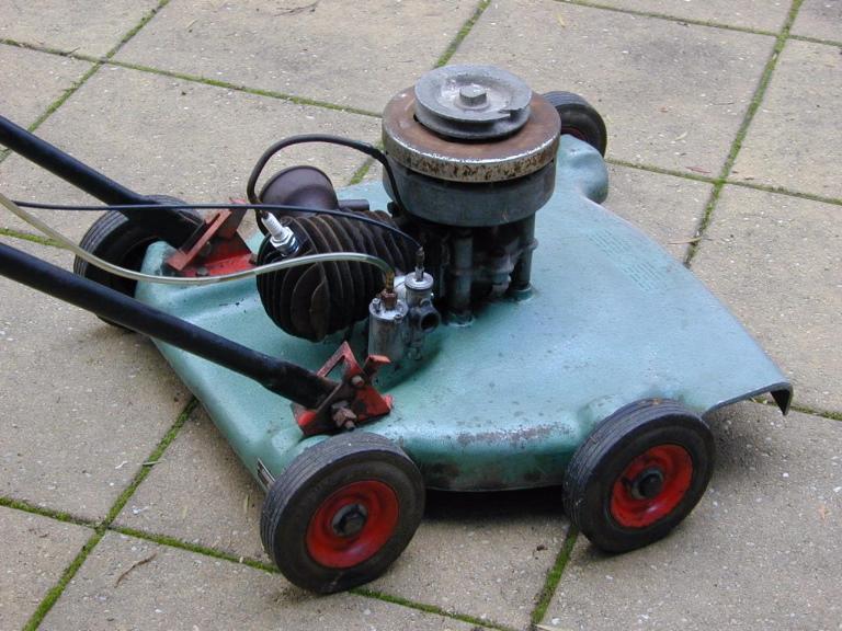

Original Tecnico Rotocut, powered by Villiers Midget Mk3 engine.
Source: Vintage Mowers.

The first petrol Rotocut (shown above) had an offset wheel design with
primitive height adjustment. Clearly, for the day, that was an advance upon
the Victa design (that was so primitive it offered no accurate height adjustment).
The offset wheel design with front discharge chute - typically USA - never
offered any advantage beyond the theoretical.

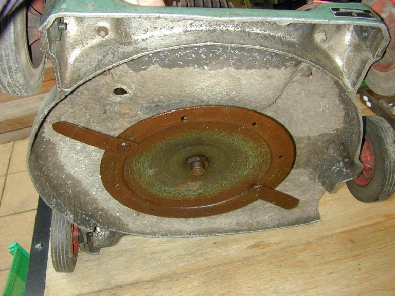

The first model had an 18" cut, and had an alloy base, but it was no 'toe-cutter'.
This mower had a shallow skirt, with blades contained within. The blades (blade)
was of the single bar type favoured by American makes. Engine shock protection
was offered via a spring clutch that 'slipped' when the blade encountered solid
objects. The handle was of modern tubular design and the mounting point (in the
middle of the base) should be noted. The power unit appears to have been
exclusively the Villiers Midget Mk3 (with fan cooling). The following
newsprint advertisements from 1955 and 1956:-

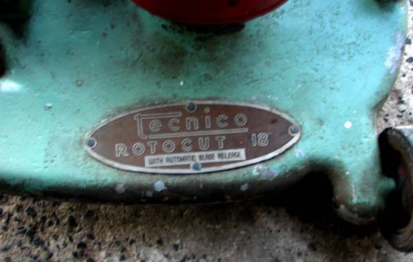

PHOTO RECORD - First Model Tecnico Petrol Rotocut
It appears that the first model petrol Rotocut was produced in two different
colour schemes. The first was red and yellow; the second red and green. Note
how the alloy base has mid-mounted handles.

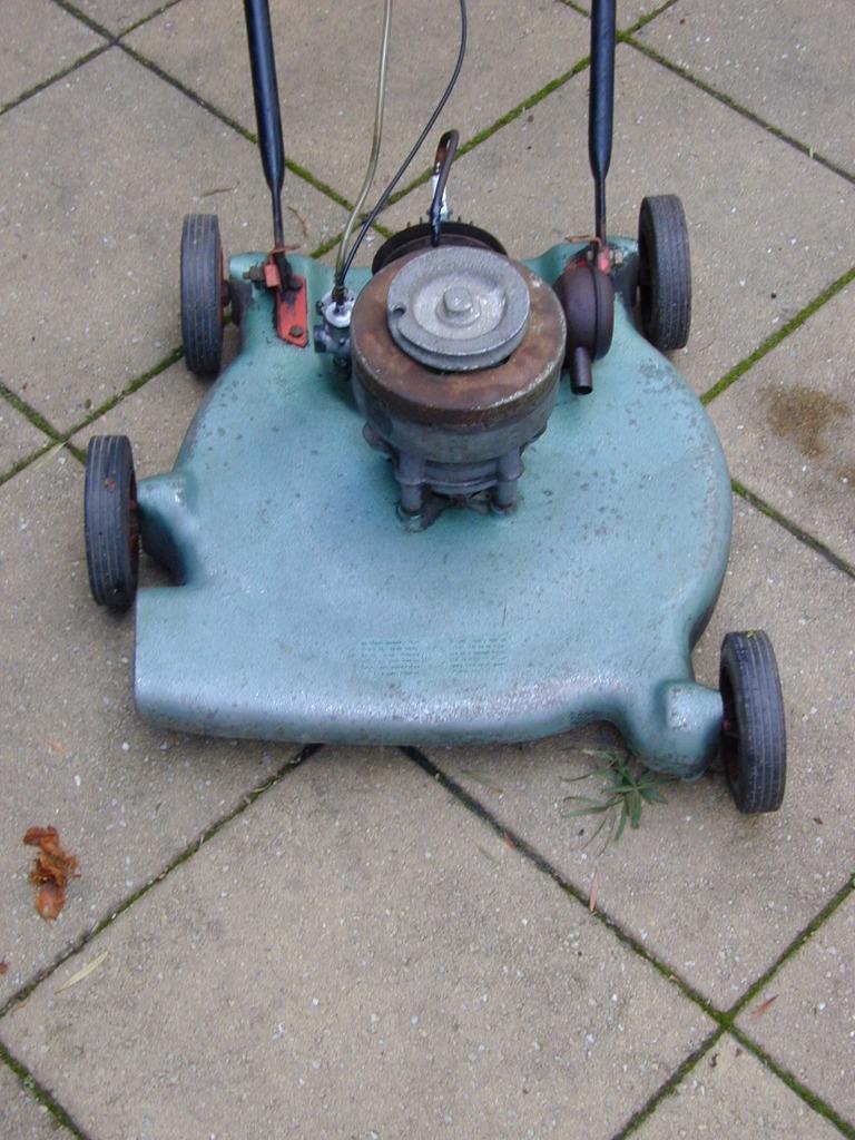

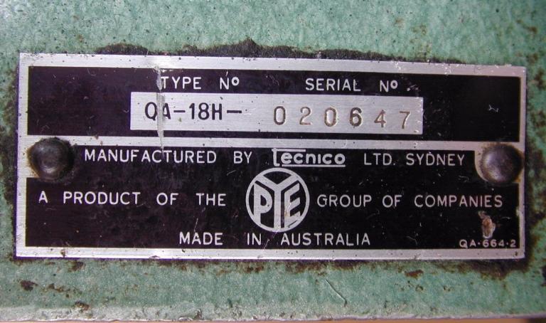

PART THREE - The Pye-Tecnico
When the Pye Company took a controlling interest in Tecnico the electric and
petrol lawnmowers continued. There were cosmetic changes for the electrics,
but the petrol machines had a makeover, with a redesigned chassis and a new
power unit - a Hurricane 125cc engine. This machine lacked the spring safety
clutch and fan cooling, and was clearly marketed at a lower price than the
expensive first model. This was the Pye QA-18H
This model had to be cheaper - because it was living on borrowed time.
Introduced in about 1957, it retained the American style offset wheel
design, with its primitive single wheel height adjustment (requiring tools),
and a step backward was made with the Hurricane engine (that had no fan cooling).
This was a cheaper machine in design, and the cheaper price reflected that.

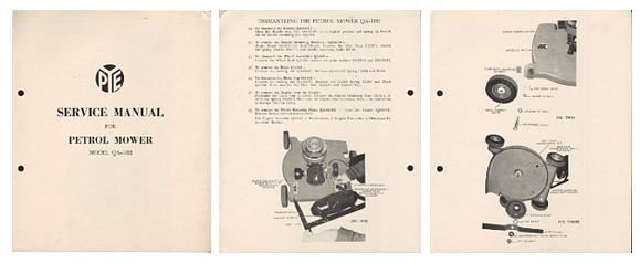

MANUAL

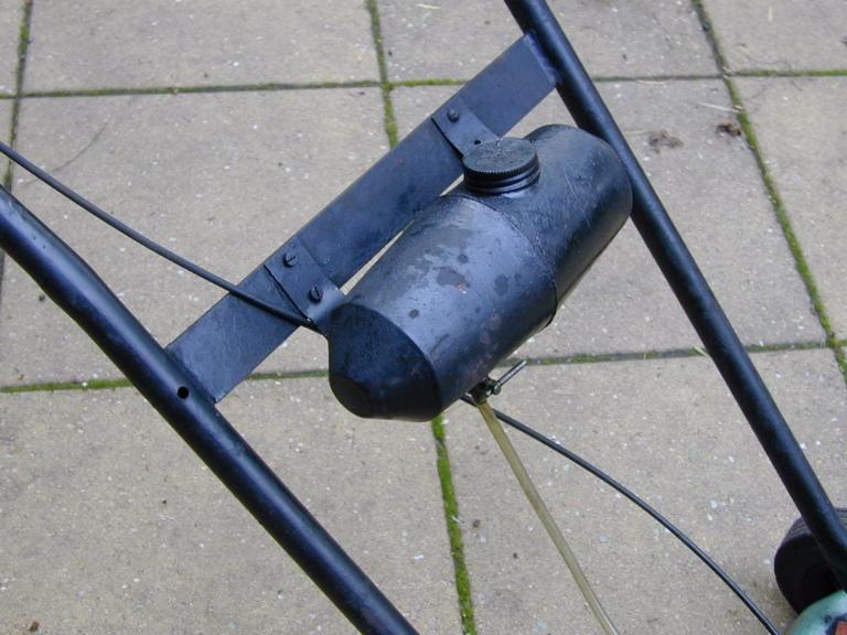

Here is a manual for the Pye-Tecnico QA-18H. From my collection,
it may be - as always - downloaded for personal use. Of note is the
bar blade (without clutch), and the rear safety skirt. Also note the
handle-mounted fuel tank and the handle mount brackets are now rearward
(rather than central as on the first model).
PYE-TECNICO MANUAL Fitted with Hurricane 125cc engine.

Here are some 2015 auction photographs.
