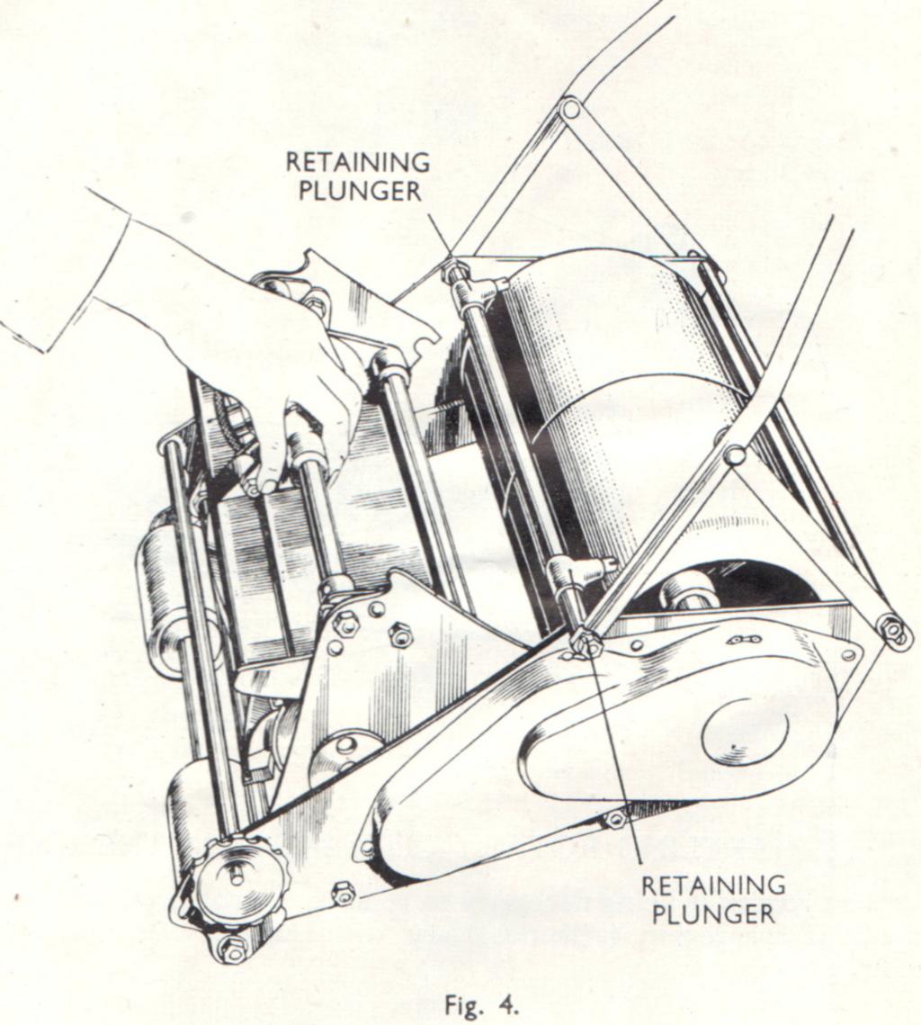

The main feature, as said, was the cassette reel unit. It permitted the quick
removal of the cutting unit for servicing without having to disturb the
chassis, transmission, or anything! A brilliant idea that is still used on
many higher-end residential and professional lawnmowers.
The cutter unit could be removed easily for servicing.
Modern takes on this cassette system permit other units to be
fitted - groomers, scarifiers, cutters.
