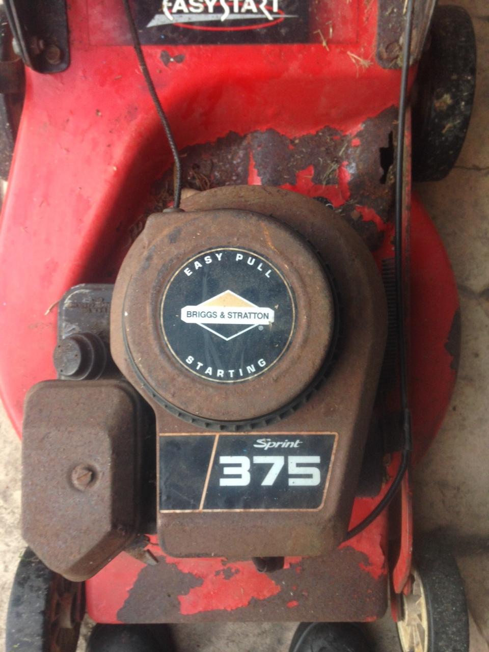

Engine is a 98902 0363 01 95061352
Having trouble finding the right recoil starter for my mower. The results on the Briggs website show a different engine. Im hoping someone can link me to the correct part.
thanks

G'day TheLawnRover,
Does the starter in this IPL download look like it?
http://bsintek.basco.com/MDEXResultsPages/PDFDisplayPage.aspx?fileName=18howHXCnfBhU7y
If not, a pic or two would help - pic uploading how-to is HERE
Note that the starter shown as #608 is the late type; used after Code 97060600. The earlier starter has some differing bits, which aren't shown as an assembly - notably the Starter Clutch #66, a different pulley #56 and Spring #57. The late type uses a flywheel cup, and the corresponding pawl setup shown under illustration 608.
This is the only IPL that the B&S search engine brings up for that exact Model and Type Number combo; that search can be broadened by being less specific, e.g. by using Model Number only. But that can give you a lot of pages to look through.

Are you looking for a complete assembly or parts to repair one? If you can upload a photo of what you need there is a good chance I or someone here will have it.

To OP, There may a good why your finding a different engine. Many older engines sometimes an engine shroud change out and the correct number are never transfer to the replacement cover. This can lead to confusion and the wrong part installed later.
These shroud changes are done by inexperienced techs and owners not knowing just because a cover fit doesn't it has the right numbers on it when later repairs are needed. I have ran into this a couple times so far and it makes hard to find the right parts.

Thanks for the response guys. That is the same pic I looked at and dont think it looks like mine.
Im looking for a complete recoil starter, it looks as though its housing is part of the blower housing so even a complete blower housing with starter will do me.

So, this then. Same model number. Complete unit including post with tracking via prepaid satchel for $20. If you are interested send me a PM.
Posts: 693
I just noticed how bad the base of your mower is. Too bad you are so far away, I have one of those bases in perfect condition sitting in the spares pile. Alternatively I have an alloy one in excellent condition as well.
