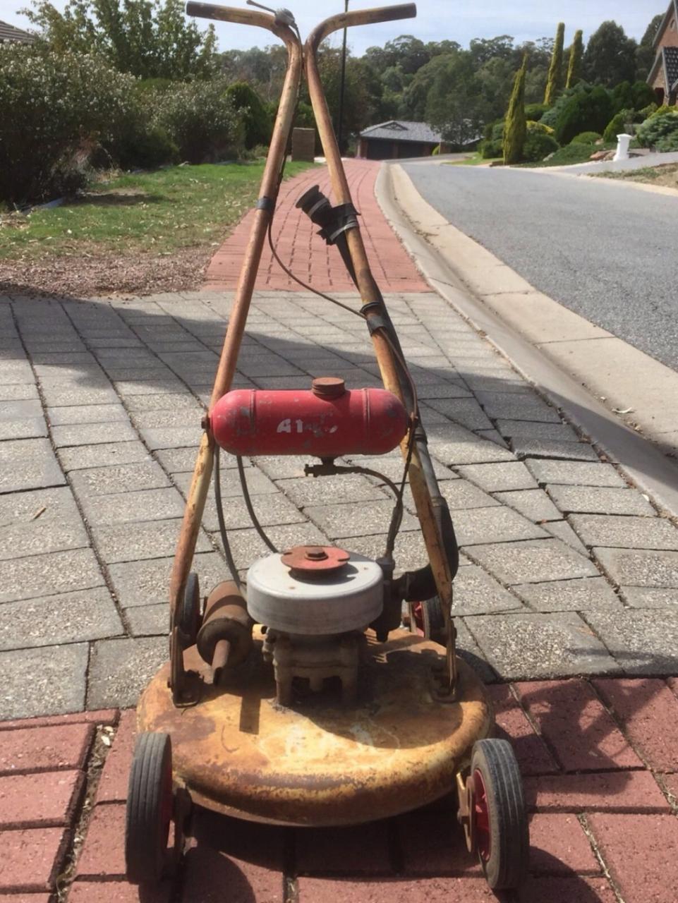

These are 2016 auction pictures of an Adelaide machine.
Thanks to member Paul C for spotting this one.
Note the yellow and red colour scheme and the Atco/Villiers engine.
The rear-discharge chute is not a typical Australian design at all.
It reminds me of the UK's Rotoscythe County model (see link below).
Particular note should be paid to the fading decal.
It's not the same as presented in the brochure (above) - it has
a kangaroo and emu, and a crown within the outline of Australia. An 'A'
is central. This is a more complex decal.

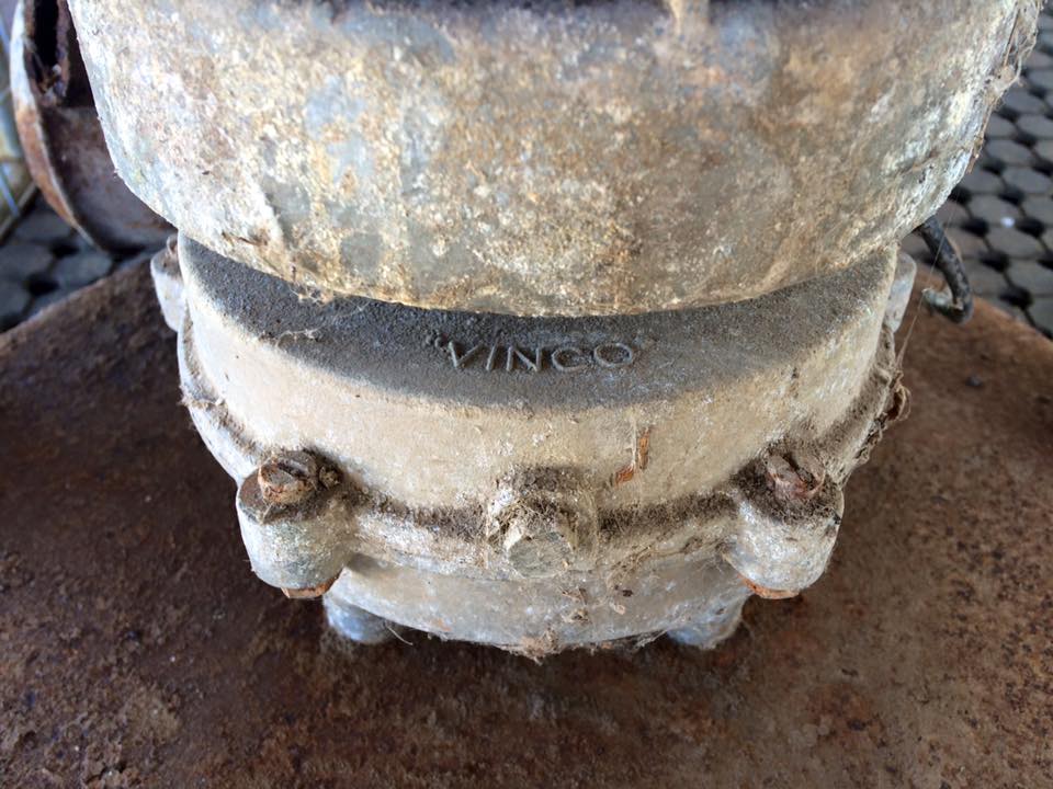

A Mystery Machine
There is photographic evidence of an Atco rotary that should be covered in this
History Record. It is a first-model 16" Atco with a significant specification
difference.
The photographic evidence depicts a blueish-coloured base and a different decal.
I believe the bluish tinge is faded and weathered 'Atco Green'
The decal is the more complex one not depicted in the yellow machine brochure.
Most important is the engine ... it's an Australian-made Vinco! How could this be so?
The Vinco-powered Atco is an outright mystery. I can only speculate that this
machine was the earlier model ... and it may be that the impetus for an Atco Rotary
originated here - on these shores! The Australian engine, the different colour, the
decal (the same as on the yellow machine above) all point to an earlier machine.
I wonder ...
In mid-2016 a second Vinco-powered Atco rotary surfaced.
Owned by Richard Ballard of Dalby, he confirmed the originally
colour was an 'Atco Green', rather than the red/yellow machine.
Acknowledgement: thanks to Richard and Kye for updating this record.
