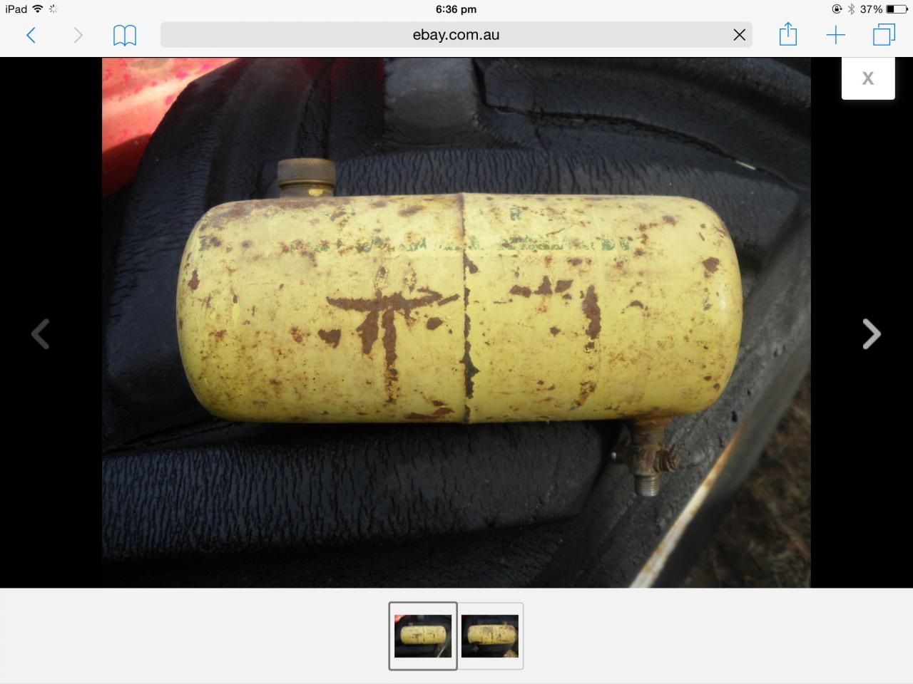

Won a fuel tank off EBay that looks and measures the right size
Hopefully the tank will be with me soon and the decal is being worked on :-)
