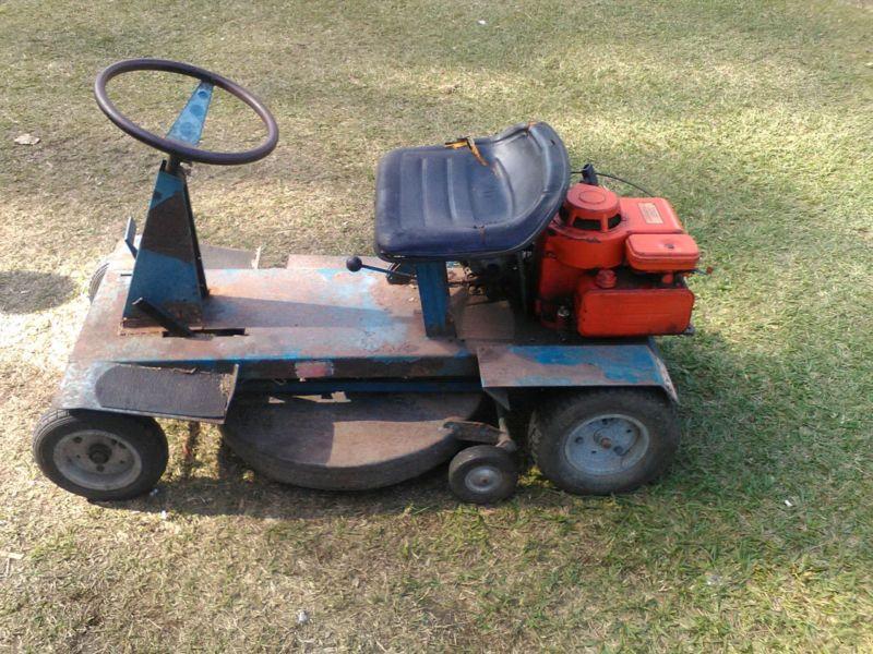

Frank as your friend knows only too well repairing rideons is a thankless task. Every one you get has been left out in the weather so everything is rusted,they have been flogged into the ground and to do a reasonable job on repairing them I can spend up to a month. Not a brilliant financial business plan but it keeps me in the shed and that keeps swmbo happy
Originally Posted by Frank77
I set about yesterday to swap out the gearbox and was again hindered by the fact that my various (quality) sockets and open enders needed to be forced onto the nuts and bolts. Something has happened to them over the years it seems, they have swelled up (mild surface rust ) or perhaps they made them a tight fit from the factory?
The other thing that's very common on older Australian-made/assembled machines is the use of Whitworth [and less commonly BSF] fasteners on the chassis. These were the commonest local standards in the pre-metric days, not so much US AF-hex UNC/UNF/SAE. So you really need a few BSW/BSF spanners and sockets to work on them. Or 'universal' tools like the 'Metrinch' range.
Then a POXY circlip on the input shaft held me up for an hour as well as needing to find a replacement as well as buy a pair of small circlip pliers to reattach it.
It always seems to be just one small task that doesn't go well, and holds up the entire job!
I suspected that from the outset Gadge. I'll look around and see what's available
I can see that now. I think the biggest mistake I made was to do it bit by bit leaving the mower basically fully assembled. I think it would have been wiser to pull off the cutting deck first (is still attached) and then remove say the engine and gearbox, seat and then say the wheels. I'll pull off the deck now and proceed from there.
I'll know better next time, if there is a next time...
Joined: May 2016
Posts: 26
Just a quick update. I have mostly stripped down the spare red mower I bought and noticing that its body and parts generally are in better shape will have decided to rebuild that one instead of the green one. The work I did on the green one was basically just respraying and that needed to be done anyway if it is to go into storage. I will pinch the motor and cutting disc off it and then pop it on a shelf. Will post again when I've repainted old red and have it mostly re-assembled.
