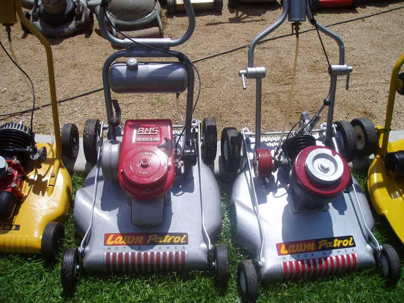

Hello everyone.
Steve here, and I am new to this forum but have read helpful information about mowers on this site (thanks). I have kept for 30 years my grandfathers 1958 Lawn Patrol mower. I am going to restore it next year and have been trying to collect parts for it. However, I have gained 3 working mowers this year - a bit much. So, I thought I might continue writing the history of this mower, the John Boundy story and hopefully, justify a place for an exhibit of one in the Australian National Gallery Canberra over time.
I like the advertising material that was produced for LP and the slogan - Lawn Patrol 'out mows 'em all' Not as catchy as the Victa slogan but, nevertheless its all part of the history. Any information about the mower and Boundy will be gratefully accepted. The history starts from "John Boundy Diesels" - prior to Boundy Manufacturing Pty. Ltd.
In the meantime, I will continue to enjoy the variety of activities members communicate.
Steve

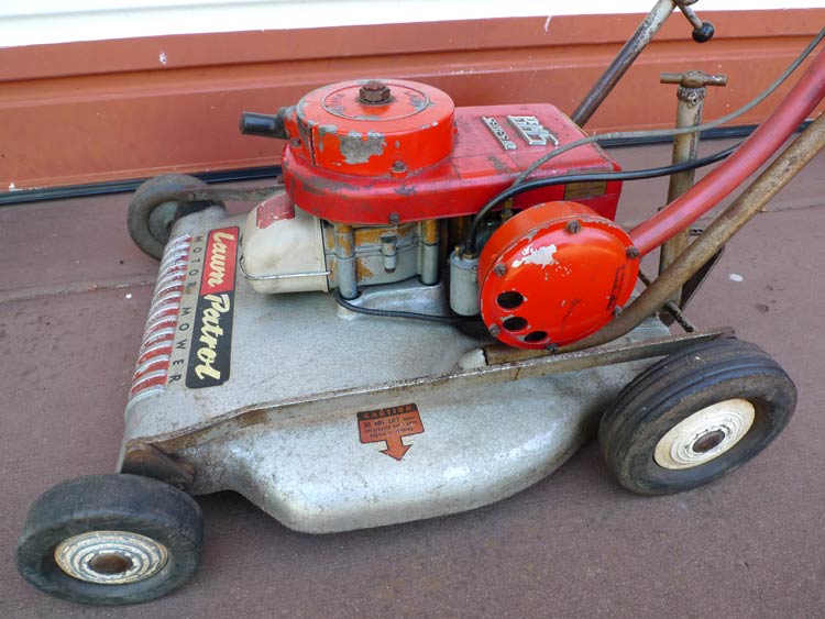

I hope photo is there now.

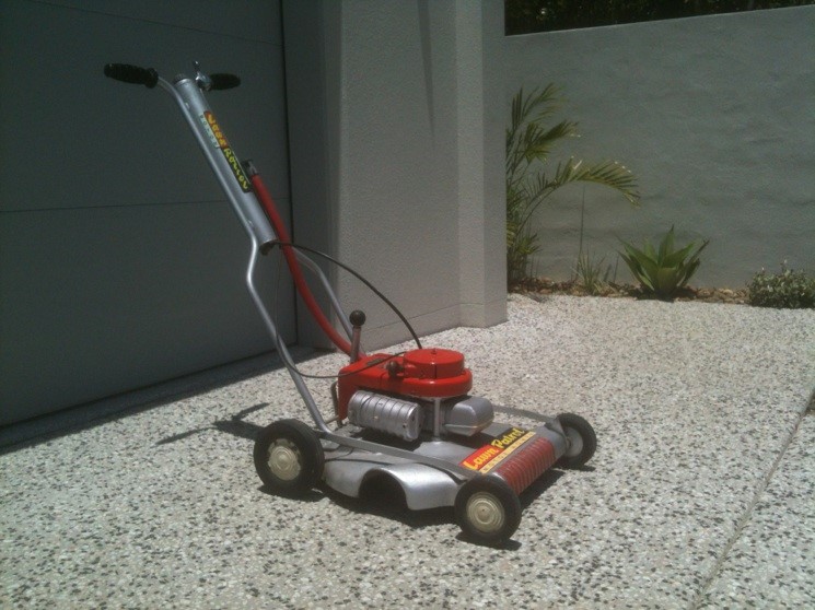

noileg #74624 16/04/16 03:55 AM
Joined: Nov 2015
Posts: 637
What a beauty! One of my favorite lawn mower brands from the 1950s, and yours has known history!
Thanks for reading!
noileg #74625 16/04/16 03:56 AM
Likes: 317
Hello noileg
You said that you plan to restore your Grandfather's Patrol next year.
Yet, this image seems to show a restored machine.
It looks fantastic though!
I have a supplementary question smile

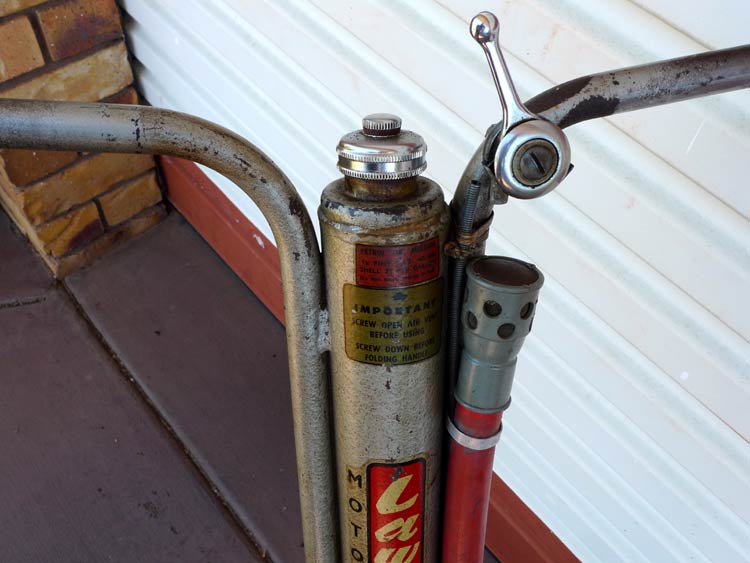

Also, do you have a close-up of the air intake?

Well, The old girl was 'worked on' by my father in 1980 and has stayed that way since then. I last used her in about 1998. The air intake is the diaphramatic 'snorkeled' version that was decalled with Patent Pending etc or Patent No etc. I have 2 mowers with different labels.I have 2 other versions with 2 standard air filters evidenced on earlier models as per advertising in 1957/58.
As far as the Cub, Scout and Patrol were concerned - (1956 and 1957), Patrol was always in existence. The Argus and The Age have ads supporting this. For example, in 1957 Boundy promoted tanother Lawn Patrol Golf Tournament - Kel Nagle won !!!(The Age 1957). I have other info to suggest that the golf tournament was held in 1956 as well. The cheaper Cub and Scout were both initially manufactured with the 1.75 BHP motor (Points under fly wheel). The Scout was up-graded but short lived - it became so close to the 'standard' Patrol that Boundy et.al., dropped it. Both were designed to meet the under 40 quid and under 50 quid markets respectively.
Lots more info at some stage but too may gaps in the info at present, so I am on the hunt particularly for Boundy's story. I would like to see a version of the LP 21 inch cut.

The diaphramatic snorkel suggests a 1959 model (or later)?

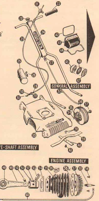

In this Cub illustration (below) note the flywheel (40) and the bar
blade (39).

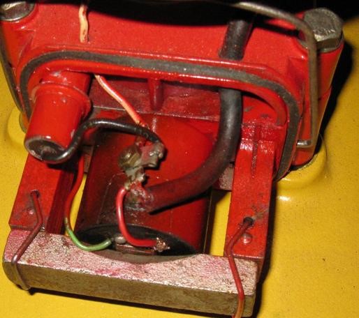

Jack, this might be the ignition patent: Australian Patent No. 13967 of 1955, inventor Francis John Boundy.
The File Manager won't let me attach a PDF bigger than 0 bytes, so you'll have to find it over at IPAustralia.
US Patent 2874202 is also relevant; inventor is listed as Francis John Boundy of Belgrave, Victoria. Granted 17 February 1959.
noileg #74718 18/04/16 04:04 AM
Likes: 317
Hi Gadge
That is seriously fantastic new information for the record!
So ... Francis John Boundy.
Given I know nothing about electricity, the patent read was
pretty straight forward - those slots (15) had an interesting purpose.
