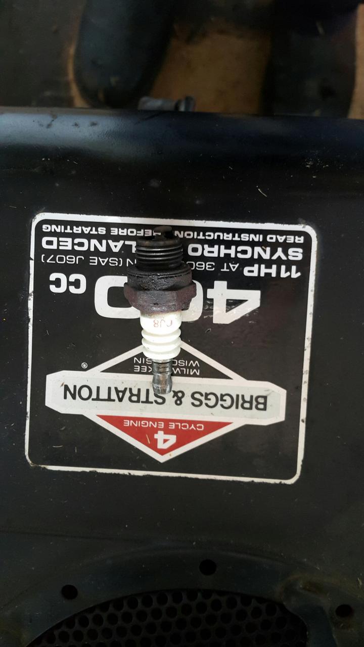

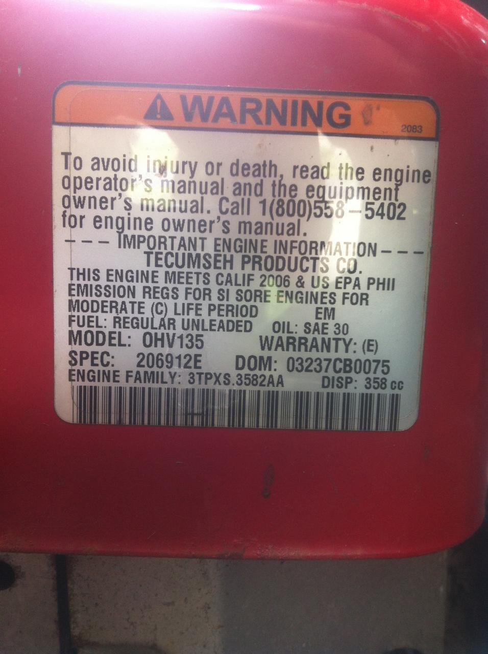

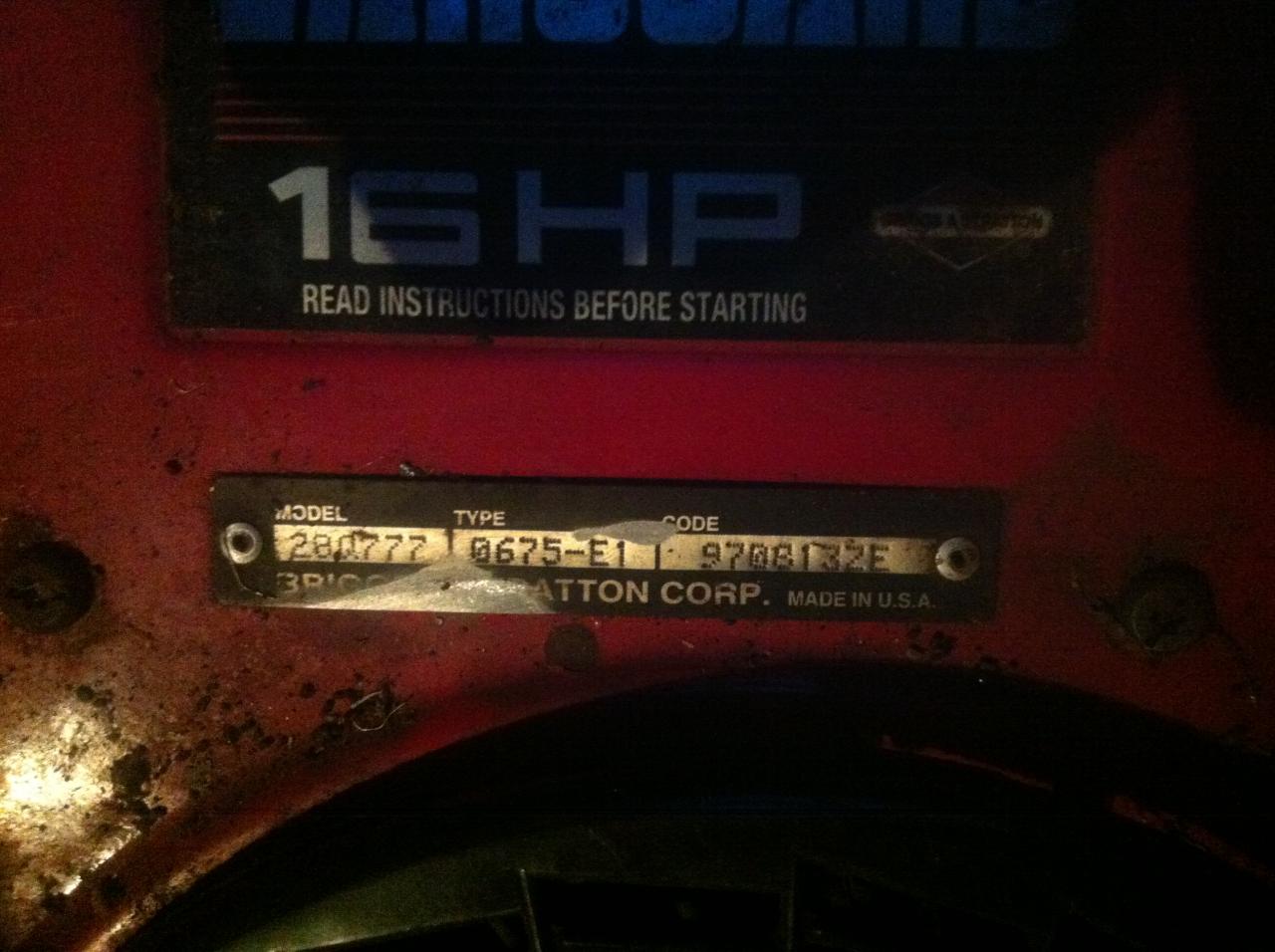

2. Engine Numbers are also important. For example, if it's a Briggs and Stratton motor, having the Model, Type & Code helps to identify the specific engine series when looking for Parts and Diagrams.
A 13.5hp Tecumseh Engine I have has the engine label on the side of the motor
And a 16hp Briggs and Stratton I have has it's engine numbers on the cowling. These are sometimes located on the OHV cover

If the engine is a Briggs and Stratton, you can use this link below to get specific information on your motor. It requires a 6-digit Model number and the first 4-digits of the Type number.
http://www.briggsandstratton.com/us/en/support/manuals/engine
Some of the older Briggs and Stratton engines only had a 5-digit number and, in this situation, you just add a "0" (Zero) in front of the model number to make it up to 6 characters.
Once you do a search, you may get several results for the engine Model & Type input. If this is the case, just look for the number that matches your machine. For example, on the B&S above, I would look for 280777-0675-E1, and then you have your manual choices of Parts Lists and Owners/Operators Manual.

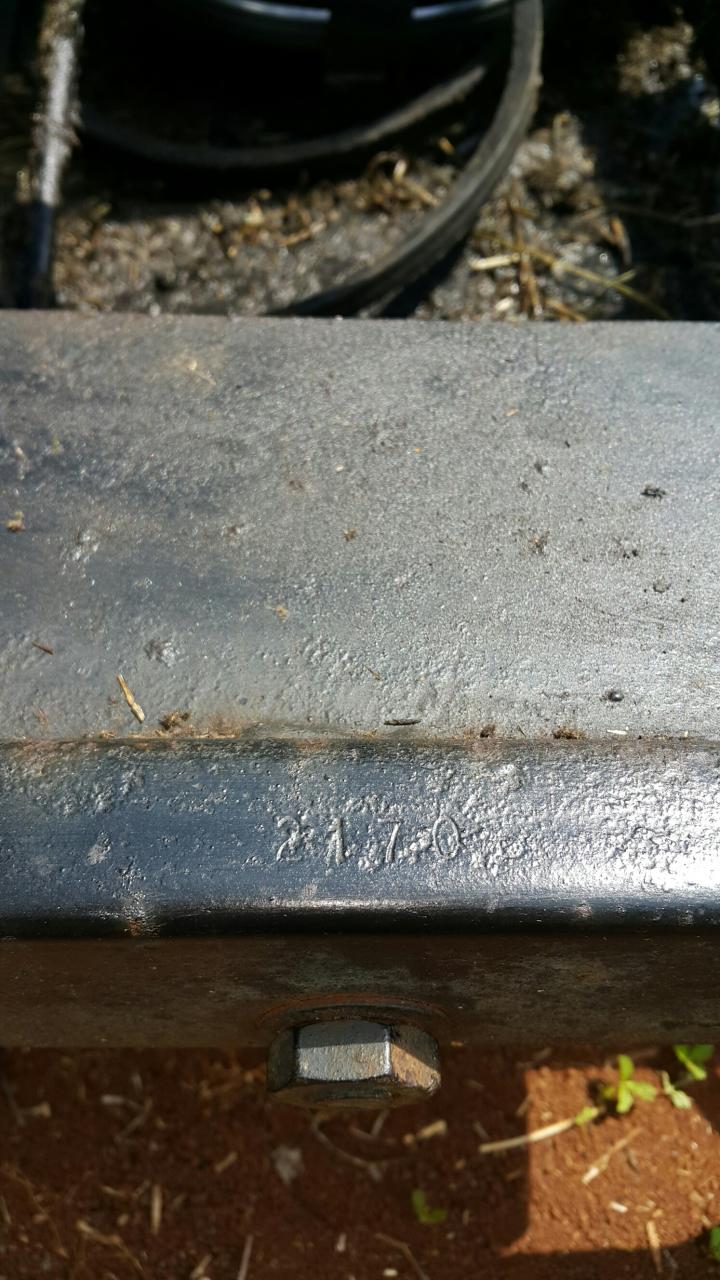

The mower itself will have no significant identifying data on it from greenfield except for the serial number, which will be on to of the "U" channel that the front axle beam is nested in. It's a 4 digit number, possibly followed by a letter. It doesn't mean much as the tractor series didn't change much during its production (late 70's to mid 80's ?).

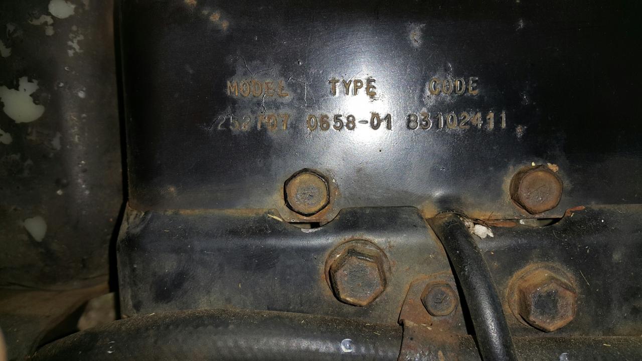

Engine Briggs and Stratton
Model Type
252707 0658-01
Found the 4 digit code stamped on the front
2170

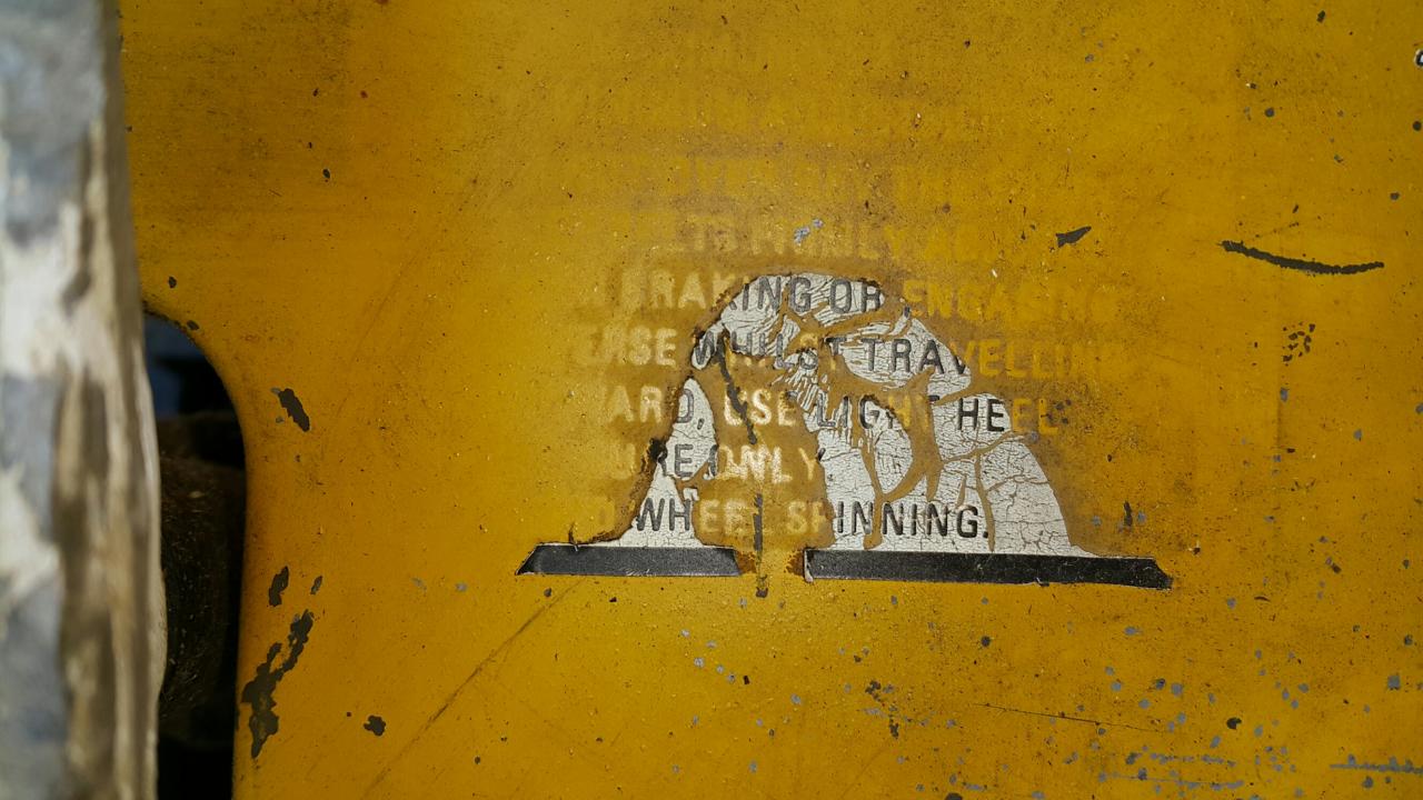

GT401 A

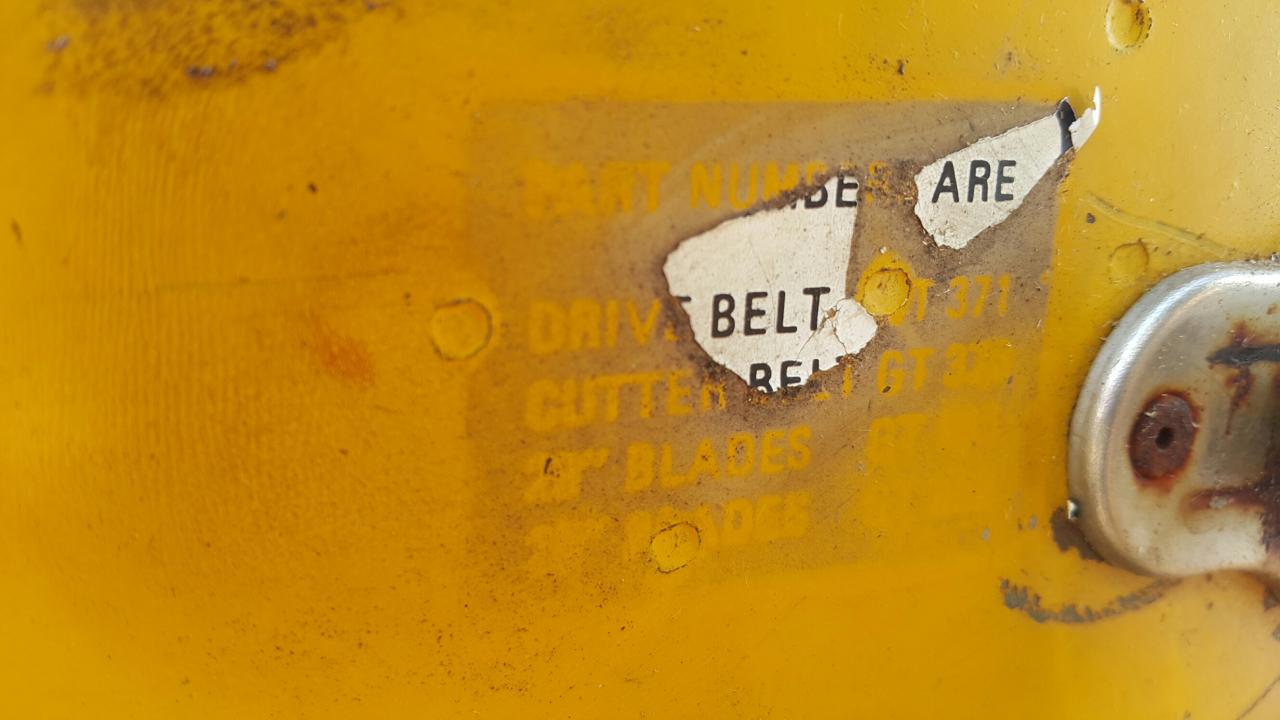

A label on the side panel was very faded and most had peeled off.
Part numbers are
Drive belt GT371
Cutter belt GT37?
2? ' Blades ?
?" Blades ?

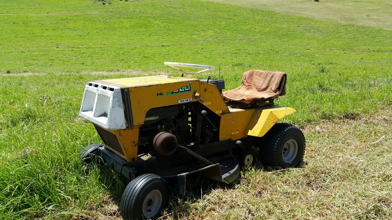

This sounds like an Anniversary model, drive chain on the left hand side? I think the model before had the chain on the right, they are all very similar but different. Does the bonnet have a white section on the front? Are the rear wheels held on by a single nut or 3? This is not conclusive because bits get swapped around but it might give us an idea.There is something different with the deck adjuster as well from memory. The steering setup on the Anniversary is different as well. Pics always help

Those are tractor series numbers, me thinks.
To fill in the gaps:
Cutter belt GT376
25" blades GT 892
28" blades GT 894

Now we know it is a Briggs and Stratton on the mower, if it has the original engine, then the Engine Code will provide you with an estimated Year of Manufacture for the machine.
In my photo above, the engine Code is 970813ZE. The first 6-digits give you the date the engine was built in YYMMDD order, and the ZE is the factory where it was built.
In my case, the engine on my mower was built on the 13th August 1997, which gives me an estimated year of the machine as 1997-1998.
This may help narrow down the machine and make it easier to work with.
Overall, you should now have a good idea of its basic information.

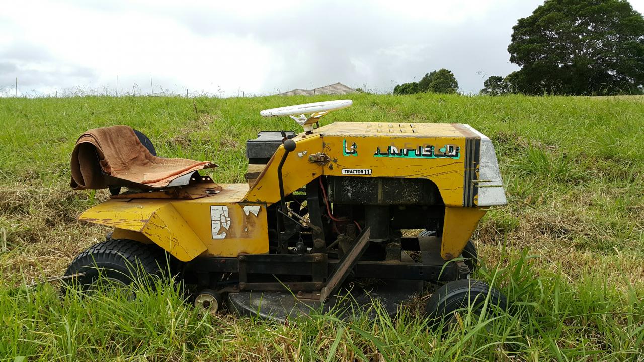

I have added pictures,
The drive chain is on the right hand side.
Posts: 8,215
Mini Tractor I think?. Looks like Anniversary rear axle(single nut?) I guess there can be just flipped over so the sprocket is on the other side. Anniversary has the battery under the seat and a handbrake fitted on the right hand side.The steering is also different. All very confusing, worse than trying to identify the various toe cutter Victas. laugh

Looking at the engine information, the motor was built on 24th October 1983 so, based on this, it could indicate your Greenfield was possibly built around 1983-1984.
Now you have photos, I'm sure members can help with further information, like as Norm has indicated above.
This one is designated a 'Tractor 11', Model No. 11 VE. These were made from the late 1970's to middish 80's as best we can work out. 1983 would be the original engine; as Bushy says, the machine was likely built in 1983 or 84.
There is an Illustrated Parts List download available in the Greenfield Manuals area, which is a pay access section of ODK.
The second file down, described as 'Tractor 5 to 11 version', is the one you need.
New parts availability from Greenfield will be limited at best for this one, as it's now outside their 25 year spares supply window.
Parts common to later models, such as blades, will be no problem. Bearings and drive belts are standard industrial types, and easy to source once you have the type number from the old ones.
