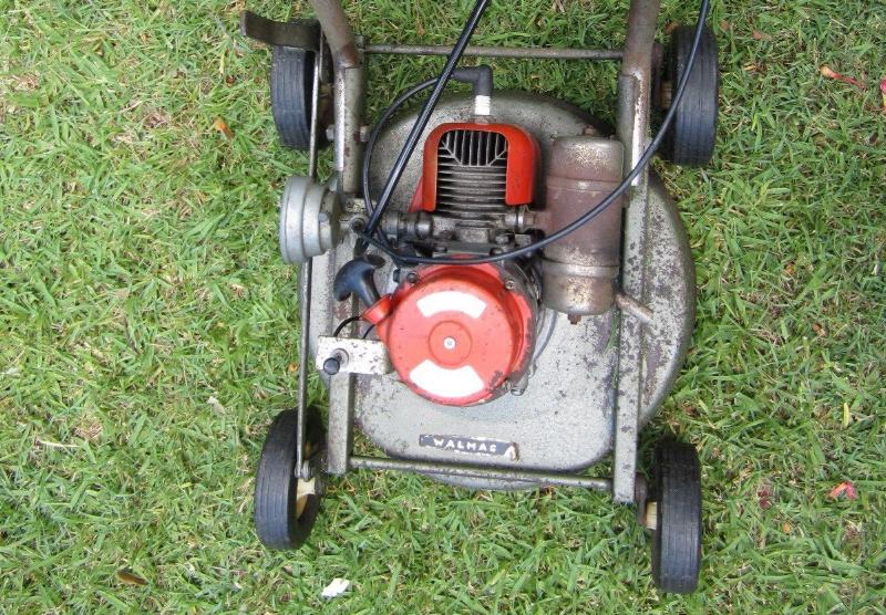

The lawnmowers of interest are the Walmac & the Minimaster.
I can find little on each.

I have the engine sorted out now, stripped down and cleaned, cylinder honed and replacement rings fitted. I obtained the correct fuel tank, carby and a better muffler.
[video]
[/video]
Next is the leg and then a repaint :-)
