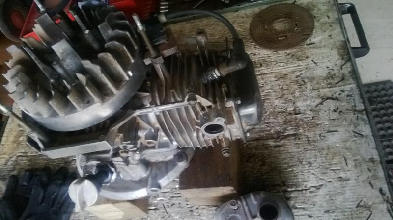

This was the hardest flywheel for me to remove to date, I couldn�t use my usual steel plates. From the manual it showed 2 cut-outs on the flywheel saying �PULLER�.
So I now finally have a large 2 leg puller. After many days of spraying, tapping & tightening it eventually exploded off the shaft. I didn�t want to use heat as the top seal was right there.

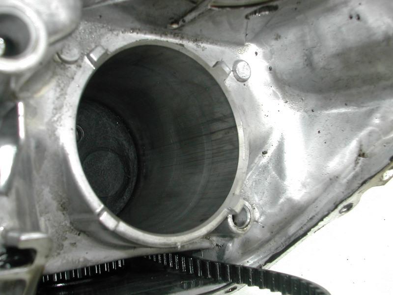

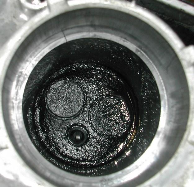

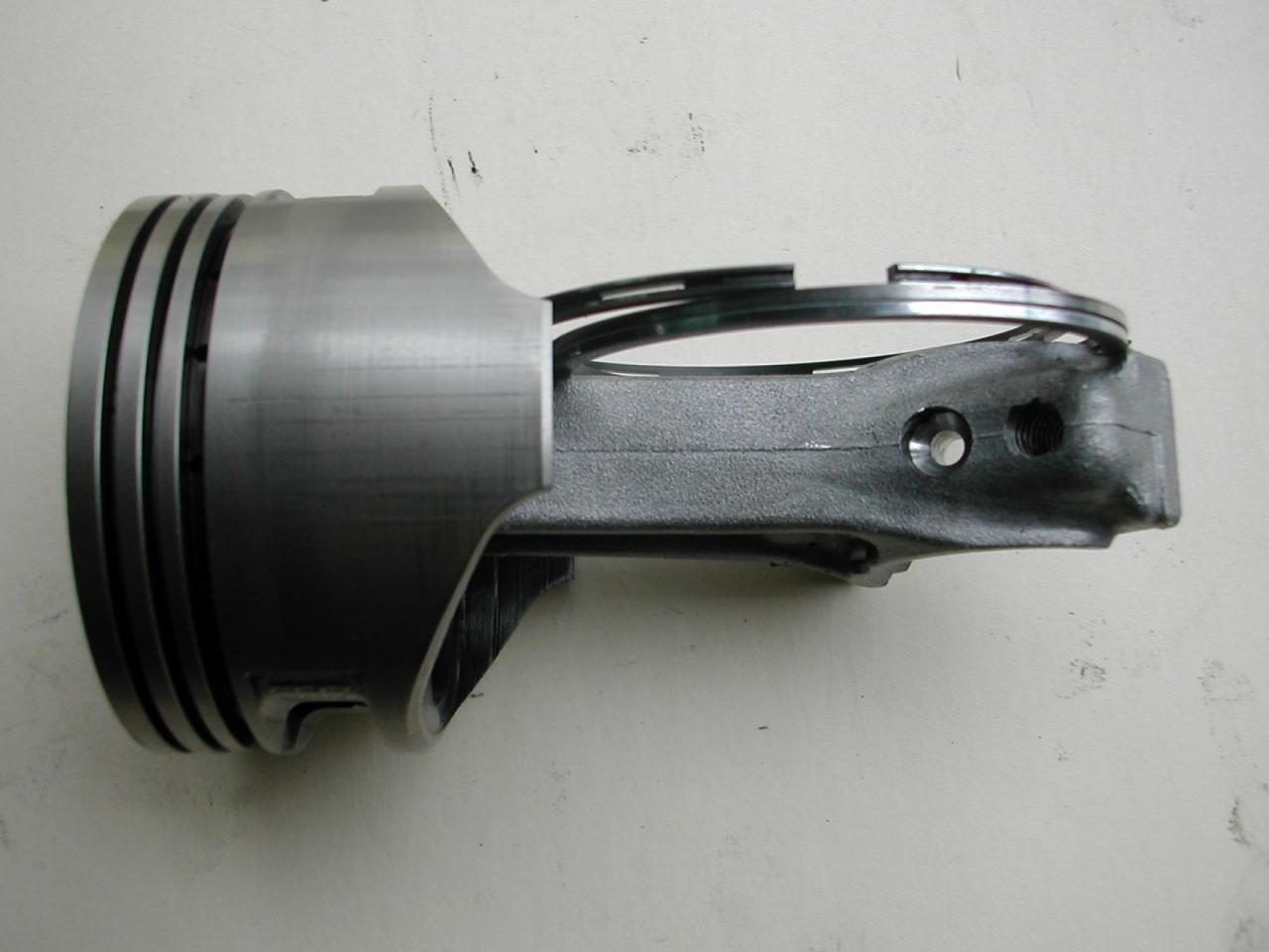

This is the engine and the condition of the piston and bore showing scratches behind the ring grooves.

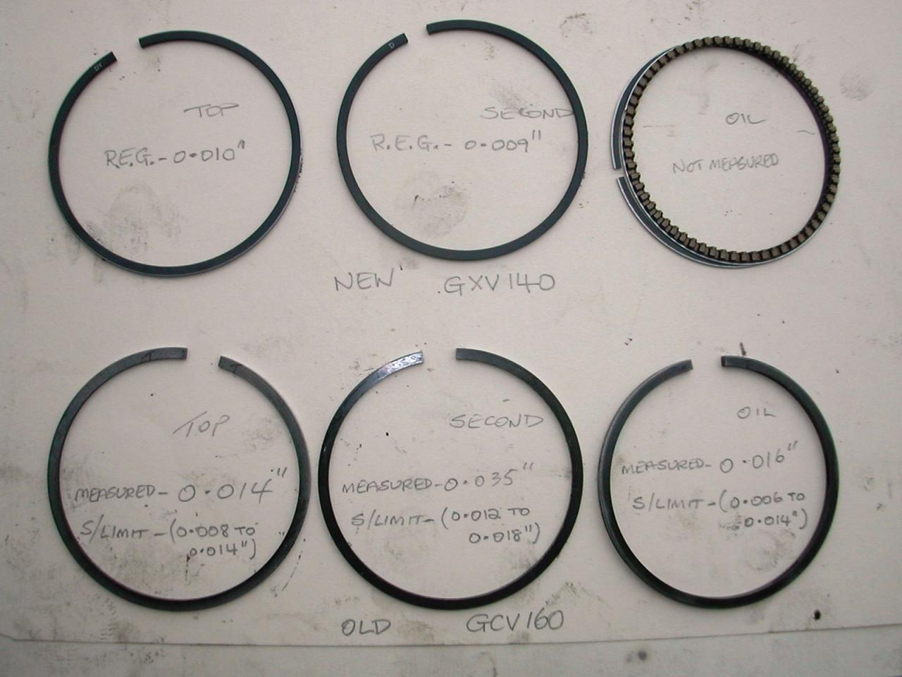

Here are the new & old ring end gap measurements.
I am considering using a new set of GXV140 rings.
Please see image of the comparison.

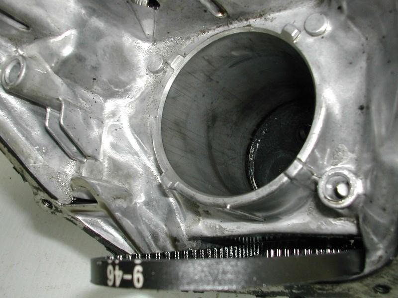

The only size that doesn�t fit the service limit window is the GXV140 second ring, its gap is too small (see image of 2nd ring in the bore)
NOTE: I wet the carbon with oil in the image above.

I intend to line the cylinder with cardboard & clean the carbon from head with a wire brush on a drill extension & my bearing scraper.
Then lap & service the valves.
Then give the cylinder a hone.
After honing, the new GXV140 ring gaps should be larger.
My assessment of old rings is:
-top ring worn to the extreme of its service limit.
-second ring you can drive a train through.
-oil ring worn just outside its limit.
As you say, Mark, it is an opportunity to become familiar with the OHC Honda engines, which may make it worthwhile overhauling it provided you don't spend much on parts.
Working from the ring gaps alone, the wear is perhaps about as bad as on an ex-contractor pushrod Honda that has been scrapped because it has just started to blow oil smoke. Typically I'd expect to find 0.0020 - 0.0022" of bore wear on a healthy engine to get the results you've got - but there would not be any sign of striations to the bore or piston. Because of this it may be that your engine has a quite different problem from normal wear. The first possibility to consider is that it may have been operating for a long time running extremely rich, which washes the oil film from the cylinder, and is likely to result in bore striations like yours, and a larger than usual amount of bore wear. Alternatively of course it may just have been run for years without an oil change, resulting in a lot of oil contamination. The striations on the piston and bore are characteristic of either lubrication failure or contaminated lubricant. You should know which it was by now, from the condition the oil was in: was it extremely black and filled with swarf, or did it have the nasty acidic smell of oil with petrol in it?
The much higher wear on the second ring than on the top ring is characteristic of Honda ring sets: the top ring is chromed, while the second ring is not only not chromed, it is tapered to act as an oil scraper, resulting in relatively rapid wear until the taper feature wears off it. On the older engines, the oil ring was a one-piece cast iron affair, not chromed, and it wore nearly as quickly as the second ring. In recent years they have had automotive-style oil rings: a pair of chromed, steel-rail rings with an expander/spacer in between. This has given a substantially reduced oil ring wear rate, but made no difference to the wear rate of the second ring.
If you can't find any tendency for the striations on the piston to catch a fingernail dragged around it, I'd say you can re-use it in a 4 stroke like that, but not in a 2 stroke, and not in a customer's engine. However I would want to know the bore size and piston size, compared with standard sizes.

The scratches in the bore look worse than they are, it will hone up alright.

I have done the cylinder honing & the GXV140 second ring end gap was 0.009" now 0.011".
Valves were in good shape, only need a little lapping.
I also checked the GXV140 rings, side clearance in the piston grooves, which are OK.

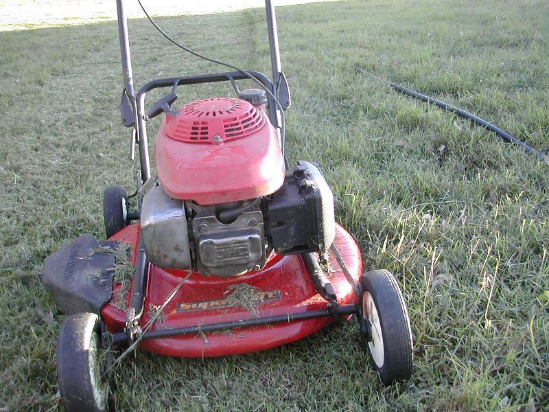

I have run this engine unloaded, yesterday.
Today I did some mowing, progressively loading the engine & increasing its speed.
No smoke, all sounds and feels ok.
Has a bit of a surge, I may have to look at the carb again.

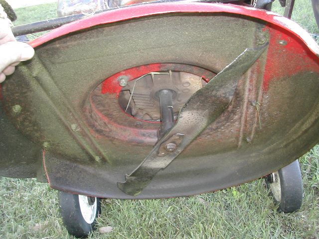

Not a big fan of bar blades, but its the only 21" option I had.
Surge could be to do with the bar blade.
I will order a new universal blade plate for it, the old one was fractured in numerous places, not the first time I have seen this.

I have no respect for bar blades: they bend crankshafts, damage bases, cut poorly, and give a weak draft into the catcher. The best cure (on Hondas anyway) is to get a proper blade plate from a defunct Honda and fit four new good-quality blades to it. I did that on my favourite Honda (an ancient HR194 from soon after production began in 1983) a couple of years ago, and completely transformed the beast. Now if only I'd done it thirty years sooner, and if Honda had given the machine a bigger grass chute.
