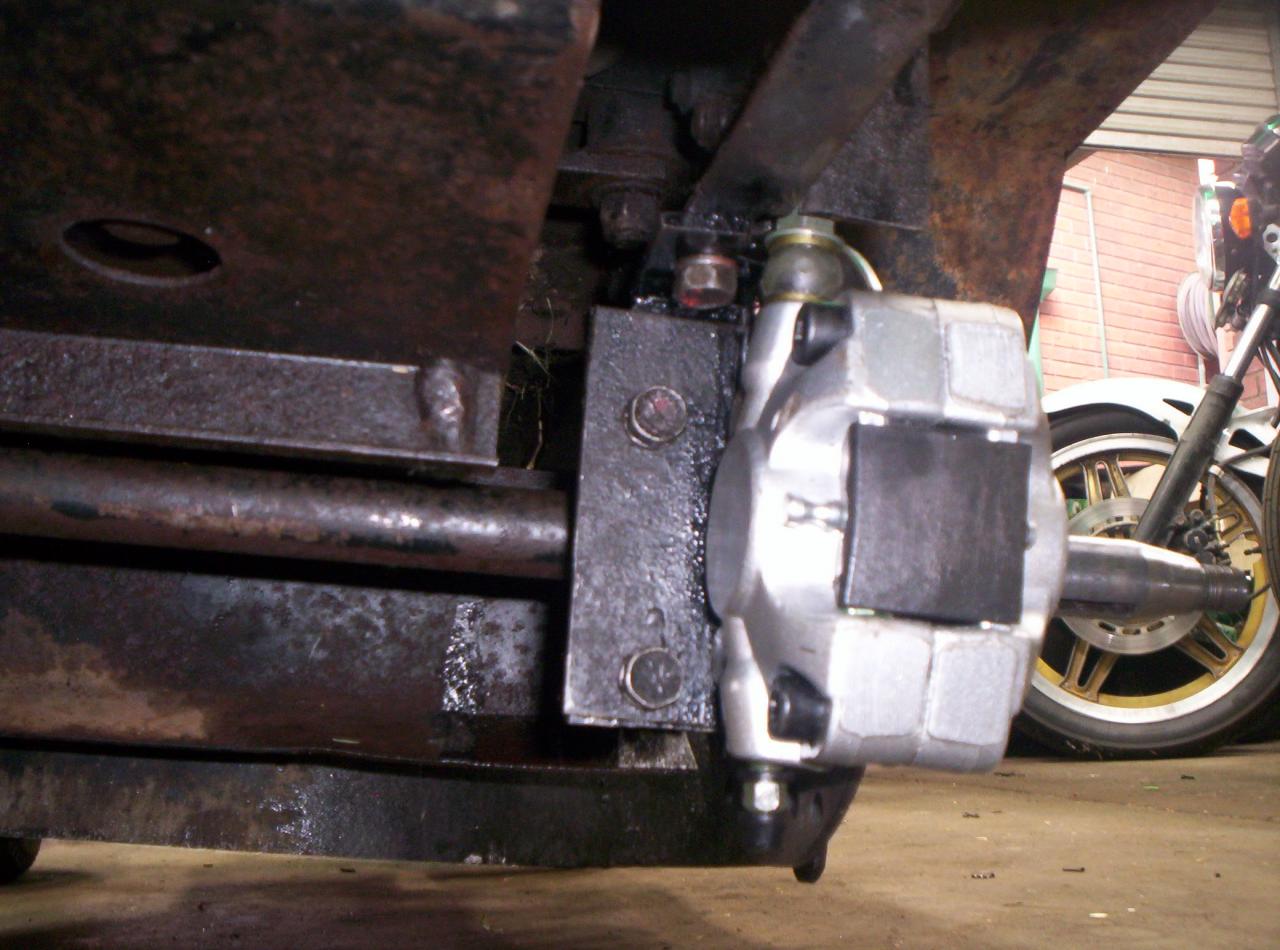

Slash, I have given up on the drive gear idea, I will drop the rear axle out in the morning and see if I can fit a disc to it on the inside instead of trying to fit it between the frame and the inside of the wheel

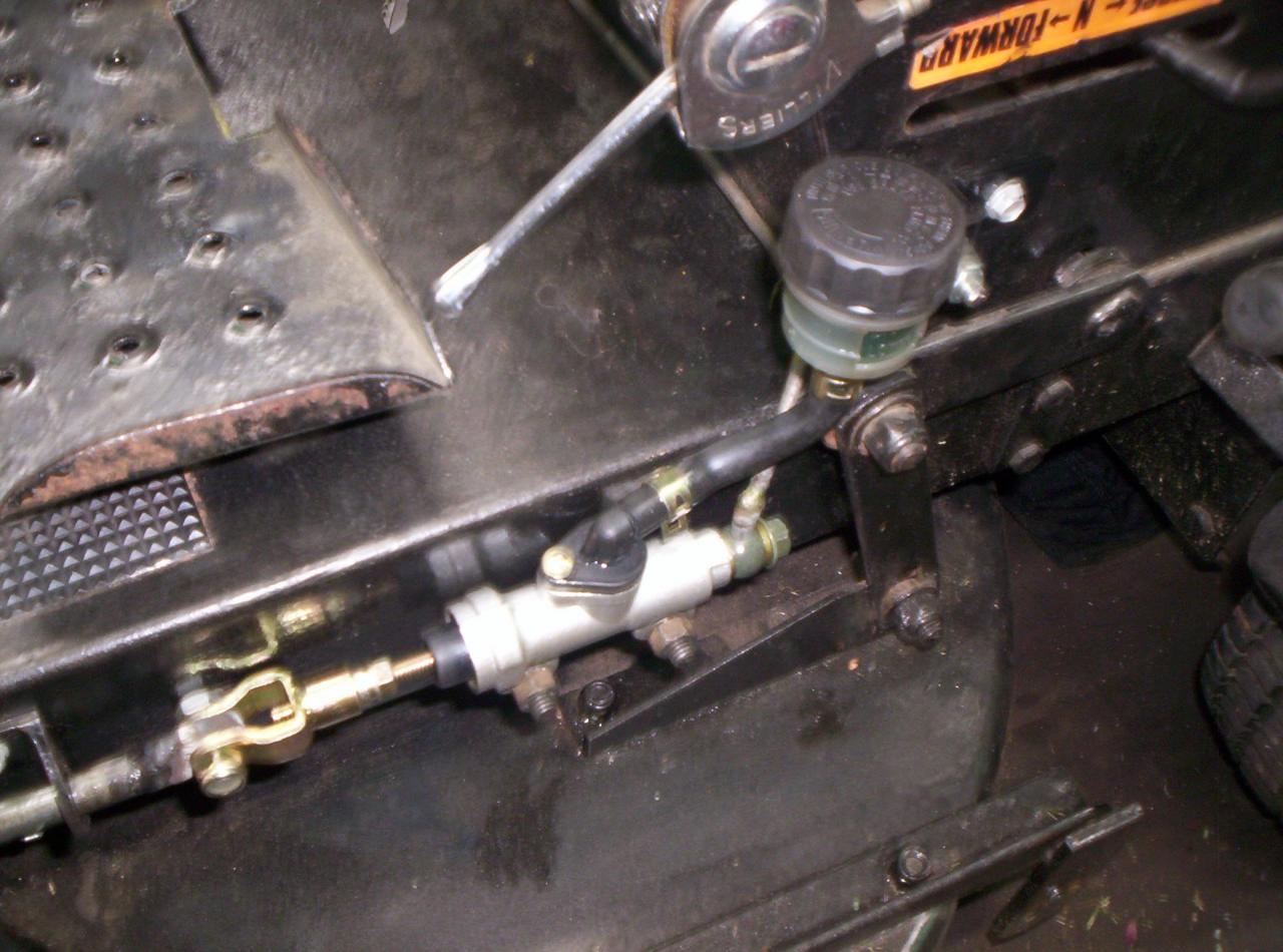

Ok so I have the disc brake fitted and now I have to bleed it and because I had to make up the brake line in solid tube I am going to have to tip the mower on its side to get the bleeder high enough. I will drain the oil and petrol out first, any other thing I might need to do, Battery is a sealed unit so no prob there

Slash, I'll see what I can do about the pics, it is so tight in there, I have probably spent over 30 hours fitting it and I still haven't got all the air completely out, I'm going to have to tip it completely upside down to get the last bit out. This is all because the only place I could fit it in the end put the bleeder right on the bottom and I'm not sure how I could make up a flexible hose so I could remove the caliper and turn it upside down to bleed it. I ended up getting a new disc/caliper and master cylinder kit for an ATV for $50

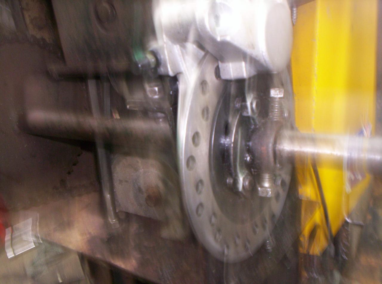

Bit blurred but you get the idea

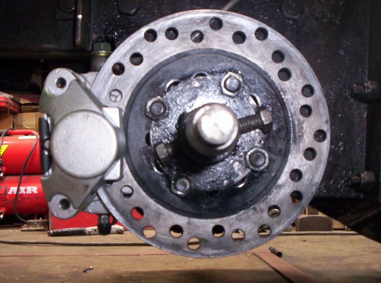

Looks like a bit of heartache there Norm but you've ended up with a well executed job. Does the disc mount to the back of the hub by the wheel studs? Now you've done the R&D the next one will be a piece of cake.

Slash I had to make up the hub, the disc just had a 50mm hole in it and with my little lathe and tools it takes a bit of time. So many little bits have to be made to make things work that all take time to work out and then make. Problem is no two are the same so if doing another one the R&D has to be done all again. How does it work, certainly locks the shaft up, haven't quite finished it but a road test should happen later today
